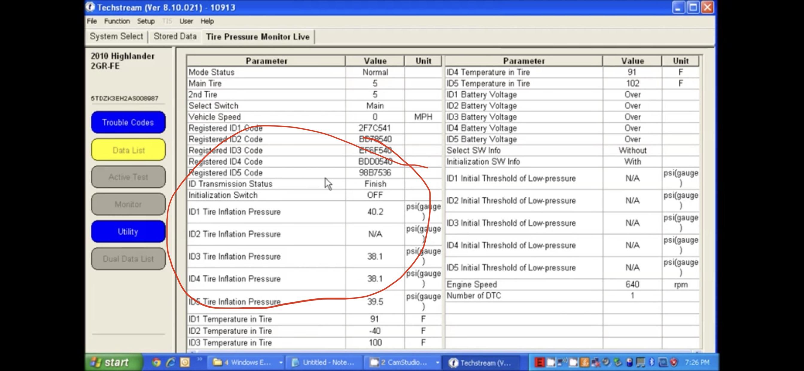

Id1 thru id5. It can handle up to 5 tpms. Just need to program it. Limiteds come with 5 from the factory.

My 2013 Trail has 5 slots available but you can only have 4 sensors programmed. Starting with the 2015 or 2016 Limited, 5 sensors were standard. All other trim levels only have 4 as I understand it.
How stupid is this? Don't put a sensor in the wheel that's the hardest to access and see. Model shouldn't make any difference. TPMS values should be displayed without having an external computer and software connected. Come on Toyota, even Chevy vans have easy to read TPMS!
I believe the tpms in all 5th gens are the same. Just saying the capability is there, but whether or not it’s used is another issue.
