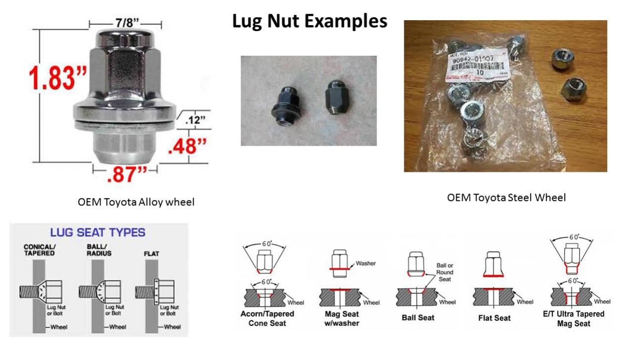

In an attempt to keep folks wheels bolted on, I assembled various images from the web concerning Lug nut seat types for alloy and steel wheels.
I use ET tuner type lugs for my Method alloys. I carry a set of Toyota alloy wheel lugs for use with my OEM Toyota Alloy spare.
.....and of course check the torque on your lug nuts.
Torque for steel vs. alloy wheel are quite different. :wacko:

You mention that there are different torque values for steel and alloy wheels but you didn't mention those torque values for those that could use that info!
I suggest looking in the owners manual.
I was hoping to leave that up to maybe, you? :wave:
I got some of those special long lugs from Discount when they mounted my SCS Ray10's, so I haven't a clue what the torque spec is since there's no manual I was given or even what kind of lugs they are. I guess I'll go fishing through receipts. hah
