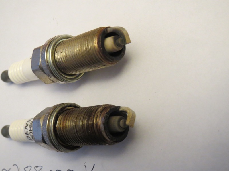

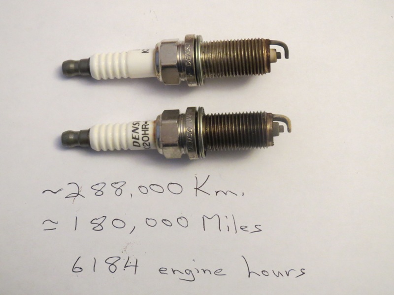

I just did the 288,000 Km (180,000 mile) service and found the following. Five of the 6 used spark plugs were dry, brown and “normal” (top plug in pics.) The #6 cylinder plug was wet and dark right back to the crush washer. The center electrode was ash coloured and grey instead of normal “white”. This is different than at the last service interval (240,000 Km.)
I also had to add ½ L (~ ½ quart) of coolant to get back up to the marked line. I’ve never had to add coolant between service intervals (except when the rad was going out; that’s why I’m anal about the indicator level.) The existing coolant still looks good and pink.
The used oil was also “normal” and not milky.
Need your opinions. Do I have a pending head gasket issue?
I'll preface this by saying that based on the information you provided here, it seems like it's probably your head gasket. I say that because in addition to the fouled plug, you've experienced the rough idle that's always described in conjunction with this issue as well as coolant loss. Your oil wasn't milky, but the other symptoms don't inspire much confidence.

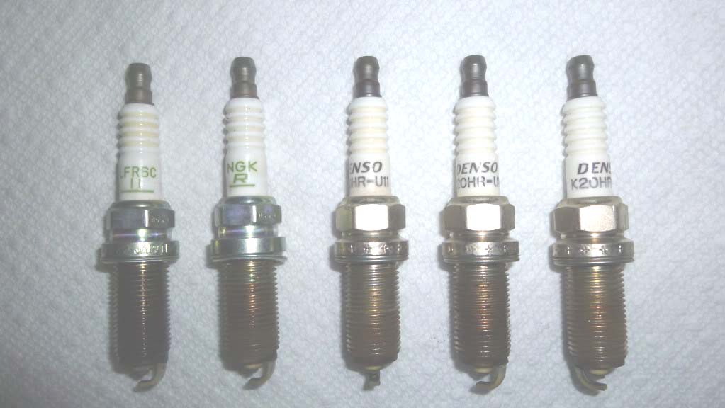

With that being said, when I changed the plugs in my '06 V6 at the 90,000 mile mark, they looked similar. I also noticed when I changed them that they were half NGK, half Denso, so they were factory originals. Anyway, I'm posting the picture I took at the time (even though it's pretty much too dark to see details):
SparkPlugsandOtherStuff045.jpg~original
Again, I know that picture sucks, but the plug on the left came out of my #6 cylinder, and it was noticeably darker and looked like it was wet, even though it wasn't. Looking at the electrode, it looks like it could be a gray similar to yours, although that could just be the lousy lighting.
Mine's still running like a top at 122k, but you're well past that mileage.
I'll preface this by saying that based on the information you provided here, it seems like it's probably your head gasket...
... when I changed the plugs in my '06 V6 at the 90,000 mile mark, they looked similar.

So those plugs have 90K on them? (I might have to lengthen out from the recommended 30K interval.) I think you are right about the left most plug looking similar. I do have recent coolant use, however minor. I'm thinking it's early in the process so I'll monitor it. Maybe I'm just paranoid.

Rough idle after sitting on a 04 v6 is a symptom of a bad head gasket. The coolant leaks into a cylinder(#6 most of the time) and the burning off at startup is where the rough idle is coming from. Hope this is not the case for you. Do you see coolant loss? Let it sit for a day or two and pull #6 plug and look for coolant.
Just had this fixed on my 05 I had all of the same exact symptoms. Its sneaky and I only popped a misfire code once. But turned out to be a headgasket. I would take it somewhere they can put a scope in it to check it out
Like others have said. Sounds like HG is blown. You can do a leak down in the suspected cylinder but open your radiator cap and make sure it's topped off. Once you get air I'm the cylinder. I set it around 80-100psi. If it's the HG. Your will see the water start to rise. Done this test before and works really good.

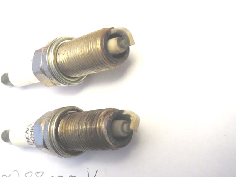

I tried to add some light to the plugs using Photoshop.
