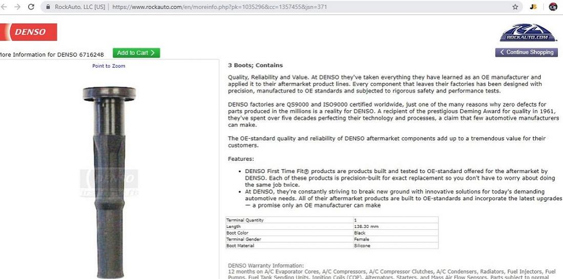

Other than plugs and wires....coil boots will do that. People overlook them and don't replace when replacing the spark plug wires. They think you gotta replace the coil which very rarely if ever will go bad, either they work or they don't.
Pop off the coils, I'm thinking the boots are heat cracked. To check them, squeeze the bottom where it slides over the spark plug and it will probably have cracks in the rubber. You can buy a set of the 3 Denso coil boots for $37 from Rock Auto. Part #6716248. You'll surely use them anyway so you might as well buy them.
These things are super easy to swap out, takes like 20 minutes and a think just a 10mm socket.
