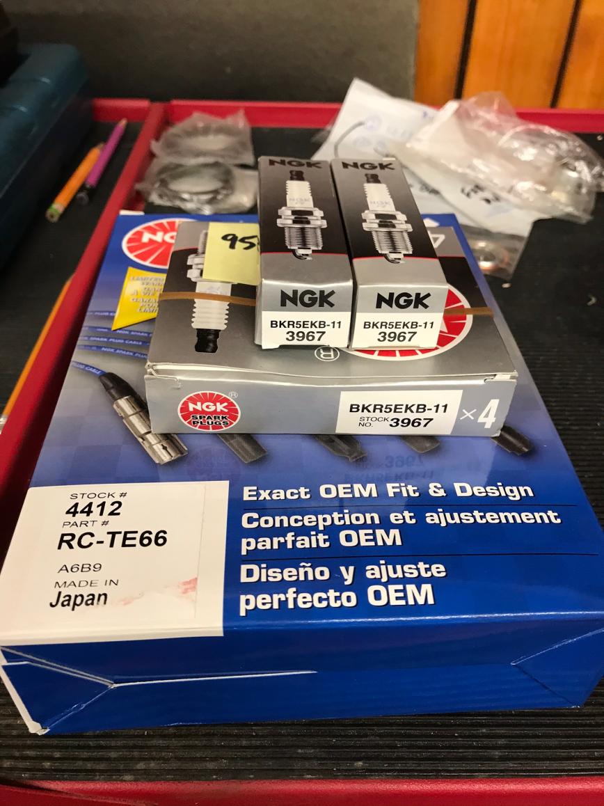

Finishing up on valve cover gasket replacement and put a set of NGK plugs and wires in while it’s all open and easy.
