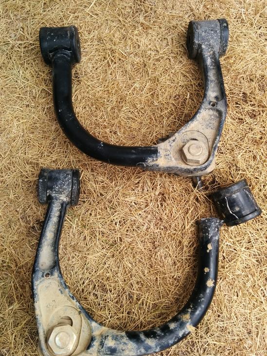

This is a set from a friends Tacoma up in Colorado this past summer. His were the old 4 washer per arm design. We called up SPC at 5pm that day and they over nighted a brand new set to our camp for free, We had them on by noon. On my 04 I have the newest revision and did the same trails with no problem and still none over 5000 miles later. I'm keeping an eye on them just to be sure but so far nothing to complain about, and since he has received the newest revision he is the same way. Now I do plan to goto a uniball in the future just for the added travel but not because of any issues experienced but YMMV.
