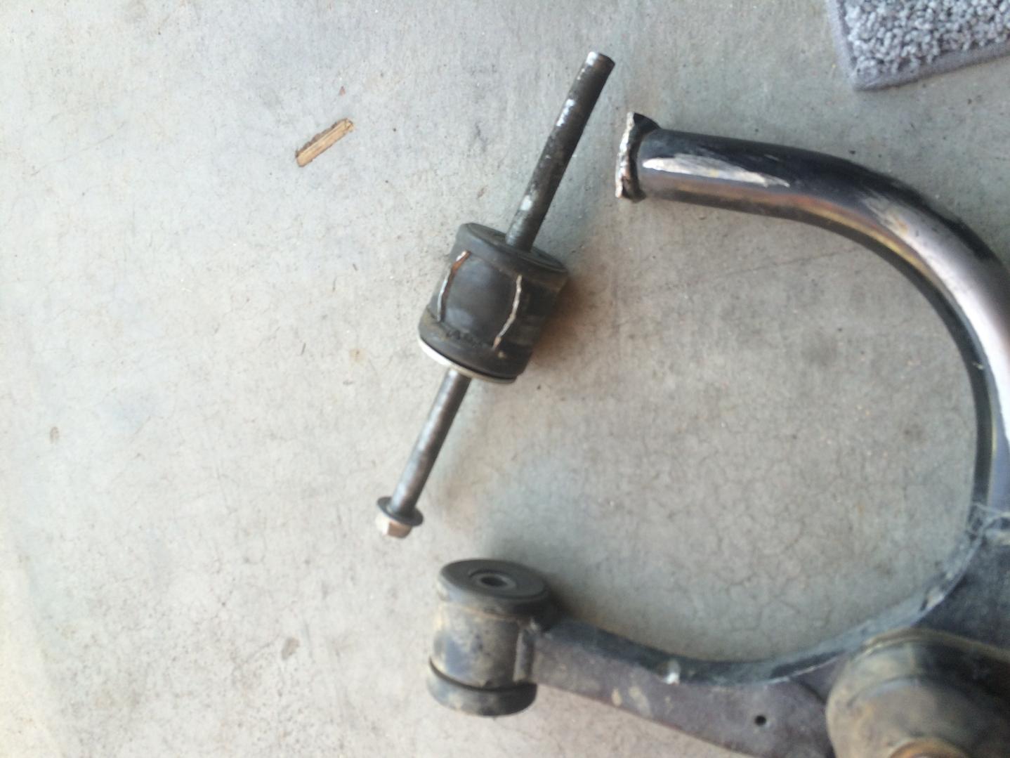

I asked spc if they would at least cover the cost of the torn icon shock cover but they refused oh well I had to ask
Yeah it definitely looks like there was a welding issue with their earlier units, the one I saw in person was pretty mangled. But you could see that there might have been an issue with the heat affected zone (too cold?) The new design seemed to have better looking weld, but time will tell. I'd be interested if they ever send you that recall, I wouldn't be surprised if their older units had an issue in manufacturing from the similarities in failures.

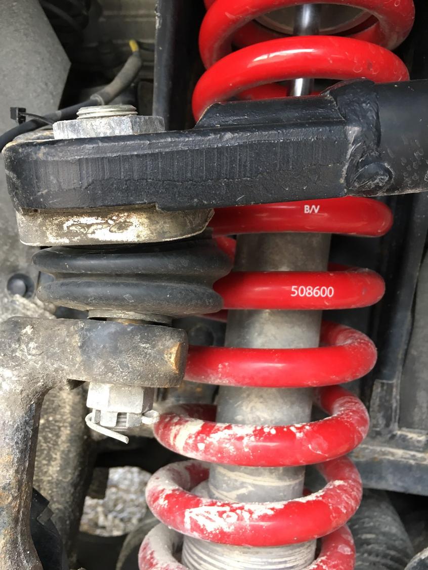

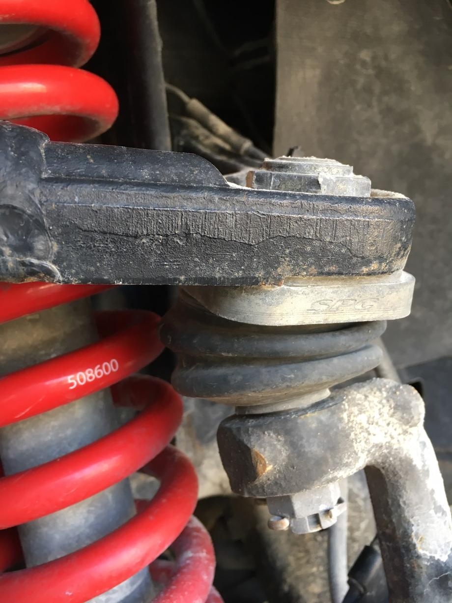

Pretty old thread, but has anyone seen this issue? Mine are just over 2 years old and ~12k miles on them. Zero off road miles. I was rotating my tires today and noticed both sides appear to be cracked...
Looks like a 'grinding' mark to me. You sure it is a crack?
...and to the fail, these SPC UCA have had a couple different bushing set-ups over the years.
The inner bushing was basically locked in place, so any suspension flex is then coming from the welded area of the joint till it fails.
The newer version is supposed to fix the problem.

Doesn't look cracked to me either. Looks like the difference in texture between a cast and a ground area. Loading wouldn't make any sense to make a crack run around jagged around the middle of that part of the arm either.
You do have the outdated upper ball joint though, so if you get any knocking in those there's a greasable option. Yours look very clean though for their mileage.
Yeah, I emailed them and we both came to the conclusion it was casting. If it was a crack... they both would have surely failed already. No issues with the ball joints yet, I know they're the old style so I've kept an eye on them.
yeah, I'm happy with mine... I guess I never really looked or I would have seen that casting mark 2 years ago when I installed them.
