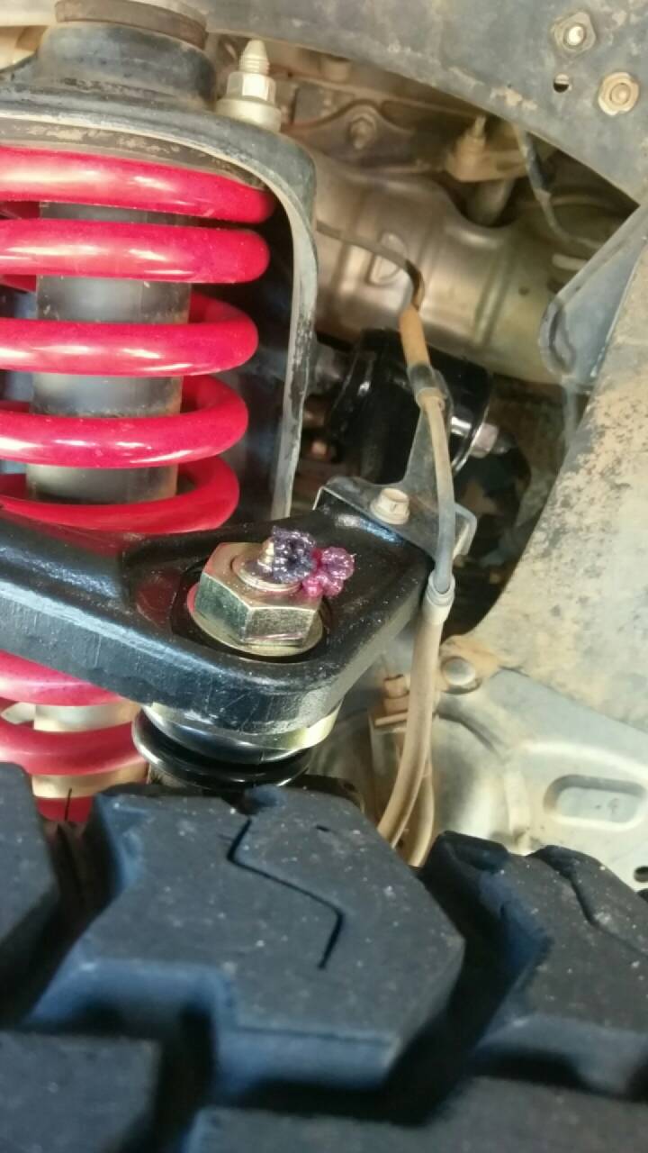

So I just got these UCAs installed at a local shop due to lack of time and noticed a large amount of lube (I think) coming out of the top of the drivers side. A week later the brand new UCA is creaking and loudly popping on a full left turn just like my old stock UCA, do I need to take this up with the shop, SPC, or just live with it?

Sure it was your old UCA making that noise?
Sounds more like LCA adjustment bolts that aren't tight enough to me...

Hmm I hadn't thought of that, I'll have to check tomorrow, thank you for the quick reply! [MENTION=65614]Antman[/MENTION]

I have the same UCAs, the lube coming out is most likely due to being overfilled. In regards to the clicking/noises, double check bolts but other than that I had the same exact issue so I greased the joint (why Im aware of the overflow) and after a hundred miles or so I no longer have any noises coming from my driver front.
Hope this helps
