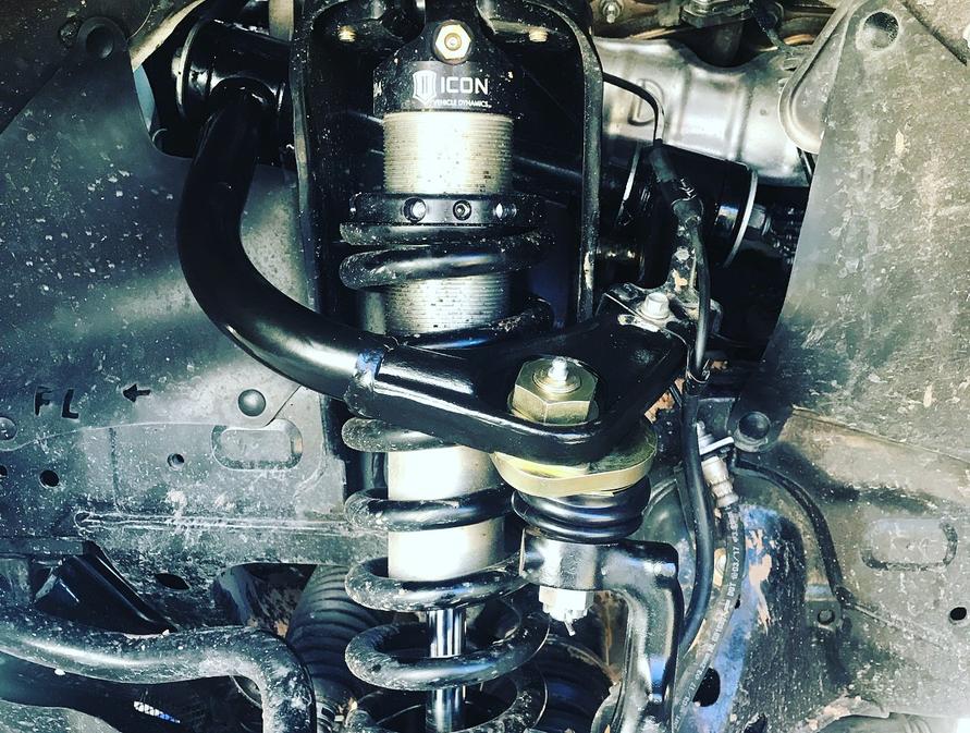

I did a search and didn’t find anything...I installed them today. I replaced the tuff country UCAs because it was binding on the coil at droop.
First impression is very satisfying, the full adjustability of caster and camber is fricking awesome. The bushing are a non serviceable (after install) “spec ride” at the mount and an 40* angle max for the ball joint. The entire front end just feels tightened up and it’s tracks better. One thing I noticed when the tuff country UCAs came out, the sleeves just fell out of the bushings and there was actual play between the bushing and sleeve. I was able to set the adjustments on the Lca cam bolt to 0 and made a 3* adjustment on the UCA, no rubbing and set the camber to -1* . Feels great
There are many people running these, myself included. SPC has made at least three changes to the bushing design over the years and the latest, which you have, appear to have resolved the early problems.
I've had them since early 2012 and have gone through all of the bushing issues including the dreaded catastrophic failure, but all is well with the latest design. I carry a spare ball joint in my recovery box. As your photo shows, the latest design has a grease fitting for the ball joint.
There has been much written about the superiority of uniballs, but I'll stick with what works. 70K miles and the ball joints are as tight as new.
Yes sir! I get the 40* with these ball joints each way. When The extended coilover is all the way out the joint on these still have travel in its seat. There no reason to run Uni-Ball IMO. Like you I will be having a spare set of ball joints in the bag

I run the SPC's on my 4th gen and so far they've been great. I've got almost 100k on them and just had to replace the ball joints earlier this summer. I'd definitely buy again.
