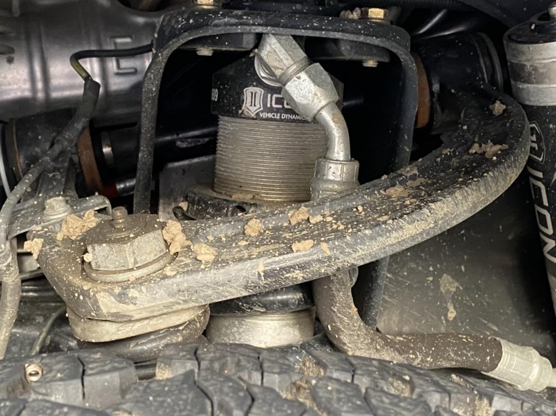

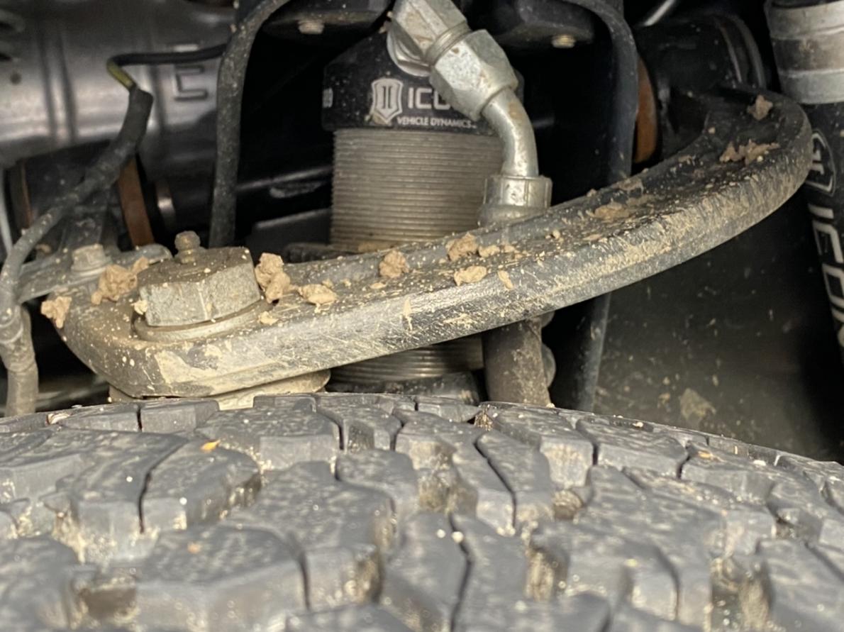

If they're the older two piece SPC UCAs, those were prone to breaking so I'd replace them.
I think these are later than those, but I'm not exactly sure. Like I said, they were on it when I bought it years ago.
Here's a couple picks:shrug:
Those are the old style, you can see they are two pieces welded together and prone to catastrophic breakage. I threw them out and replaced them with the new style. They are filthy but you can see if they are designed completely different.
