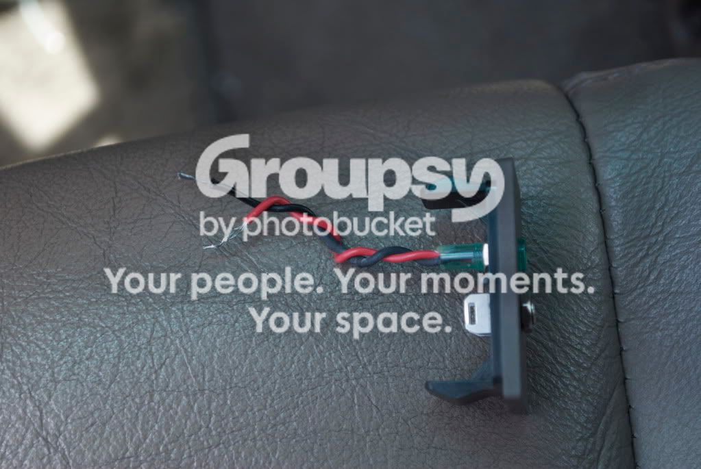

Okay here is the pictures and parts you need.
DSC_0007-2.jpg~original

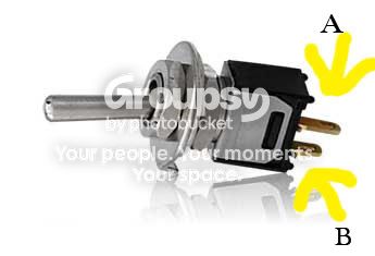

This is the switch I used, you could use anything you wanted, I picked this one because it was small and easy. In my picture the flippy part of the switch was missing, I snapped it off with my knee on accident :bash: I upgraded to this switch and havn't had any problems:D
Radio Shack P/N 275-624
I also added an LED that turns on when the amp is on. It isn't really needed because it is pretty obvious when the subs are on but I added it anyway. There is a red or green LED.
Green Radio Shack PN 276-271
Red Radio Shack PN 276-270
If you don't add an LED just cut your remote turn on lead (the small single wire that comes from the head unit, it's probably blue) and connect the side coming from the head unit to lead A on the switch, connect the other to side B. The best way to connect the would be to solder but you could use crimp connectors or worst case just wrap the wires around the leads.
pRS1C-2160412w345.jpg~original

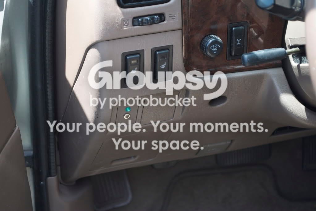

If you want the LED connect the lead coming from the head unit to Pin A on the switch. Connect the red lead from the LED and the other half of the Amp turn on lead together to pin B. Connect the black lead of the LED to Ground.
DSC_0008-2.jpg~original
As for the holes they are 1/4 for the switch and 5mm for the LED I think I used 1/4 for both...
