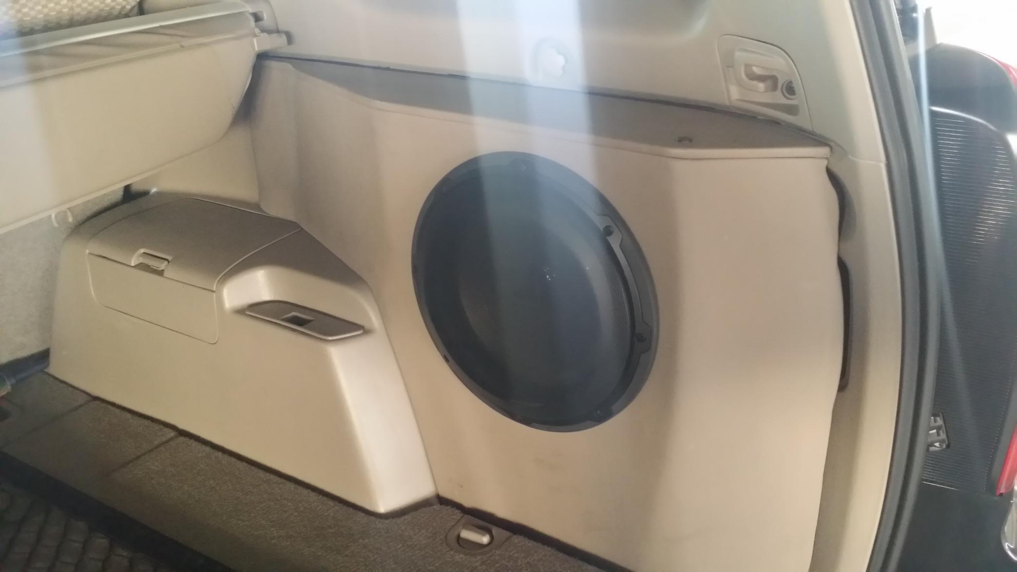

The oem box is OK, it isn't the most ideal tuned box, but it sure as heck makes things seem more stock and gets things out of the way. I did have issues with rattling, so I'm not running a panel right now, until I can hack up my new one, dynamat it, and modify it to work with the sub. It sounds great without the panel though. My install looks so clean, a tech at NTB was praising Toyota for using such quality parts as JL in their systems. I had to explain to him that it was all done by me and not Toyota. :doh:
Looks and sounds great though

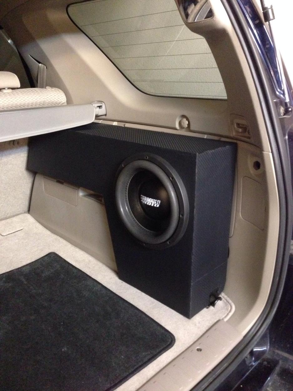

Just put in a new 10 inch sub on the side myself. I had a 12 inch in a box in the middle, but it takes up to much space. The new sundown SA-10 is louder and sounds better than my kicker 12 in a box over 3 times the size.
