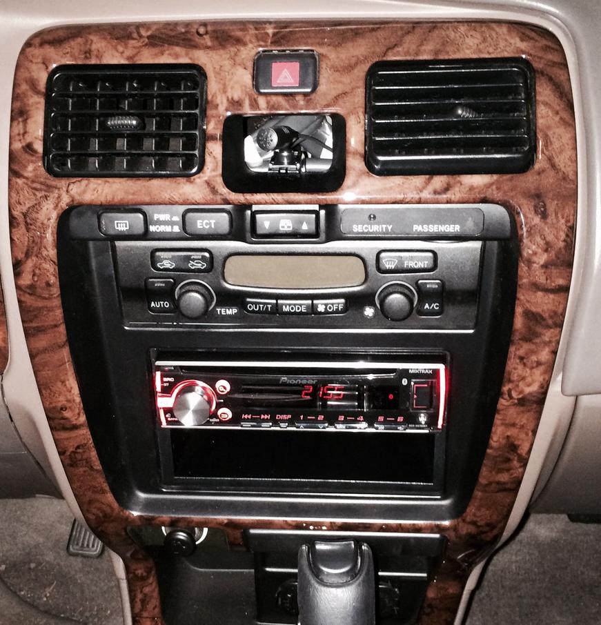

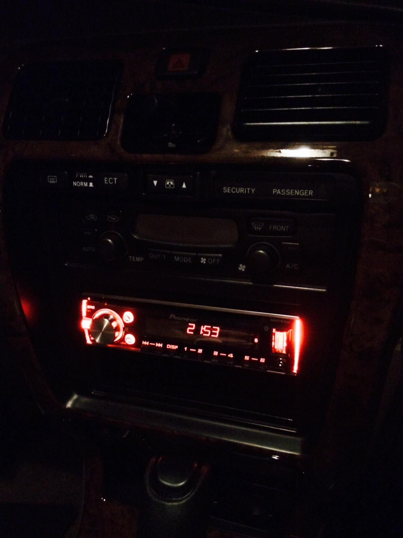

Here's a couple of crappy shots of the finished install. I can take a better one tomorrow.
J

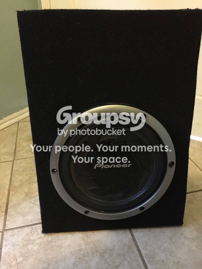

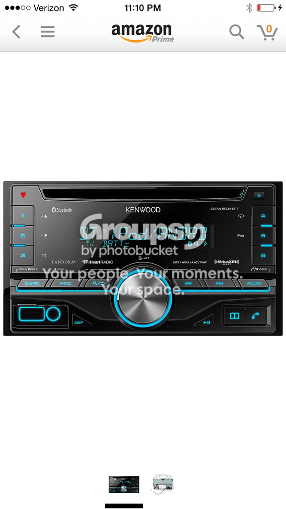

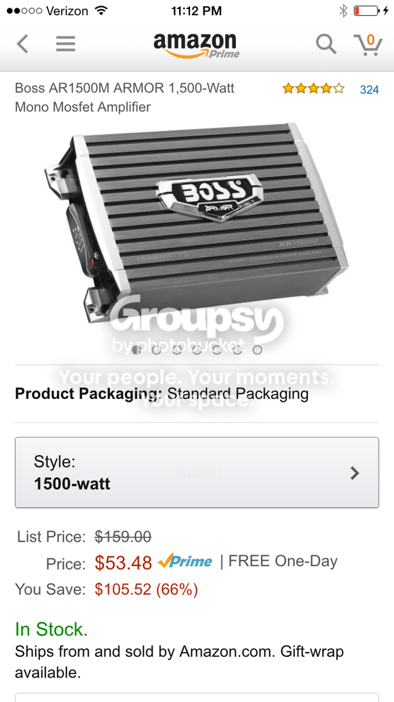

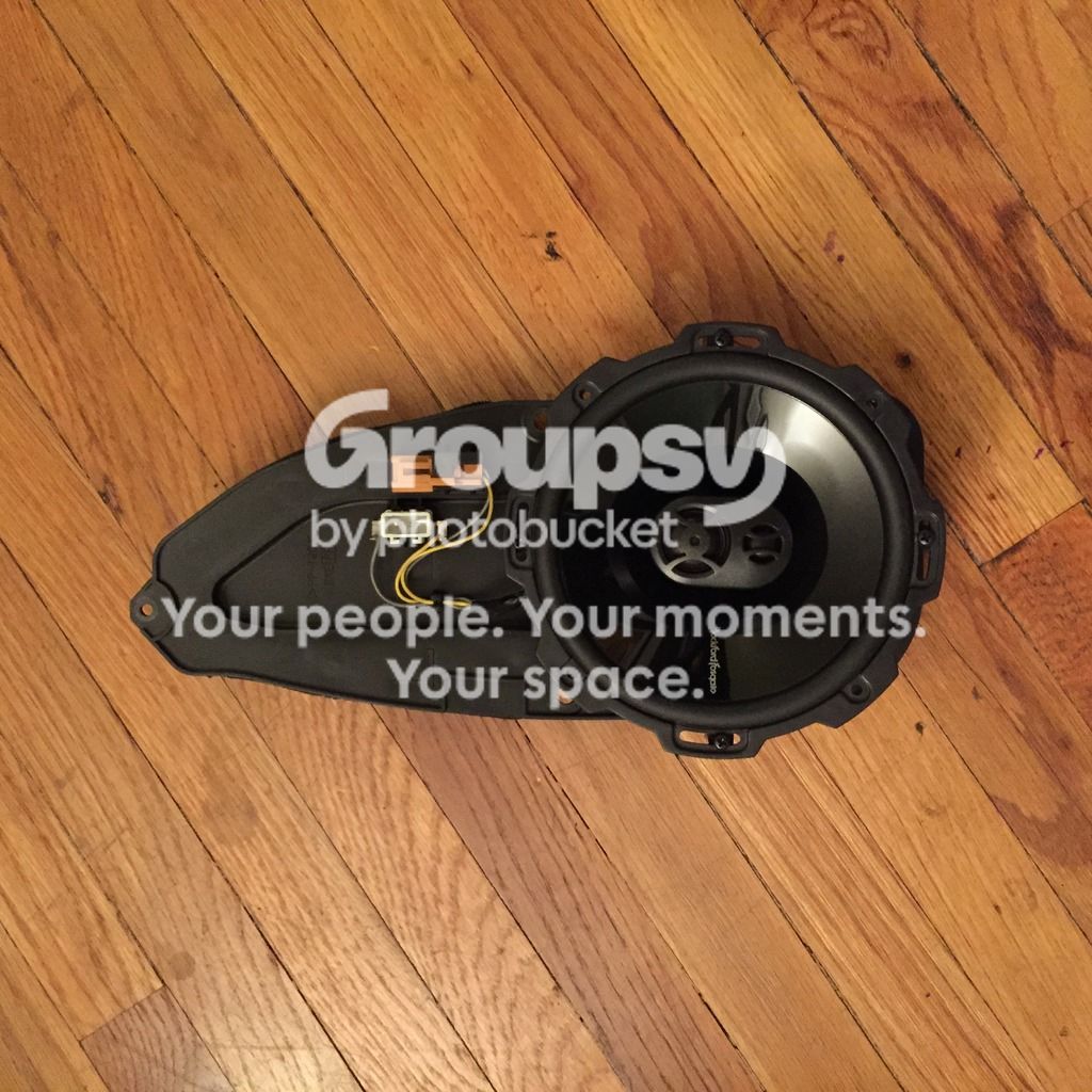

I'm a cheap arse but research. My system is loud and does not distort until your ears bleed. I bought Rockford Fosgate punch 6.75in for front and prime 5.25in for back. I used existing mounts and wires just gutted old speakers out and modded a little. I then decided to buy a kenwood headunit. I used my pioneer 10" sub out of my Tacoma which I'm selling and the boss 1500w amp. No amp running speakers. It's loud and has great sound. I spent about $200 minus the sub and amp I already had.
Sub I built specifically for doublecab Tacoma
This amp has outlasted many nicer amps
