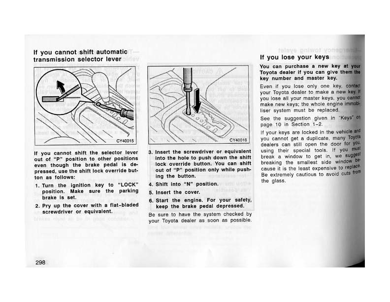

1] What is the 13mm x 13mm door, or port, just north of the PARK position on the shifter plate?

1.) No answer....yet.

1. this is a cover to manually over ride the shift lockout

13mm x 13mm port
Someone already mentioned, it's a manual override for the shifter lockout. Here's from the Manual for a 2003 V6.
Funny, but I don't happen to carry a small screwdriver with me, so their method would leave me begging for something that might work.:eek: " Excuse me sir, do you have a small screwdriver I can borrow, I need to steal my truck"

And Toolman, I do carry a small screwdriver. And a big screwdriver, and wrenches, hammer, tie-wraps & duct tape, But then I 've been in Jeeps since '93....
