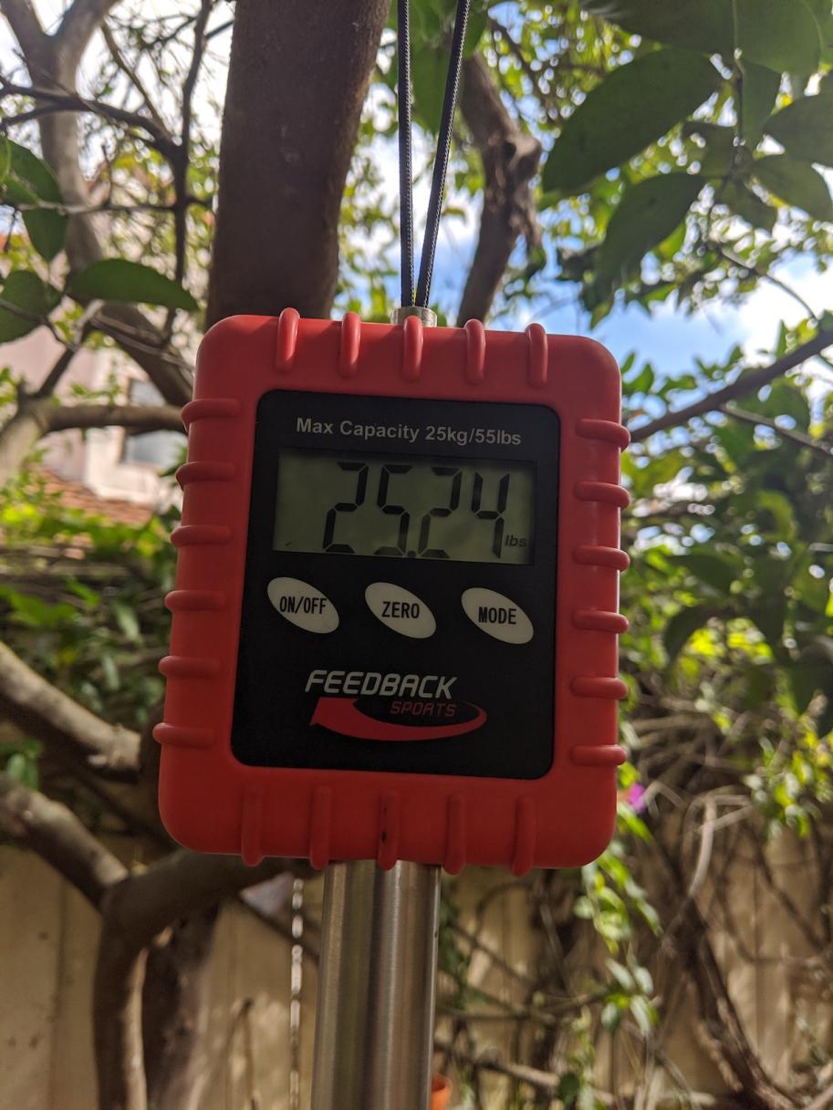

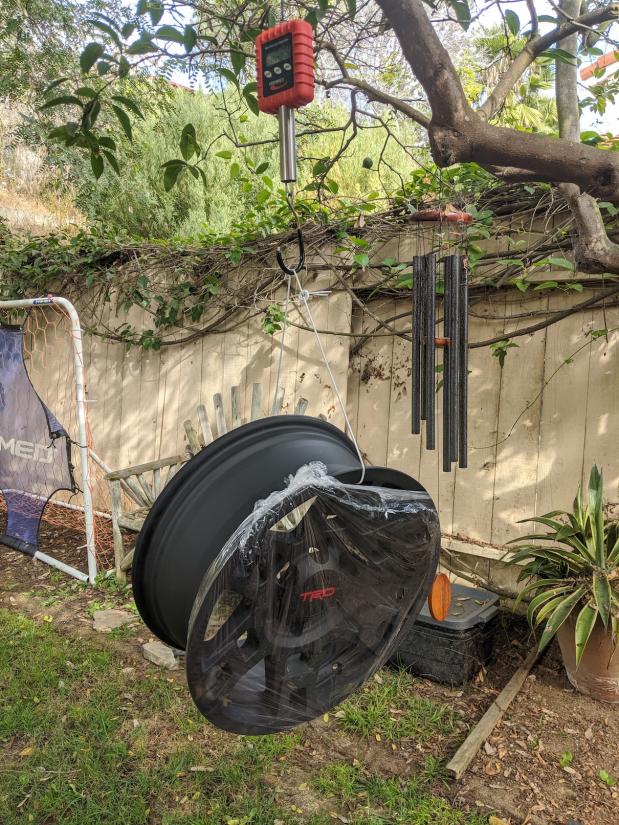

Not sure if you mean ORP wheels or the actual pro wheels but I measured 25.24 lbs for the first gen pro wheels.

I meant the OffRoadPremium 17x7.5 alloys, not the TRD wheels you show there. Great to have that data point. I have a set of take-off ORP alloys on my Limited and am looking for something different & lighter. Wondering if the fact the Pro wheels are "flow formed" gains a bigger weight advantage.

the ORP wheels are 31 lbs. 1st gen pro wheels are 25lbs but they are also .5" skinnier. Not sure if anyone has weighed the new ones, but I don't see much improvement in weight as flow formed is still basically a cast wheel that they heat and stretch. If you want more weight savings you would need to get TE37's or something similar. TBH, once you put a heavy tire on it, any weight savings on a truck is pretty much a null point and negligible difference at best. I wouldn't spend money on wheels purely for weight savings.
