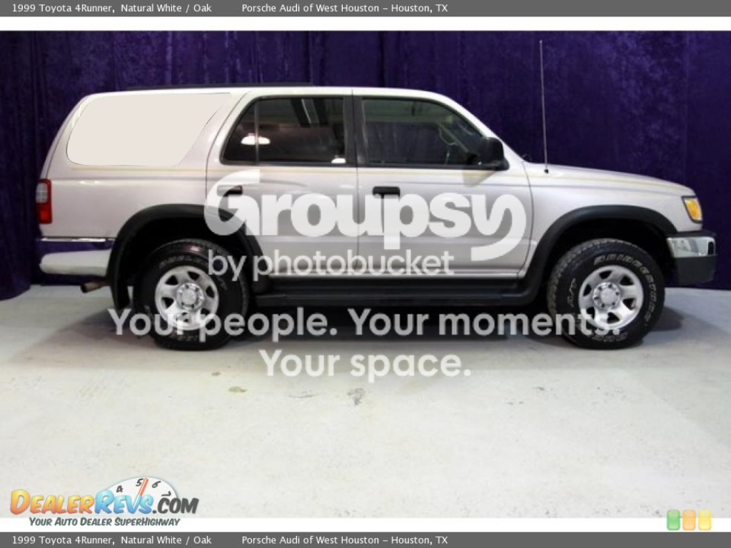

Following that logic my current crazy idea for my 4Runner is to remove the rearmost windows and close them up like a panel truck. On the inside, use that space for additional storage. Removing automotive glass is (or maybe just was) super easy, I have no use for an AM antenna (nor it seems does anyone/thing save the factory radio which is long gone), and those windows are unused as far as visibility is concerned (save my dog, he uses them a little). As far as I'm concerned, they're a waste of space, weight up high, and a liability on the trail (there seems to be a lot of threads about them being broken). The metal fab would be a cinch, body work minimal, and with single stage white paint (another intentional and utilitarian choice on my part), even the paint would be a snap.
I want to know if there's anyone out there that has already done this. If so, what were the hangups and complications? How was the inside treated? Of course, photos would be nice as well.
Here's a 30-second photo:

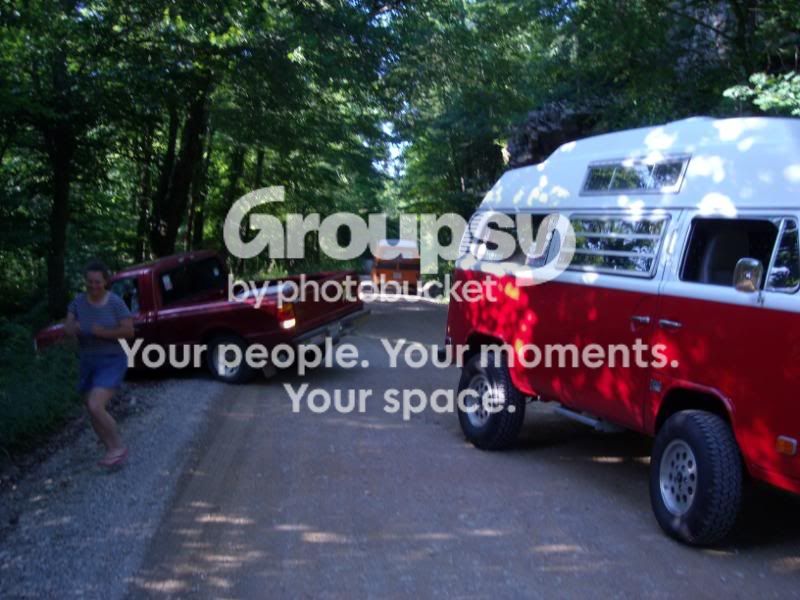

My bus looked very much like the first. I had the Goodyear All Terrains, same general vintage (they didn't change much aesthetically, but that's the right range), roof rack, etc. There was a guy in my car club back in Dallas that used to have a single cab pickup bus on 40" tires called "Bugfoot".

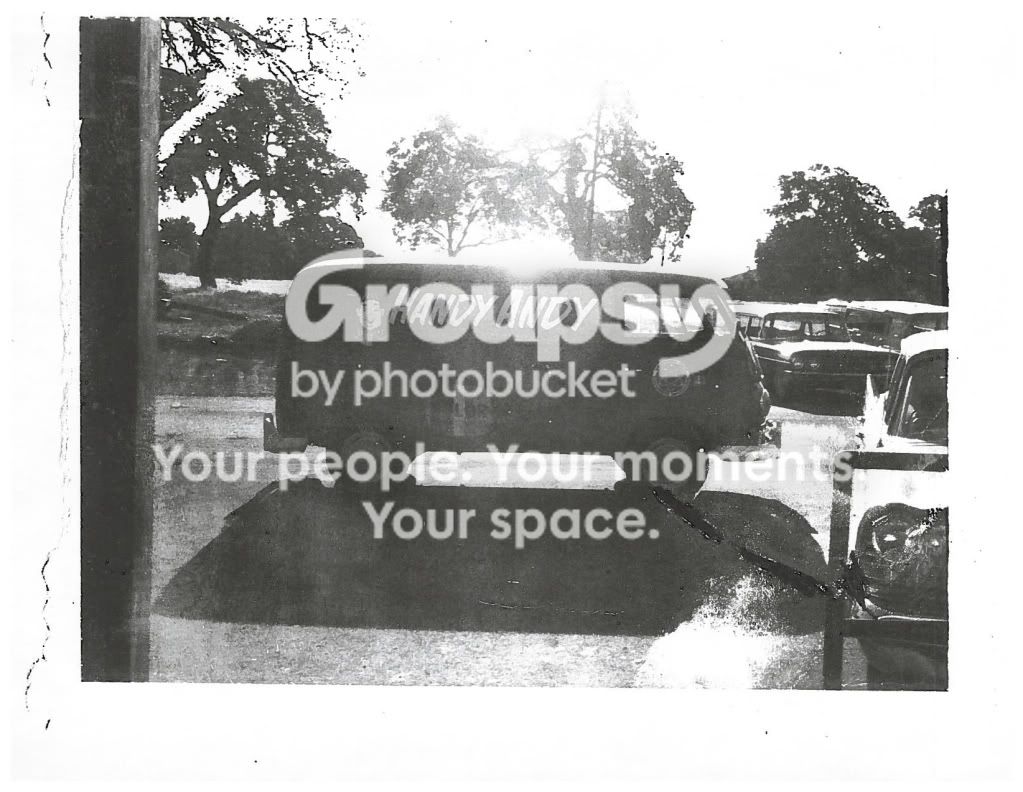

59side1.jpg~original
This is a '59 from the same fleet of 5 (2 '59s and 3 '62s). I miss my bus a little if you can't tell...

That would be what I consider the "right way". Cut it to where it's the same contour as the rest of that panel (however far out that is), and weld in a patch to fit. Ideally there would be enough space from the inside (and a helper) to hammer things flush to mitigate the need for filler, and filler would probably be the old lead variety (I don't care much for the plastic fillers personally, and they've got lead filler that's a slightly less toxic alloy now). The single stage Natural White paint will make painting it up clean a snap to boot!
I was thinking about what would make for a good interior filler, and I'm thinking the big relatively flat panel is going to require some reinforcement to keep wind buffeting and/or oil canning from being an issue. I think this can be handled by a simple and inexpensive strip or two of small angle iron (not sure how small it comes, but probably the smallest I can find). Fill in the newly opened window cavity with some plain sheet metal, and put some expanded steel over the new panel just a hair out (probably the thickness of the angle iron) to give it some depth and to make for modular storage options. The expanded steel would allow for the use of hooks, modular shelves, bungee cords, etc. to keep things in their places.
The part I haven't figured out is exactly how to handle the plastic interior panel... It's going to need to be cut somehow for sure, and if I want to be able to enclose the new storage areas, I'm going to have to find some means of trimming the plastic while allowing doors to open and close. I might be able to get away with some creative hinges and some sort of tubing cut lengthwise and fitted over the cut edge of the paneling plastic... That's the best I've been able to come up with so far though...
Exactly how to arrange the doors for the storage areas is also TBD. Two doors opening from the center? One large door? Hinges front/rear/top/bottom? Do they need to be opened more from the cab or from the rear hatch? Maybe just leave them open?
