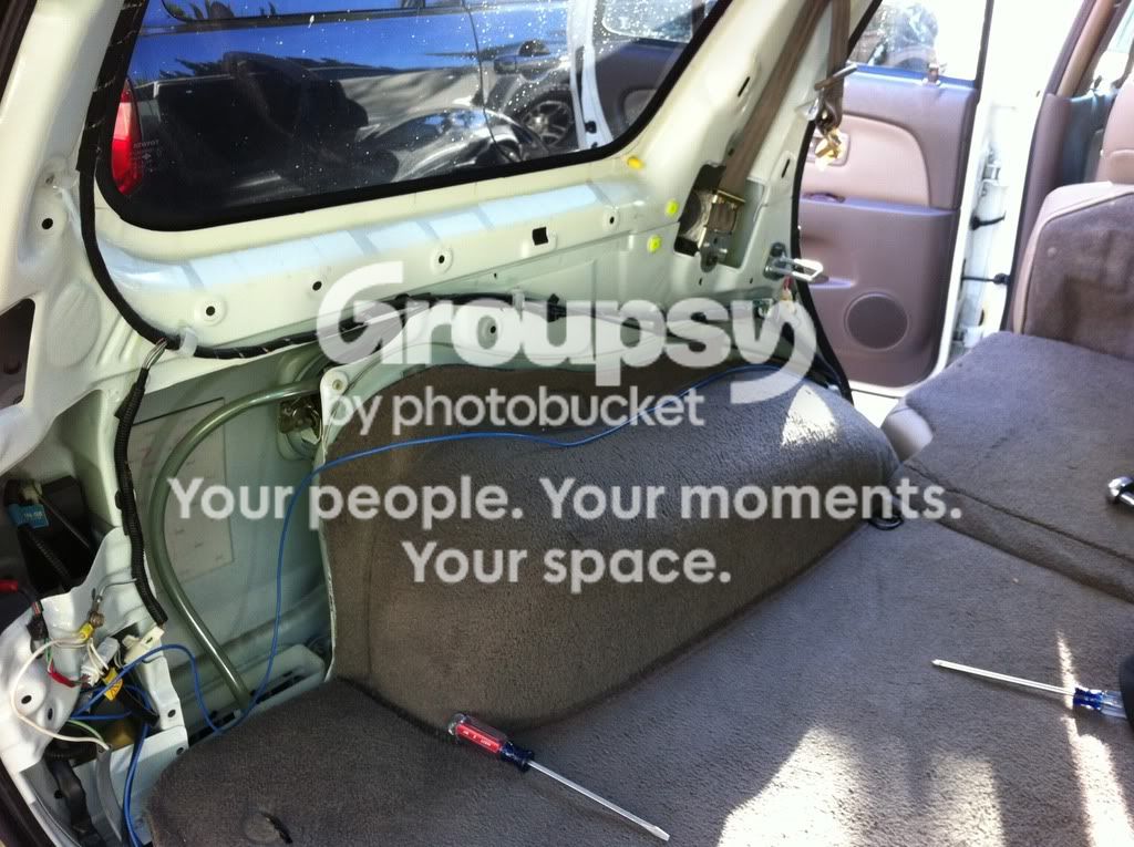

I started removing interior this evening after work. I drive my 4Runner daily, so I can't get too deep unless I can follow through (which I don't have the ability to at the moment unless I were to pay a shop to do it). This is not mine, but a little reference for the project.

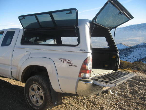

I think if you do this you should make your panels so they could fold out like on some truck shells. Instead of it being a window that folds up, it would be a solid piece of metal/ fiberglass/ or whatever. Then it would be like a 3rd gen with a shell. You'd have access to cargo via the side fold up panels, and still have a rear roll down window.
Make it similar to this idea:
now THIS idea I like!!!:thumb3:

The glass isn't just replaced, the entire window frame will be cut out and a panel welded in to make the side of the truck from the passenger doors back smooth (like a panel truck). The inside will be finished off with storage space. Expanded steel backing will be utilized to make modular storage possible with some cabinet doors of some sort (still scheming on that bit) to keep things contained while driving/wheeling.
If you look at the photo above with the interior removed, it will essentially be cut (on the inside) from where it creases over toward the glass (just above the interior panel fastening holes), and on the outside from where it's flush to the side of the truck. The outside will have a panel made to match the curvature of the side (which is curved in both the X and Y directions, making it a bit of a job), and that panel will be reinforced with some angle iron or something (curvature again being a challenge). The gap between the interior part of the body and the exterior part will be capped (however makes the most sense). The newly formed cavity will be lined with the expanded steel to give the panel depth and structure. The expanded steel allows for the use of bungees, readily available shelving hardware, etc. for storage capacity while camping/sleeping in the truck. Again, think old VW camper buses; they were teeny tiny (same wheel base as a Beetle only an inch or so wider) but had cubic miles of storage space cleverly integrated all over the place.
