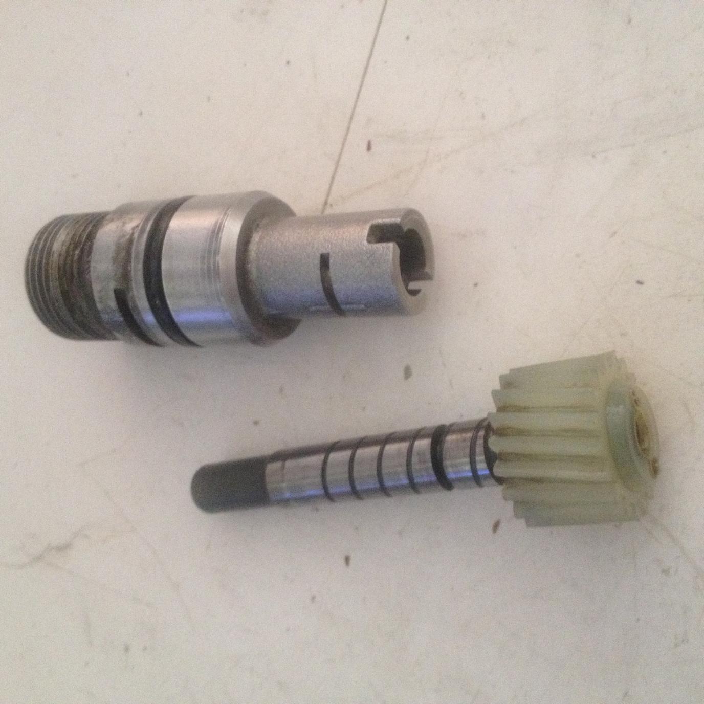

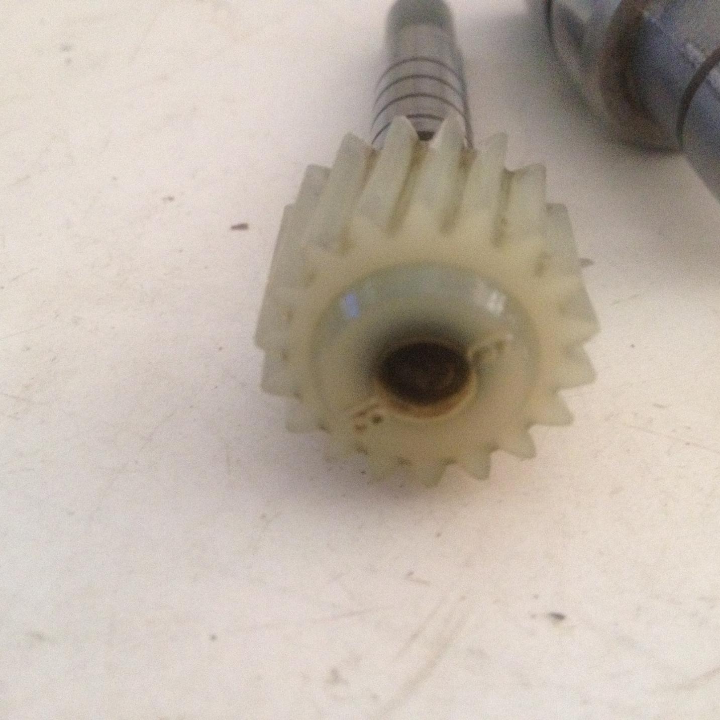

Gentlemen, I have a 87 4runner with a 22RE, 5speed. I recently changed the gearing and tires. I went from the stock size tires to 31's and no surprise my speedo is not accurate. Does anyone know where to buy different gears for the T/C. Its the nylon gear that is part of the assembly that slides in to the T/C and connects to the speedo cable. The stock gear has 18 teeth.
Thanks

Guess I'll pass this on, I was corrected a while back about parts being non-existent, thought of the link for this exact purpose!
Yota Yard - Parts
You'll need to give 'em a call and ask them for what they have, but I wouldn't be surprised if they had what you're looking for.
