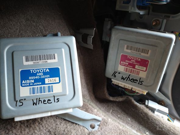

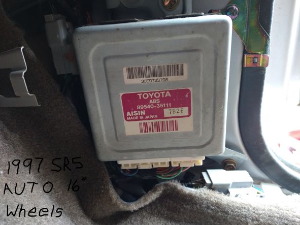

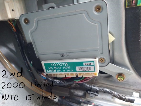

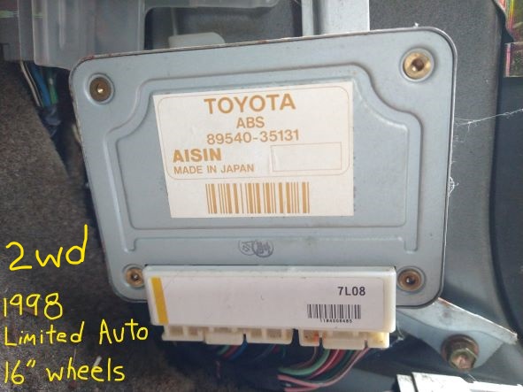

I made a trip to the salvage yard today to pick up a latch for the 4Runner lift gate and a few other items. While I was there, I took the opportunity to check the ABS modules in the three 3rd gen 4Runners that were in the yard. All three agreed with my previous observations in post #40. I took a couple photos.
I also realized the 4 character alpa/numeric code on the label or on the wire socket is actually a date code. This code agrees with the model year of the 4Runner. The first character is the year. The second character (letter) is the month. The last two digits are the day of the month.

I haven't seen green labels but they are green for a reason.
Maybe the red and brown are the 4x4 with 16 inch wheels and the blue and green are the 15 inch wheels?? [ just theorizing]
Or green the 4×2.
Toyota loves date codes and I noticed that number moved from the sticker to wire connector as well.

You are correct the green module was on a 2WD with 15" wheels.
phattyduck uploaded a photo of his green module in his 1999 SR5 2WD auto with 15" in post #42
The orange modules was on a 2WD with 16" wheels.
I updated the photos of the green and orange modules to show they are from a 2WD.
I have updated post #40 with all photos and applications of the part numbers/label colors. Re-reading it should answer your questions.

I have updated post #40 with the information needed to determine which ABS module is needed to correct your speedometer.
NOTE: This will only correct your speedometer when upgrading to the optional factory size 265/70/16 (30.6') tire.
