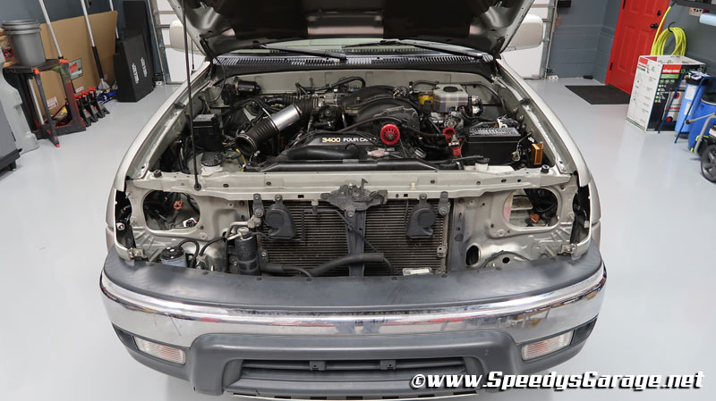

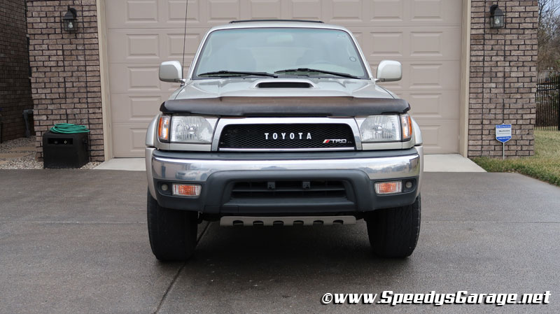

So I know you guys have been doing this for years, but I needed a project to work on. Either my 2002 4Runner's headlights were getting old and dim, or I'm getting old and my night vision is suffering, or I got spoiled by the HID projectors in my other cars, or all three, so I started looking in to aux lighting to assist and came across the HID projector retrofit as an option. Seemed like TRS (The Retrofit Source) had a bundled kit you could put together and customize as you wanted, so that's what I did. TRS gets a thumbs up from me, I actually got a person on the phone when I called to ask a question and they were very knowledgeable and gave me a tip or two as well.
It's an INVOLVED project, but not technically difficult, just time consuming. I highly recommend a set of aftermarket headlights to work on while you keep the factory ones in the vehicle so you can drive it.
Results were dramatic and some of the best bang for the buck money I've spent on the 4Runner, but Mrs. Speedy wasn't real thrilled about me cooking car parts in her oven LOL. I also updated the Satoshi grill while I was at it.
Here's how mine came out. Part 1 of the video on my install is published, I'll post up Part 2 this upcoming weekend and will come back and add it to this thread for those that like that kinda stuff.
I never get tired of tinkering on the o'l 4Runner.....I may do a new rearview mirror with temp/compass/backup camera next to continue the modernization process.

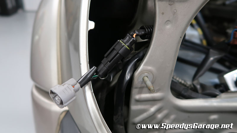

WeatherPak style connectors used for LED lighting. Cheap, easy, and durable.

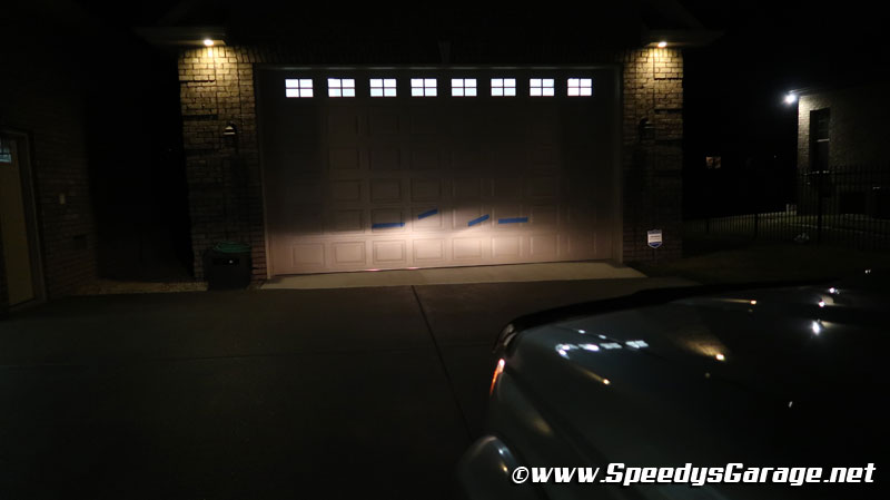

Before

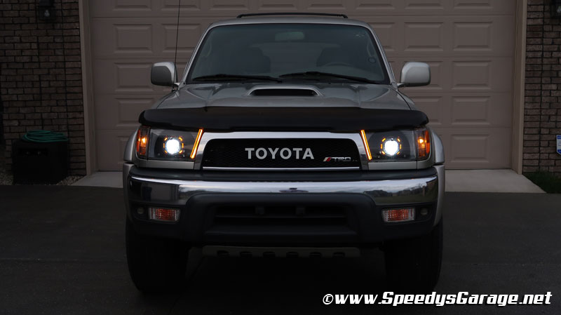

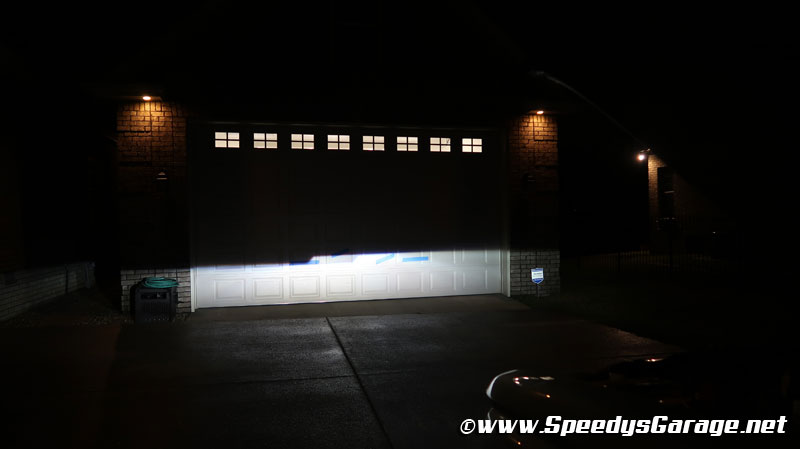

After

Thanks! I LOVE it. Looks bad ass and works 100x better than the factory headlights to boot.
It was actually a very fun project, but it is time consuming. I worked on it a little after work each night for about a week, then a full day on the weekend to finish it up. If I'd tried to do it all over a weekend I'd have gotten really burned out on it. Get to that point and you risk taking shortcuts just to get it done. Second set of headlights and markers FTW. Whole set cost less than $100 online.

Btw, what type of projector did you use for the retrofit?

Thanks, it's the Mini D2S 4.0 SIII (say that three times fast!). Real impressed with the light output.

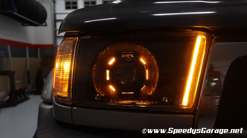

Can you post a link for where to buy that led strip you used in the headlight. Thanks.
And along with that, is that strip bright enough to work as a DRL?
I'm pondering LED strips in the filler panels to work as a DRL, but I'm also pondering an HID retrofit - it'd be nice to incorporate some DRL function into the retrofit, but I haven't seen a solution yet.
https://www.theretrofitsource.com/rgb-switchback/switchback-halos-strips-universal.html
I thought about this actually. Yes I think they're certainly bright enough to act as DRLs, however the DRL function on my 2002 is a 6V deal I believe, I was even surprised the HIDs worked as DRL on my ride. I have a switch as you saw in the vid and disabled my DRLs years ago, but having that LED as a DRL would be trick. It's a 12V input, however, so you'd have to somehow go from 6V -> 12V or cross check the DRLs on your ride to see if it's 12V. Make sense?
Thanks for the link. The Acme SMD LED strips look to be the closest to what I have installed on my bumper, just a different vendor. On another site I found an Amber only version for sale if anyone is looking for that.
The strip you used and the SMD LEDs are a bit different. I think the most visual difference is TRS's plasma style LEDs and Halos are a bit more yellow/orange vs the SMD LEDs being more burnt orange with no yellow at all. The SMD strip also has no weather protection, it's just an open circuit card. When I bought a similar type off eBay I had to protect it myself by using 2 coats PolyU bar sealer protectant and a coat of PolyU UV spray. So for the somewhat brave that is an option.
Thanks - yeah, I don't have DRL now, so no 6V source. I'm looking for something to tie into the 12V side that is always on when the car is running, and is bright enough to function as a DRL. So if the LED is bright enough (and I assume it's 12V), then I could use that without going to a separate light in the filler panels.
