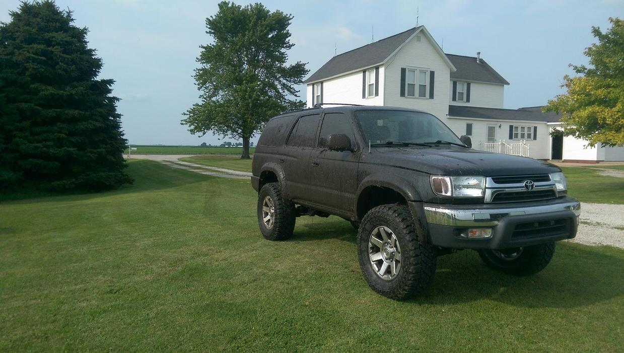

I'm looking into buying some spidertrax just need an idea what it looks like.
You might want to be more specific than that as different wheels have different backspacing. So not all wheels with spacers will look the same. Also, tire size plays a roll in this as well. Do you know what kind of wheels and size tires you're trying to get an idea of?
My wife surprised me with Procomp 51 series wheels 16x8 4.5 bs 0ffset so they rub on the caliper just a bit tires I'm using are Toyo open country at 265/75/16
This is what it will look like in terms of stance with 1.25" spacers and those wheels. I have different wheels but they have the same 16x8 with 4.5 bs.
I love the stability with the wide stance but be aware that you will have to do some trimming to prevent your tires from rubbing. You may be fine with the 265's, but with my 285's, I had to roll my rear fenders and do lots of hammering on the firewall in the front.

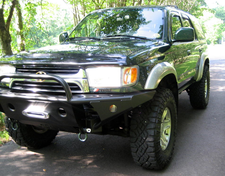

1.5 Spidertrax
I like your stance with the spidertrax. What size tires are you running. I want to push my wheels out a smidge to line up with limited fender flares. I'm running 265/75/16. I didn't want to go more than 1" spacer but yours looks real good!

The wheel spacers will make the rubbing worse unfortunately. The farther out the wheels are, the larger the arc they take when you steer and therefore will rub more. If its just the inner corner of the rubbing board, maybe you can trim it a little bit to eliminate the rub.
Mine are 285/75/16
Thank you.

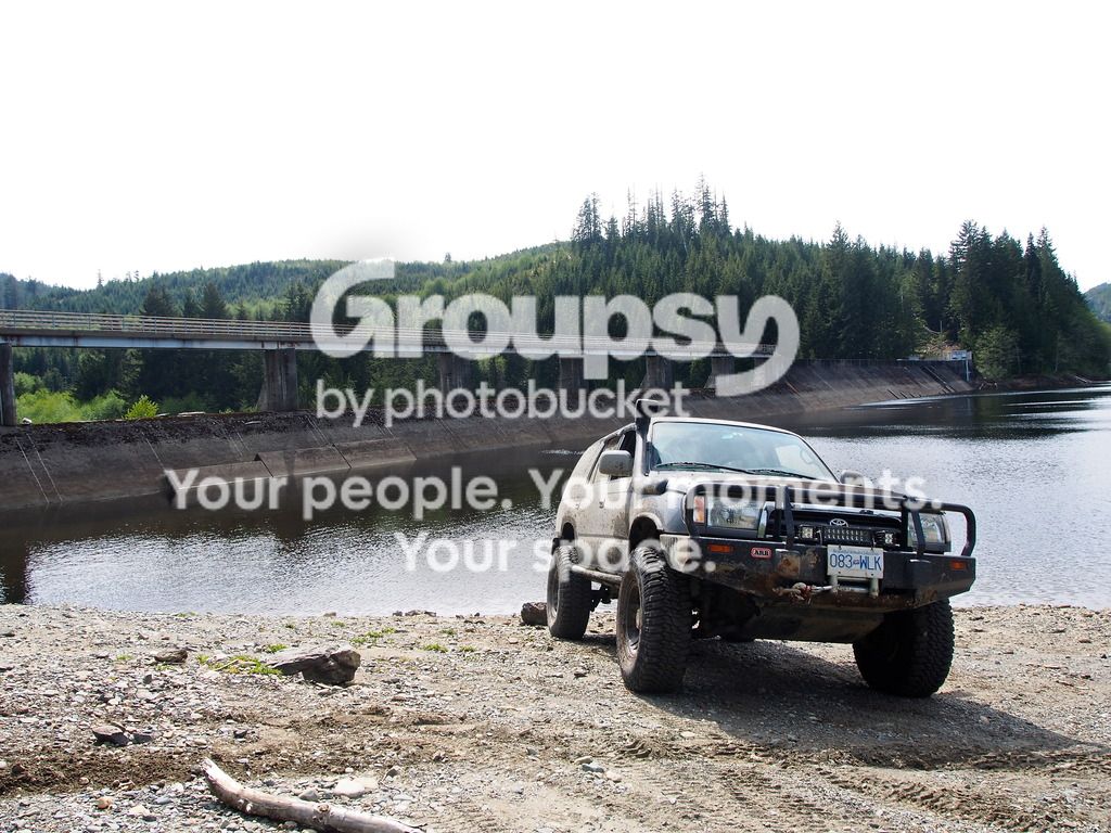

Im running spider trax 1.25 on stock back spaced wheels and 305/70r16s which sit pretty wide. I get a lot of fender to tire contact when wheeling in the front. Just remember if you wheel hard. The more spacer and backspacing the more rubbing you get as your push the tire out the wheel well.
It looks like 1.25 is the largest hub centric spidertrax offers, is that correct? I'm gonna be looking to buy some 2" spacers soon and don't want to get some ebay stuff...
I saw in your sig that you have a 1.5" body lift. How much did that help with the rubbing when you put your spacers on? I have a set of spidertrax 1.25 that I haven't installed yet. I do plan on getting a 2inch body lift soon & debating if I should wait to put the spacers on once I have the 2" body lift installed to minimize trimming. I currently don't have any rubbing with my BFG 285s on stock wheels with my 3" suspension lift but I'm assuming I will encounter some rubbing if I put them on without the body lift.
I had body lift before spacers if i remember right. I know it helps a lot. If I didnt have it I would pop my fender flares off all the time.

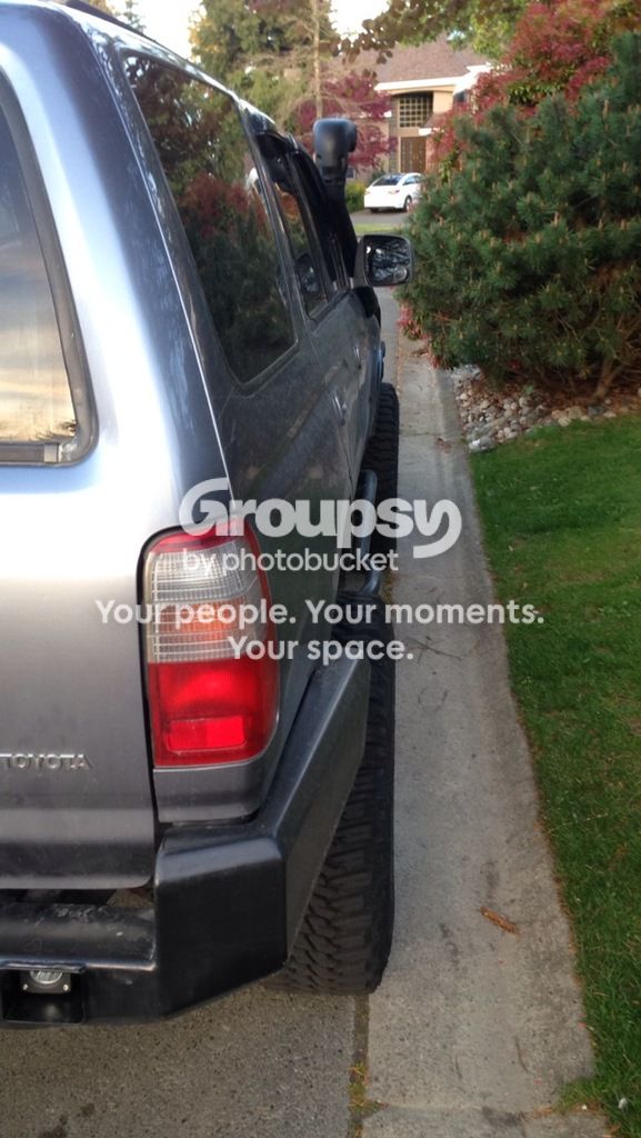

295 70 17 st maxx, no bl, toytec boss and outboarded rear extended 5100
