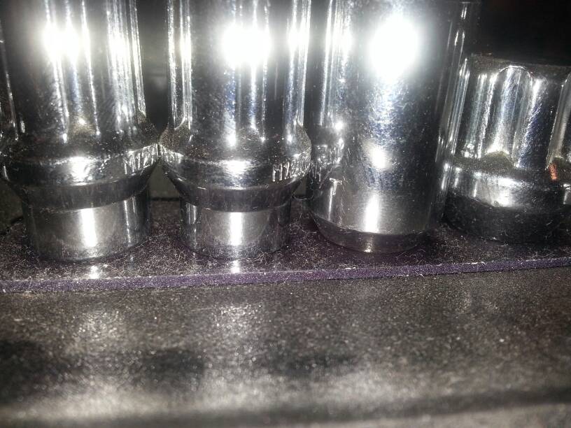

Even though the stud is not long enough. You can use some et lugs and get the job done. Here are some pictures of the lugs. Et are on the left
