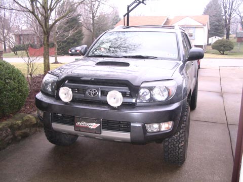

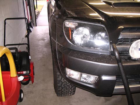

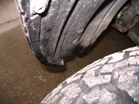

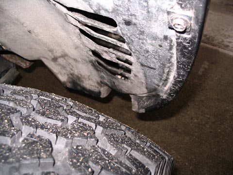

wow, this is exactly what this truck needed! the look is awesome! very easy to install...only downside is I was getting a slight rub on the front inner fender well (even with a 2/1 lift)...rather than trimming, I took the screws out, move the plastic, drilled a new hole and put the screws back in....and now some before and after shots...

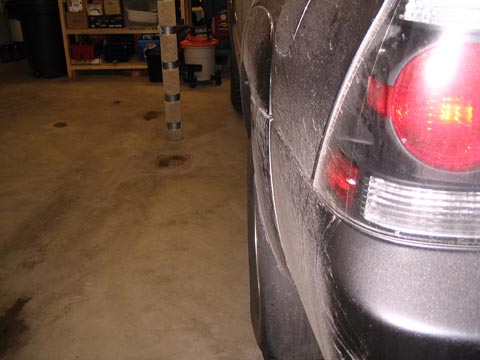

Looks good. Did you get 1.25" spacers?

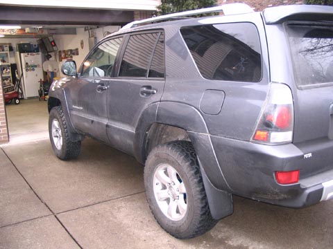

It looks like the tires stick out a little past the fender line in the pictures.
How does it look from the back? Do the tires line up with the mudflaps, or are they too far out?

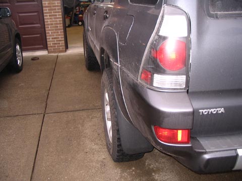

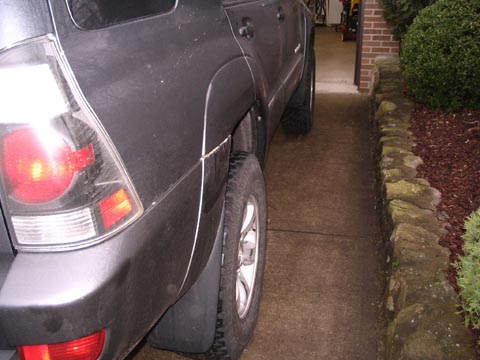

yup...1.25"...they stick out past the fender and the mudflaps ever so slightly...

Any shots from directly behind?
BTW, the best way to get an accurate picture from directly behind is to stand as far back as possible and zoom in as close as possible. Doing that will help avoid the "fisheye" effect.
Looks good, gives it a more agressive stance IMO. I think my truck has those on from the previous owner, how to I check to tell? The reason I ask is because my tires stick out farther than my fenders.
