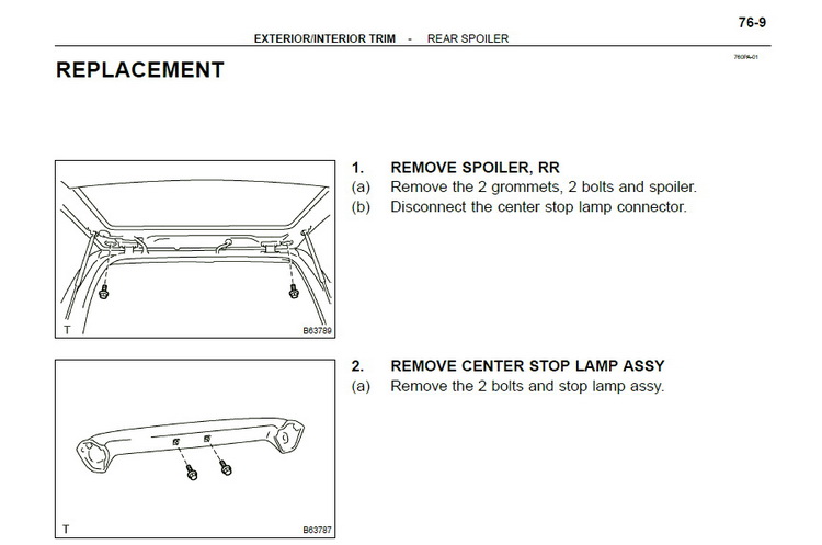

If you will decide to replace it with Toyota OEM, there should be no hassle as your 4runner already have holes, you can just directly bolt on the spoiler.

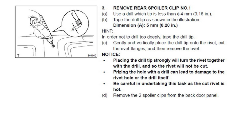

I have the aftermarket one, It looks like the same as the orig. and the location of the holes are the same(I'm not sure) assuming that they are molding it from an OEM pattern. I'm not sure if they are glued but the one I bought comes with a 3M double sided tape. Actually, the bodyshop installed mine because I don't have experience in drilling thick metal sheets. There should be no problem in your case as you are only doing a replacement
Anyway, heres the procedure how to remove it:

Nice illustration! Do you have instructions how to remove the 3d brake light? I wanna replace mine with the clear ones.

No, I have a 2005. Thank you so much for that illustration. I am still confused about that clip situation though... I wonder if the new one would just clip into the old retainer? Also, the spoiler is 500ish and it is ABS and comes pre-painted like the cladding.

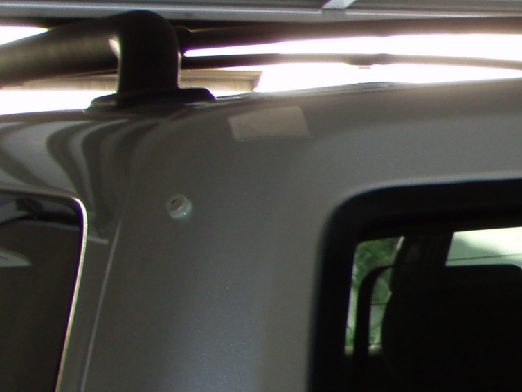

The clip is reusable as long as you are replacing it with an OEM spoiler. I've attached a photo to show you what the clip looks like. Best price I've seen for OEM replacements are from TRDparts4u, prices range from $265-315 depending on the color http://www.trdparts4u.com/MC-BAFJ-DI.aspx. Btw - the trunklid is steel not aluminum, I know because a magnet will stick to it.
