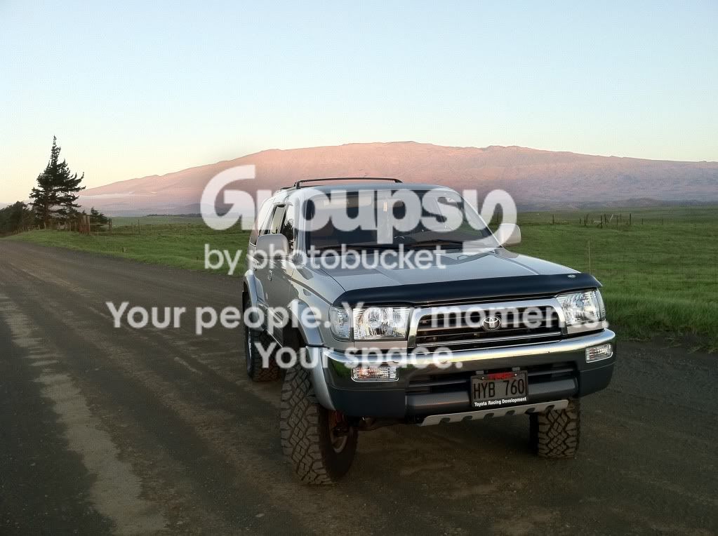

I did it to mine and I used the Tacoma one. I think the Tacoma one is better because you can modify it to fit the contours of the fat lip bumper. Mine is a 98 that a put a +99 bumper on and the Tacoma skid. I can take pictures later of how I attached it.

Custom brackets aren't even needed. All I used were the orignal brackets, two long bolts, two nuts, and some washers. There was a hole already on the bottom of the crush support frame area on the truck. Idk what to call it. So I drilled a hole out the top and dropped the bolts through those holes an attached the brackets to that. I'll get some pictures later tonight because its hard to explain.

here are some pictures. mine is a 98 with the +99 bumper just like yours so it should be the same.
<img src="http://img.photobucket.com/albums/v202/zacattack20/IMG_3019.jpg" border="0" width="800">
