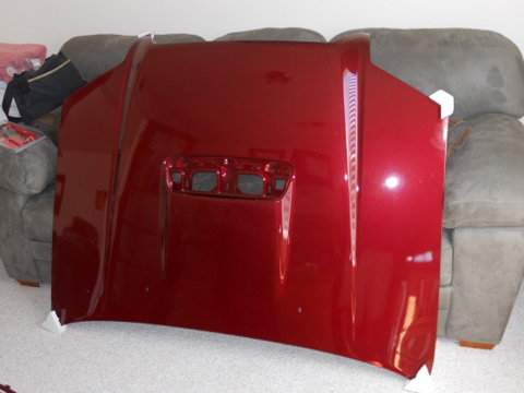

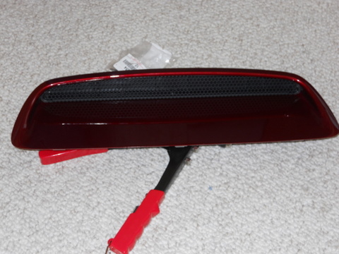

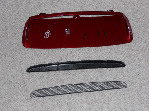

Craig's list, junkyards, etc etc. I did this and ended up with a crappy sport hood. Found it on autopart.com, I couldn't look at it (had to be shipped from NY state), so I had to pay for it. Anyway, when I went to pick it up, it wasn't a 0 defect item as it was stated on the site. PO had a bug guard and the edges on the leading edge of the hood had small chunks missing (bug guard hardware rubbing against the hood for years). Inside of the hood had rust and the paint was faded. Couldn't take it back, but I did get a discount on it. Anyway, NO BODY shop will accept a "shabby" hood and to work on it, will cost even more (if you find a shop in the first place). Instead of making a stink at the place I got the hood, I figure I'd cut my losses. I ended up getting an new OEM hood and my plan was to salvage some of the scoop parts on the old hood I got, but some of the screws hooding it in are rusted and rounded. Once again, I ended up ordering new parts (partznet). This all started when a chunk of ice/snow came crashing onto my hood. Insurance paid and all, I tried to save money, but that obviously didn't work. I'll more than likely list the hood here on the for sale page.

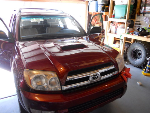

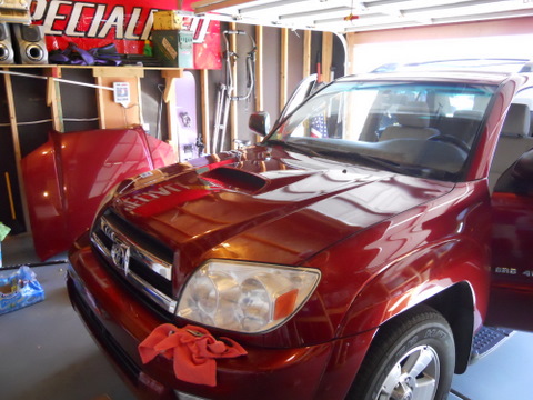

I'll post pics as this project moves ahead.
7CEC90A2-A3DD-4151-A85B-74A90938D7D6_zpsqkmhtxfx.jpg~original
EDIT: the hood isn't MASSIVELY CRAPPY, but the rest of my 4R is great shape and I would feel stupid just bolting this thing on. MY ODC won't allow it, LOL.
Does anyone have a part number (or good description) of the piece that snaps in to the square hole on the underside (passenger side) of the hood and takes the windshield washer inlet tube and the outlet tube that travels to the nozzles?
It’s the only piece I broke swapping in a sport hood.
