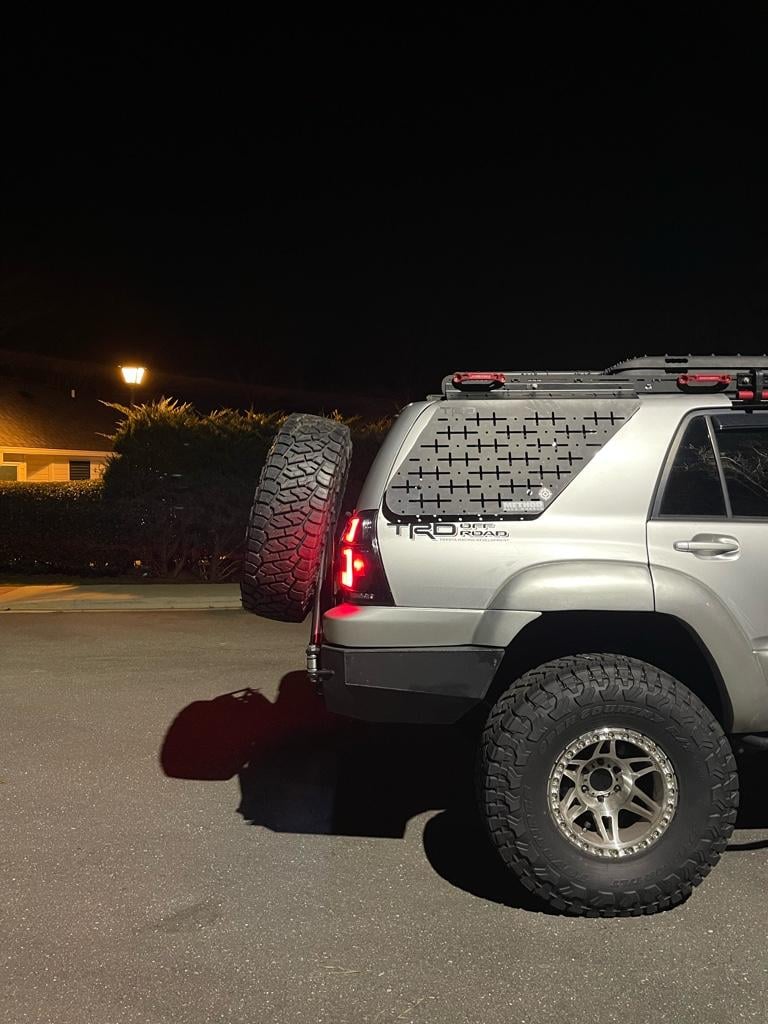

Spare is on

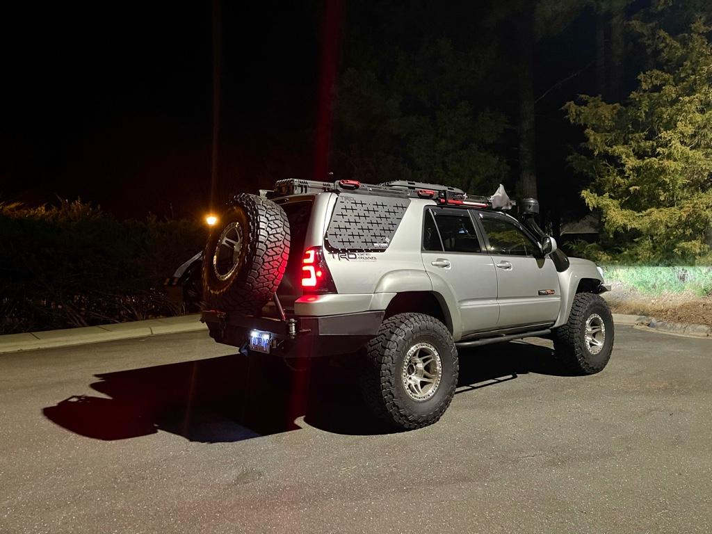

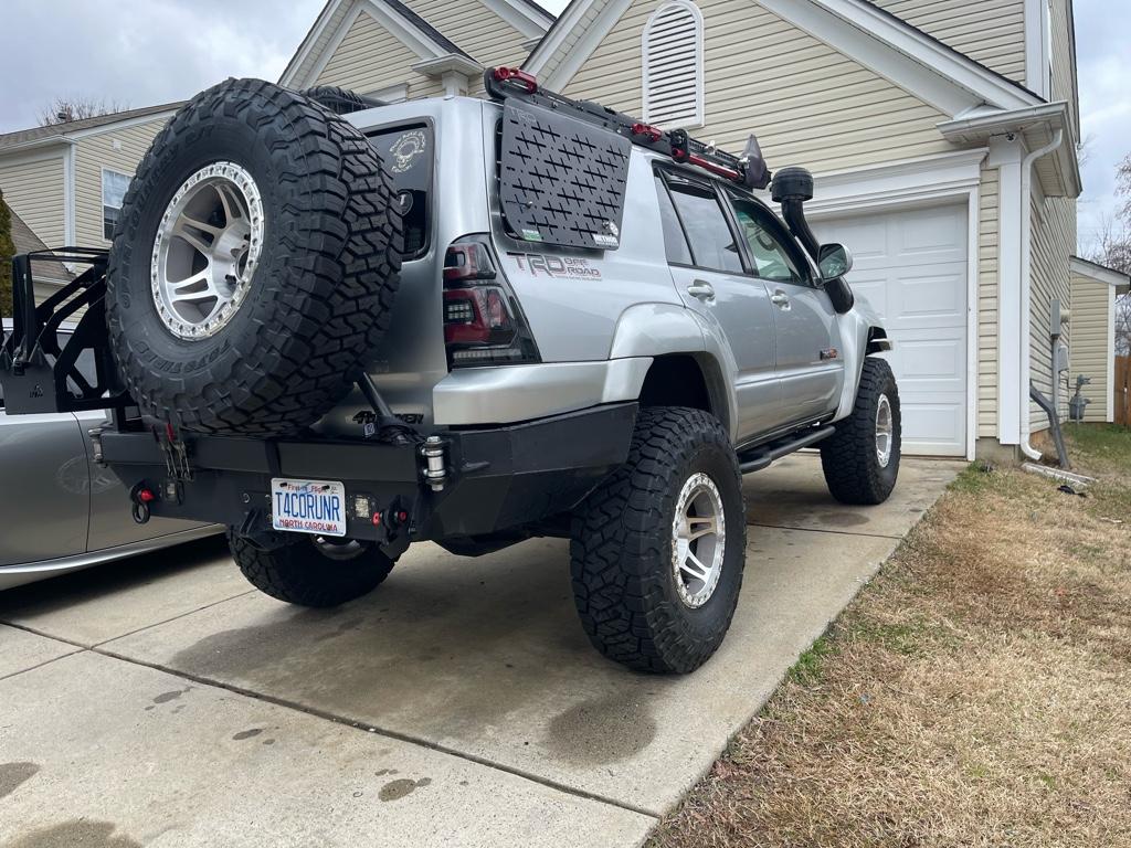

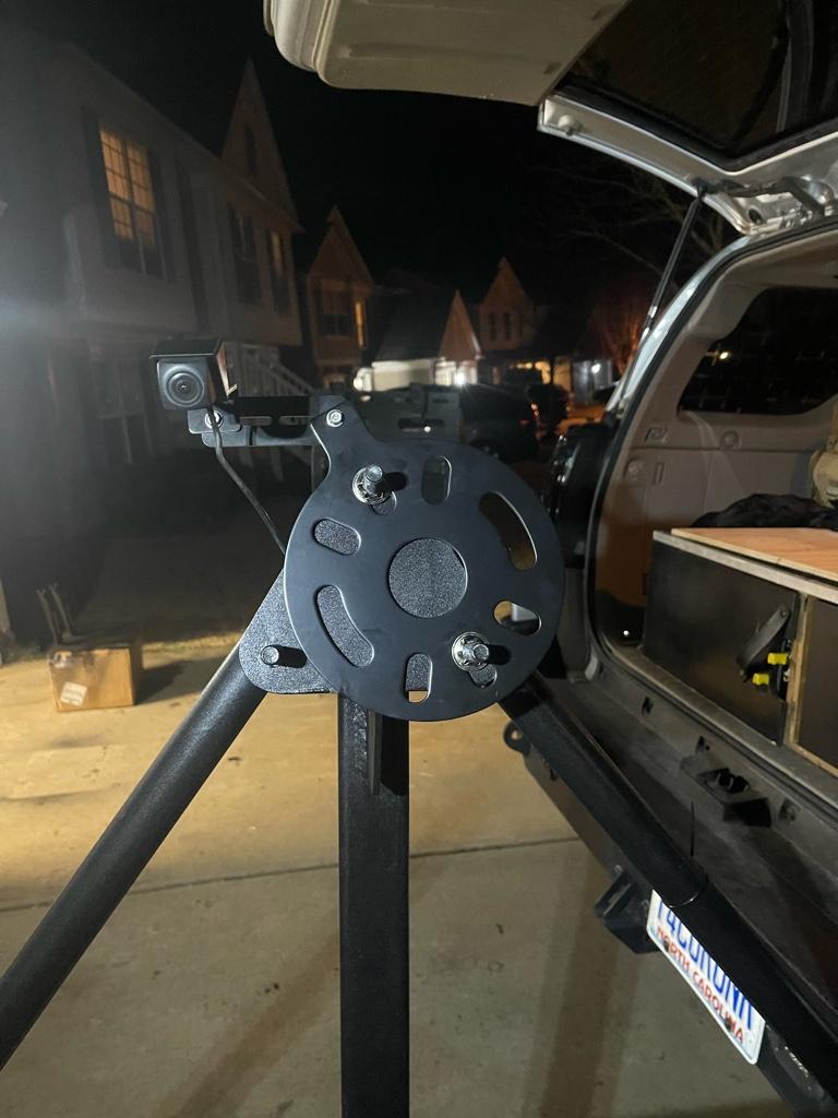

The swing out is solid. It's definitely more solid than my previous setup. There's obviously some shake if you try to move top/bottom of the tire, but with this size and weight it's to be expected. But just as a precaution (an antitheft) I'm going to run a steel cable lock through one of the lug nut holes and secure the wheel to the upper mount.. this way it's not as easy as taking off 3 lug nuts to grab it, but also, in the case something decides to NOT hold up, there will at least be a steel braided cable in the way..
for the swing out itself, I got some 11,000lb working load axle tie-down soft straps that I plan to loop around the assembly and probably just tie in to my passenger side recovery point. This way, in the VERY unlikely scenario that long term vibrations compromise the welds holding the pivot bracket to the flat face of the bumper, i'll have the strap drag the assembly along instead of catastrophically coming off the rig and bouncing around the road (there's probably a good 150-160 lbs all said and done).. seeing what a flying 35 wants to do when it hits pavement is giving me some PTSD and I just want to have some added peace of mind.

Btw, really nice work on the rear spare tire carrier!
Man .. that’s a shame .. 7k miles is nothing ..
Thanks! If I didn't have to work I'd stay home and fabricate stuff all day, it's satisfying building something of your own and having a finished product to show for it.
I will say though that having the spare mounted DEFINITELY shows it's weight. I'm back to quite a bit of a squat under acceleration. Still way more manageable than it was before but it's worse than it was with out the extra 100+lbs sitting furthest out when weight starts to transfer.

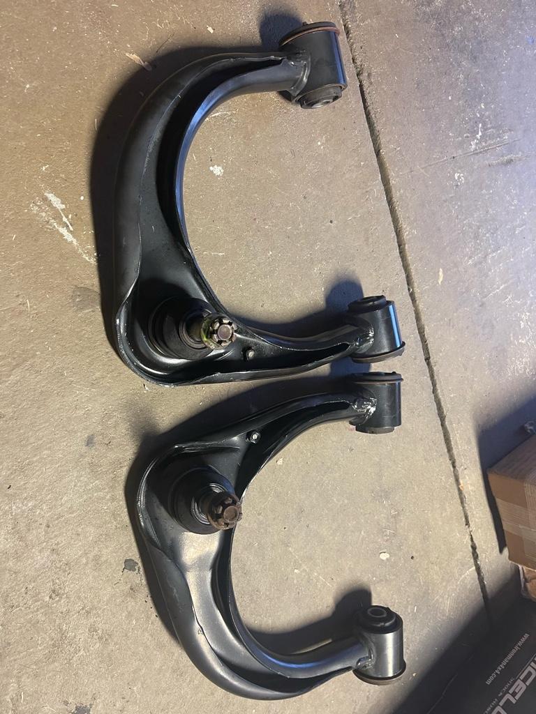

However... probably another one of my crazy ideas... but I just bought a set of super low mile 3rd gen tacoma upper controls arms that I'm putting in place of my JBA high caster arms... I just found out that the added down travel is pretty much marginal with the JBA (or really any aftermarket UCA) over the factory.. and having the built-in high caster means my wheel is pushed back towards the firewall.. I'm still making some contact with my relocated and shaved body mount, so a bit of reduced caster (from the current 4-5* I'm seeing) is a welcomed trade off to move the wheel away from the firewall a bit without having to cut more.. we'll see how that idea works out.. but $160 for 2 OEM upper control arms with less than 10k miles on them seemed like a steal to at least not give it a try.. :clap2:

Looks like the Tacoma UCA's will be here sooner than expected... might even have them in this weekend to see how it does :banana: I'm hoping I can keep my caster in 2 degree range at least.. it's a sacrifice I'm certainly willing to make because I don't know how much more cutting I want to deal with on the body mount :banplease:

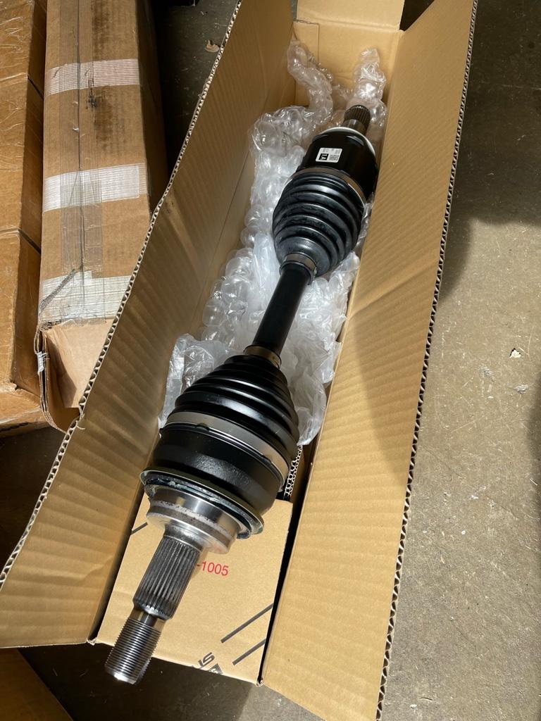

While on a factory-parts shopping spree, I decided it's probably a VERY good idea to get some spare CV axles... the ones I have now are OEM axles, but came from Ebay with some questionable mileage... I found some reasonably priced 5th gen OEM axles from one of the toyota dealers for like $290 shipped per axle with tax... I thought it was reasonable for a non reman-oem axle assembly. The plan will be to swap these in and keep the current, old ones as spares.. or maybe i'll just keep running these and see what happens.. :boom:

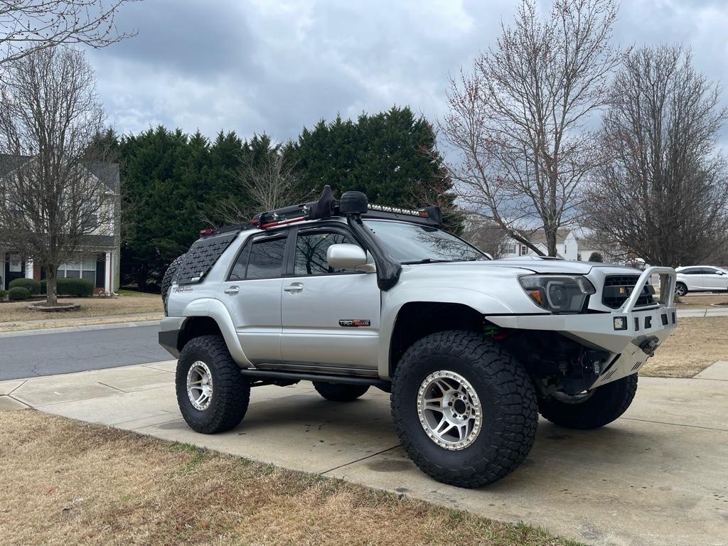

It’s been a long long time since she’s gotten a proper cleaning . Looks good cleaned up, though I’d prefer to be out in the wild getting it dirty

Well let’s see if I’m just crazy or if this puts me in the sweet spot .. I know one thing … there’s no quality like oem Toyota quality .. can beat a set of sub 10k mile UCAs with fresh bushings for $130. Yes, I will lose some caster .. though I feel like I have some to spare and keep it drivable.. but I don’t think itlll lose much down travel .. from some tests I’ve seen, the oem balljoint actually has quite a bit down angle compared to a lot of aftermarket UCAs. For instance, it does let look like icons give you any more angle than stock , and since there is much less loading on the uca compared to lca and other components , I think this will hold up just fine.. and could give me the amount of clearance I need to the body mount.

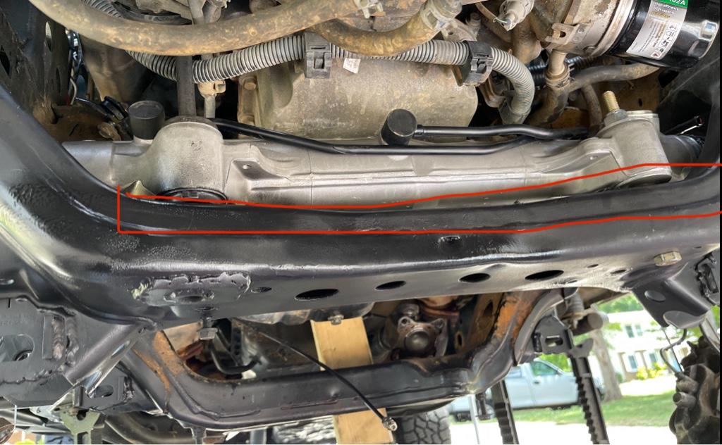

In reference to the above lc200 comment here is what I’m envisioning .. since the lca mounts build off of this member I will likely not mess with the bottom .. but there is a seam half way up that could potentially be cut out and reinforced, effectively dropping the rack an inch or so, possibly more with a little effort. Not the smallest project.. but would literally allow me to raise the front an entire inch from where it sits now without impacting bump steer any more it currently is :shrug:
And this is the rear diff mount point that locks in the height .. what’s stopping me from cutting this completely off, dropping it down 1 inch to match the diff drop front spacers, and boxing it back in to allow for clearance around the front driveshaft ..? This would effectively reset the cv axle angle to exactly where it is now, but with 1 added inch of lift .. am I crazy ? (I mean .. obviously .. but specifically to this idea ..? lol)

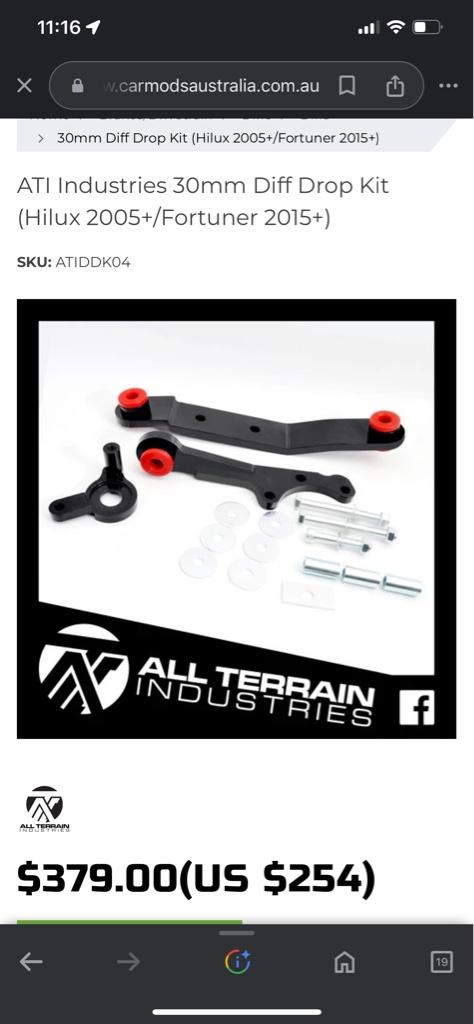

If you want to properly drop your front dif, look into Phat Bars from Australia, they do things differently over there and a lot of it makes sense.

Had to look that up really quick. Apparently that’s the “arm style “ diff drop . In general , it’s basically the same thing as a diff drop spacer kit, except the curved arms allow for no loss of clearance to the skid plate up front since the arms are curved.. other than that, they don’t drop the diff any more level than a spacer kit, just at 5-7x the cost.. yikes .. a definite must if you want to maximize ground clearance .. I mean losing an inch at the skid plate is effectively negating the step up from 33s to 35s or 35s to 37s.. which is huge.. now a combination of these arms with dropping the rear mounting point an inch.. woo boy lol. Talk about form and function .. you’d be able to get an extra 1-1.5 of downtravel with a proper uca and shock .. or just added street ride height with minimal wear on cv and boots.
Late night shopping done sir it again .. [MENTION=101325]rdruss[/MENTION] I’m blaming you for this one :rofl: .. after taking a quick second look .. I’m pretty convinced all these places get their kit from the same vendor in China .. just guessing .. since it’s literally available on Ali express lol. I didn’t go that route but did find this and figured for under 300 bucks it wouldn’t hurt to try .. long term I’m still set on investigating the relocation of the rear mount lower but for now this should be interesting to see if it works or not ..
Nothing like some brand new OEM parts from Toyota. Decided to go ahead and throw these in while I swap out to the oem uca at the same time later this afternoon.

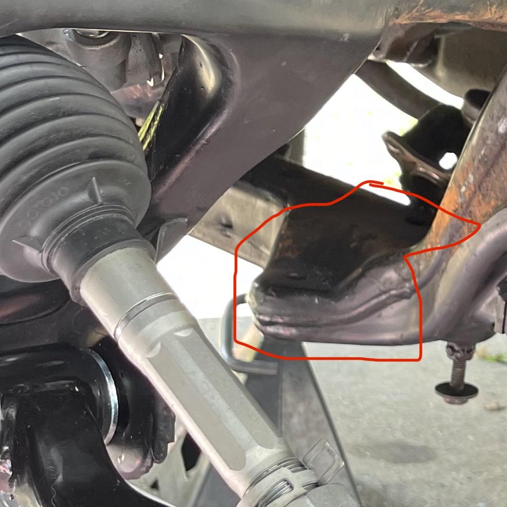

Axles and factory UCAs are on. From the first test it looks like it pushed the wheel away from the mount just enough to clear :)
The drop arms should be here match 15th , it should drop the axle angle down even more and hopefully keep these expensive OEM axles alive for a while.
These 5th gen axles don’t have a whole for the cotter pin /secure nut to the axle nut.. might address that later but likely will just send it. It’s on there solid.
