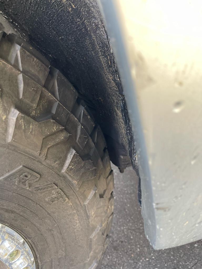

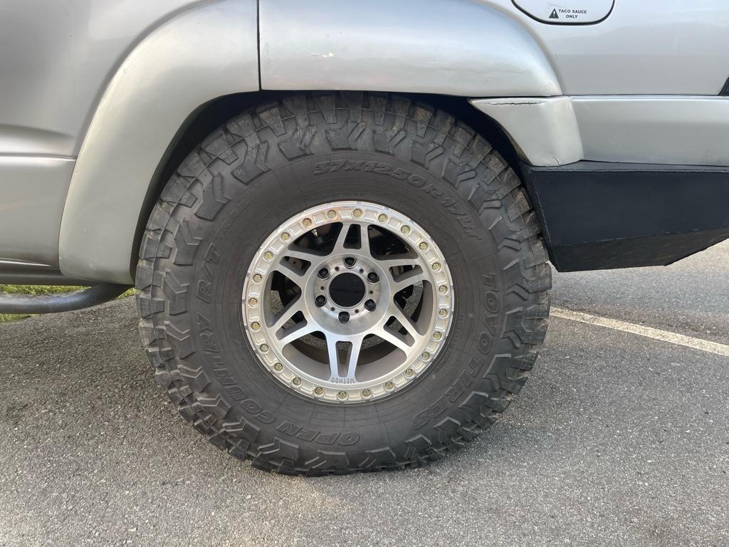

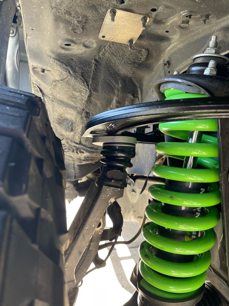

Breaking news .. I don’t fit 37s as well as I thought when the rig is in the ground :facepalm: lol.

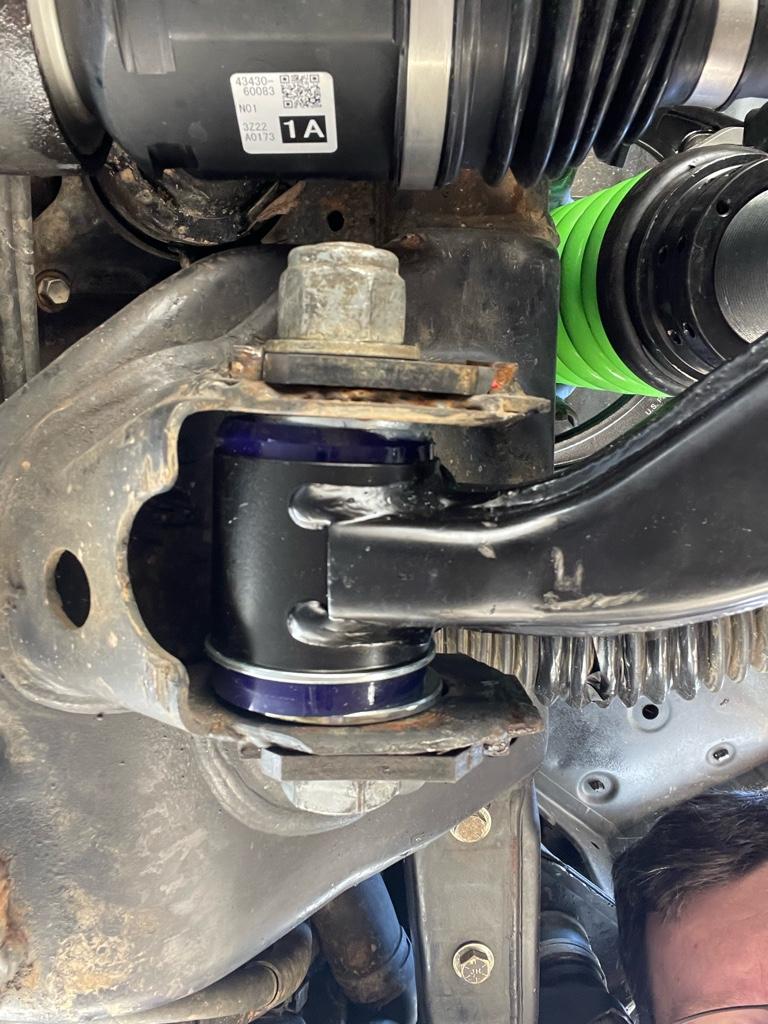

The lower lca bushing move, ALOT under load. Like when in reverse at full lock vs drive. In drive, I have almost a half inch clearance to the body mount .. in reverse .. it hits. Got it ground back a decent amount and everything was good. But then I decided to take a little camber out of the front so I’m not wearing the outside as much .. well .. moving the front setting over just one adjustment gets me the perfect camber I’m after .. butttt I’m back to hitting the mount. Fml. If I knew this .. I would have gone WAY more aggressive in the chop x but it cleared on the stands.. lesson learned .. I guess an option is to get an adjustable UCA that separates camber and caster .. but man.. I don’t know where it ends lol.
Almost ready to pull the trigger on the RCLTHD KIT and call it good lmao.
Problem solved (?) Went Google searching and found some SPC uca for $400 .. figured I could probably get half of that back in my jba arms.. from what I heard they can be bit and miss on how long they last .. but with everything else I’ve sunk into the build and swapped out .. what’s another set of arms ? lol
This will let me run camber adjustment independent of caster , and hopefully maximize distance away from the body mount .. I don’t know how much more cutting back I’m willing to do with it

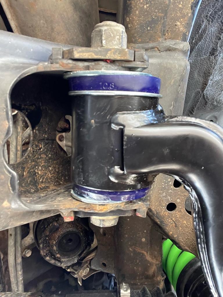

So.. I just found out about Super Pro offset LCA's... and in true to form fashion of the rest of the build found some for a decent price on ebay.. I had no idea these were even an option before.. and anything that will allow the tire to slide forward any is an absolute must-try for me right now :guitar3:
I'm still looking for exactly how much these LCA's move the wheel forward.. but apparently it is a sizable amount..
My only (partial) concern is that from what I gather, the cam bolt in these arms is larger than the factory one.. meaning that my current cam tab eliminator kit won't work with the these new arms.. not a HUGE deal.. I could just run the cambolt that comes with the kit.. or just look into getting 4 larger diameter bolts to swap out and drill the plates to accept them.. I guess time will tell. But if everything goes to plan.. I 'll have dialed in camber via the SPC UCA (which apparently will either last 50-80k miles , or I'll be swapping bushings and balljionts every oil change :thumb3:) , get some caster back AND have the wheel pushed forward enough to clear the current configuration of the body mount :amen:

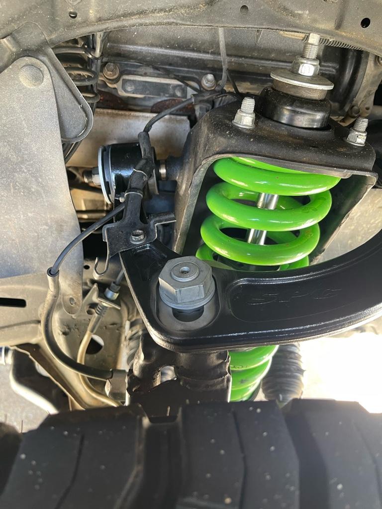

SPC UCA's delivered fast as all, as did the double-offset SuperPro LCA.
Both are installed as of yesterday. I must say.. initial thoughts on both is pretty impressive. Whether the SPC balljoint/bushings last is one thing.. I did just find out they have several options for replacements depending on who you bought them from..

The adjustability of the UCA is pretty fantastic.. I corrected quite a bit of positive camber with it. It's nice to have some-what independent adjustments, though you're still partially linked to having caster/camber be related because of how the ball-joint spins for adjustment.
The double-offset LCA's from SuperPro are also pretty damn fantastic.. the offset bushings put a starting point of the rear mount being pushed out and front mount being pushed in, before you even make the adjustment. I didn't have time to measure the physical dispalcement between factory and these arms... but with the combination of the UCA set on the D setting, I now have an added 3/4-1" of clearance to the body mount .. which is pretty wild.
We're trying to throw it on the alignment rack in the next 3 days and dial it in.. but depending on where my caster lands on the current setting, I might even go up some because I feel like I have room to spare for clearance.
Oh, and my concerns with not being able to fit the cam tab delete kit were invalid. The bolts and tabs worked out JUST fine. I actually couldn't use the cam bolt that came with the kit because aparently I welded my cam tabs from Total Chaos a bit too tight and the super pro cam did not fit in between without modifying it. I decided to just use my delete kit instead since I'm looking to max out the setting and let it be.

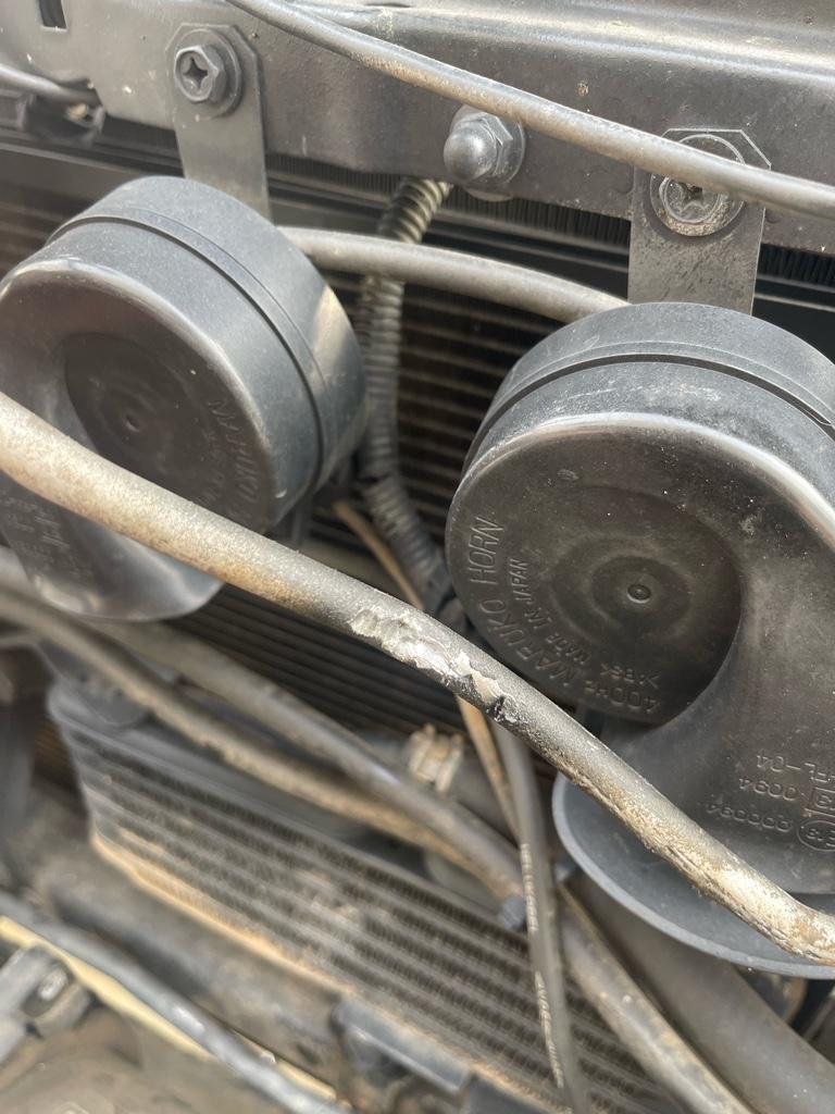

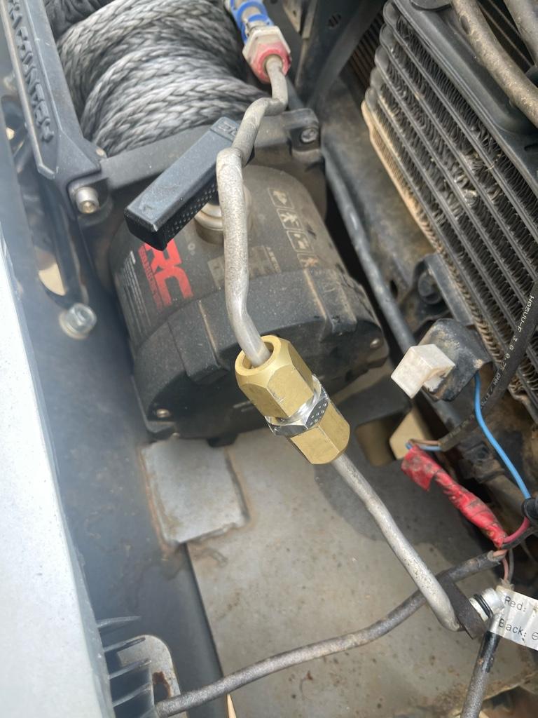

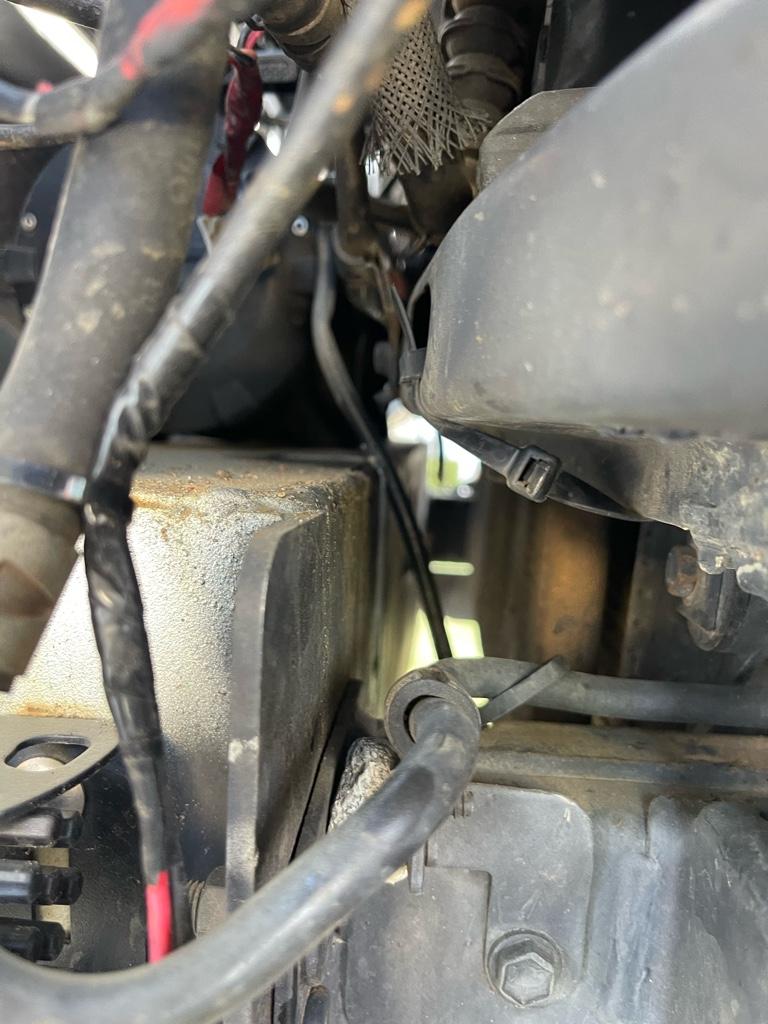

Better this weekend than in the 1300mile drive next weekend I guess.. came out from dinner last night to a nice little puddle under the front end .. come to find out my AC line was barely rubbing on the bumper edge and finally rubbed through .. :faceplam:
Got a couple of patch kits on the way from Amazon tomorrow .. even if I wanted to spend the $200 on an oem line it won’t get here in time .. hopefully it holds.. would be nice to have AC now that’s it’s getting 80+ out lol.

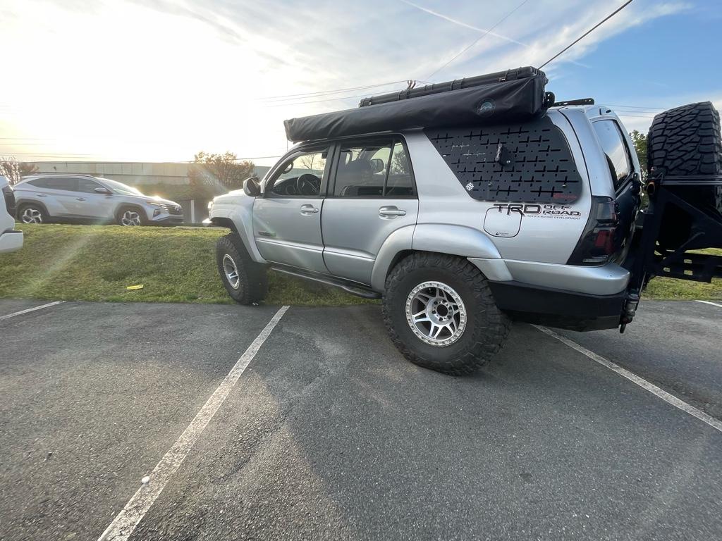

On the bright side, the street parking pics came out pretty sweet. Brothers jeep is on 37s as welll, finally nice not to look tiny when out with him lol.

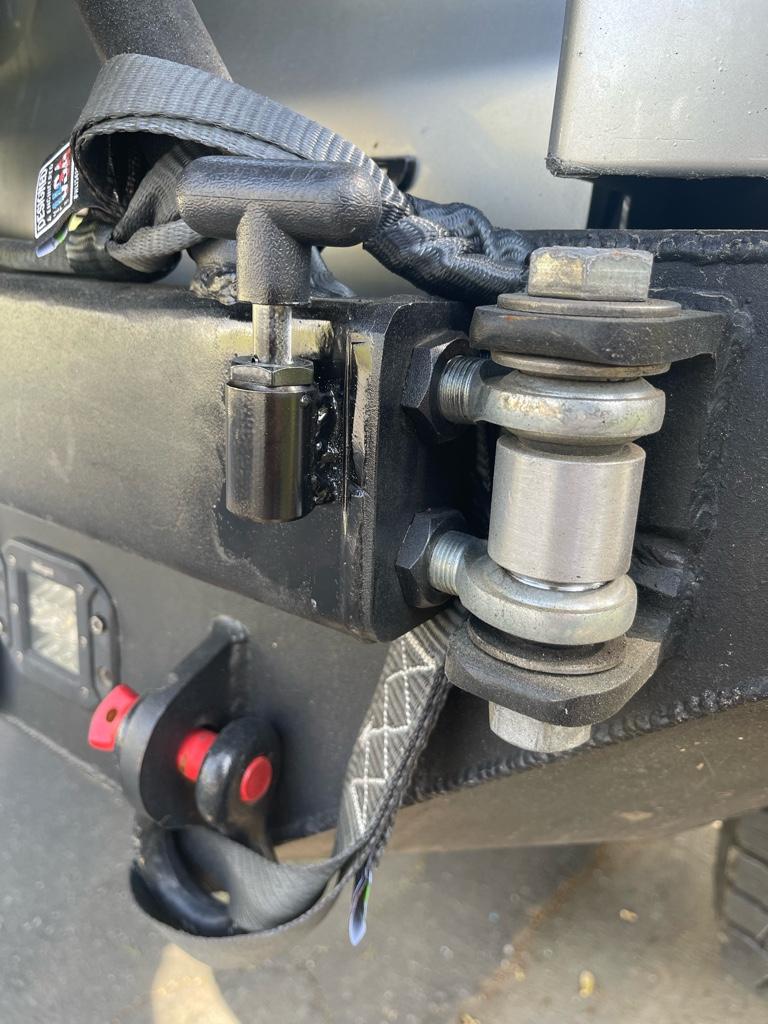

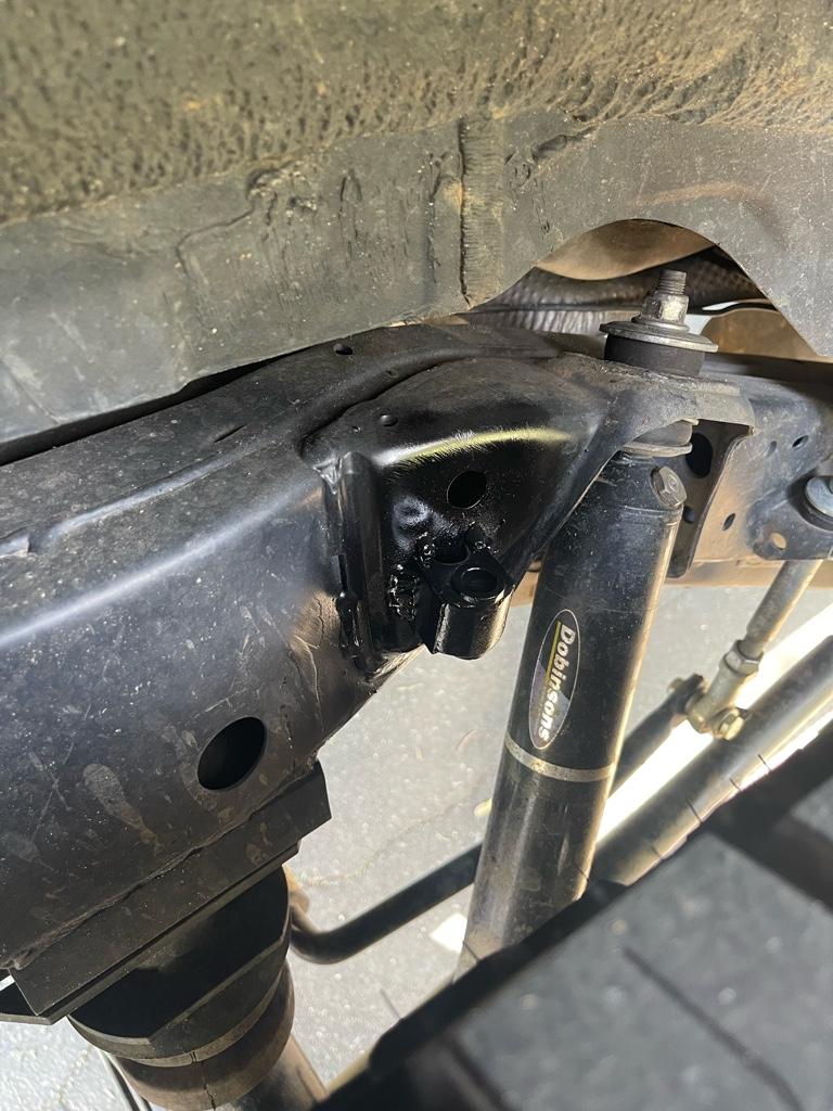

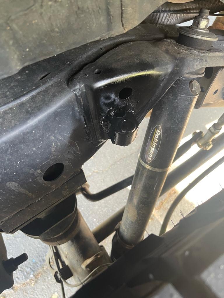

Took a few minutes yesterday to weld on some remaining pieces.
The swing out lockout pin is on, this was a must for the coming up trip since I tension the awning against it. But I also got the limit strap brackets on the frame. Won’t need to run limit straps for the on road trips, but want to finalize the measurements and get straps on order just as some insurance to not drop a spring out on the trail ..these will connect to my old TK1racing sway bar brackets on the axle.
I got quite a hefty checklist together of things i need to go over before we hit the road early Friday. #1 is to try and patch the AC line with couple of kits I got from amazon. Hopefully it holds decent enough to at least have some cool air. I don't have a vacuum kit to properly fill the system, but I'm hoping I can get enough it to run the compressor with no damage.

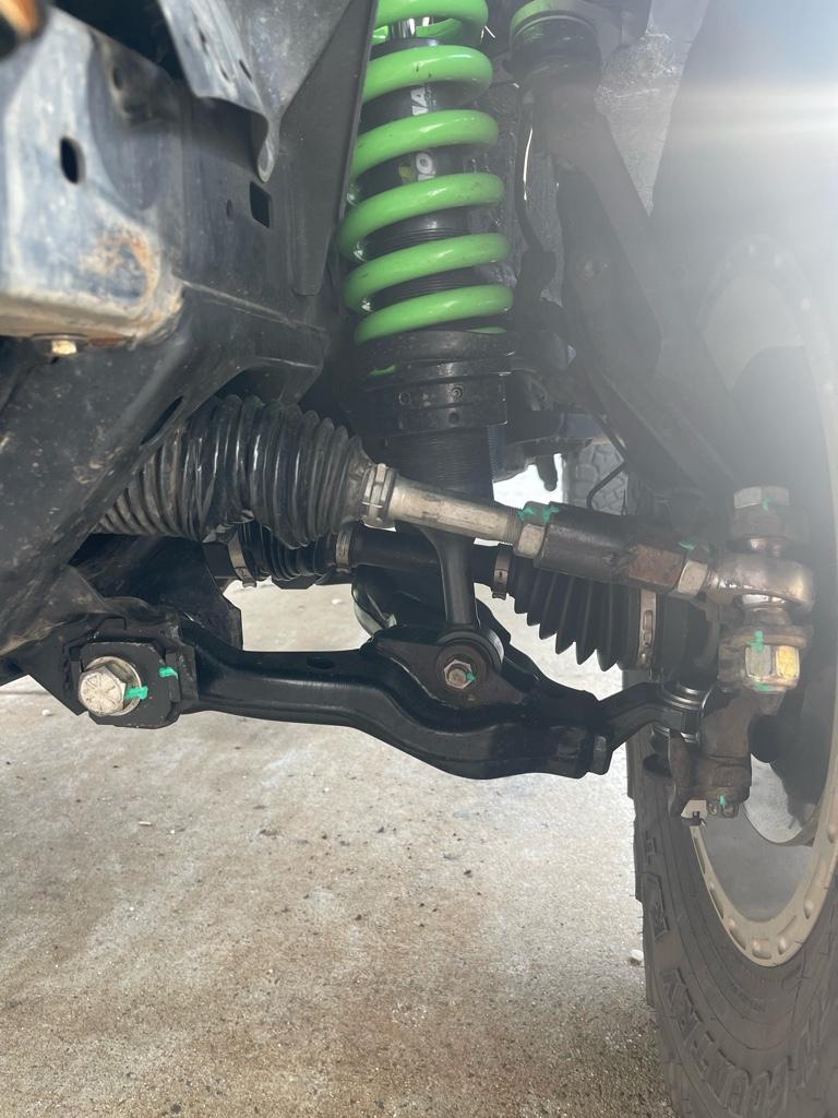

In a very close second (probably should be first? lol) is going over all my nuts and bolts to make sure everything is torqued, and then marked with some torque paste for quick visual inspection. I'm SUPER paranoid about taking this Frankenstein of a build so far away from home (particularly because my wife and dogs are with me, wouldn't be as much of an issue if it was just me) so I'm doing everything I can to have some confidence before we head out. Brining all the spare parts I can gather (really just front wheel bearings, extra fluids, extra drive belt, etc), making sure everything is topped off the best I can and see what happens.. This is REALLY making me look forward to possibly picking up the new Landcruiser as a family travel rig in a couple of years for the trips that don't require any sort of extreme offroad capabilities lol.
Let’s see if this patch works ..
Also wen through all of the bolts I could think off, checked torque and marked, green to match the new springs lol

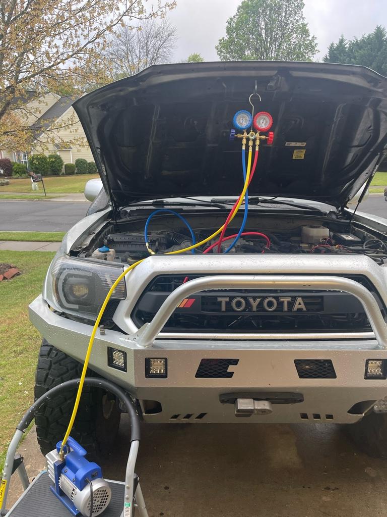

YouTube certified AC fill tech now lol
30 mins in vacuum still holding .. seems promising. I didn’t get any compressor oil to fill since I imagine all or most of it should still be in the system and did not evacuate during the leak .. hopefully I’m right :shrug:
Giving this another 30 mins, pulling vacuum for 45 more and then filling with some R34. Don’t need it ice cold .. but some cool air would be welcomed.
well, vacuum held without moving a smidge.. so leads me to believe the leak is not there (at least for now). Held for over an hour.
Pulled some additional vacuum for almost an hour after before filling it up.
