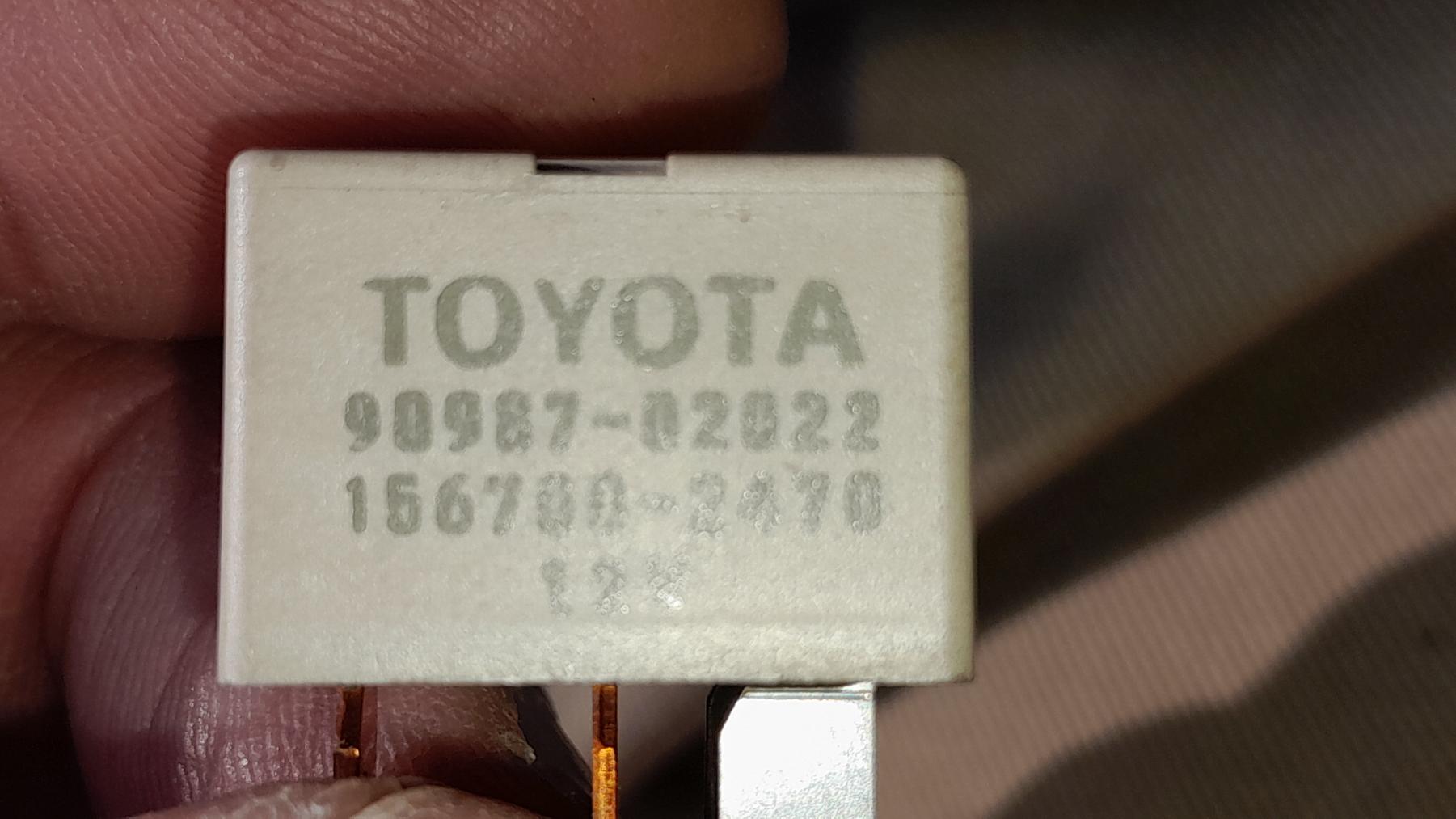

My 03' had a cycling issue, but it worked well enough to get by for years.
Back in Feb on my trip to AZ, I was in Parker to watch race qualifying, the AC would kick on and kick out w the light blinking.
Did some research on a mag clutch relay issue people were having with the 03'-04' MY and ended up finding a replacement relay at the local Autozone. The cycling issue has gotten a lot better.

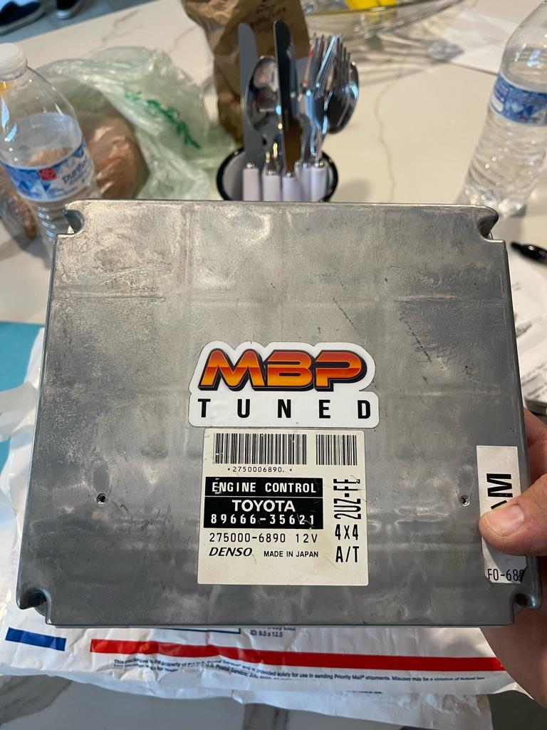

Came across a tuned v8 ecu from MBP tuned , verdict still out for more seat time, but first impressions are solid. Crisper shift with better shift points, feels more peppy and has potential for slight increase in hw mpg.

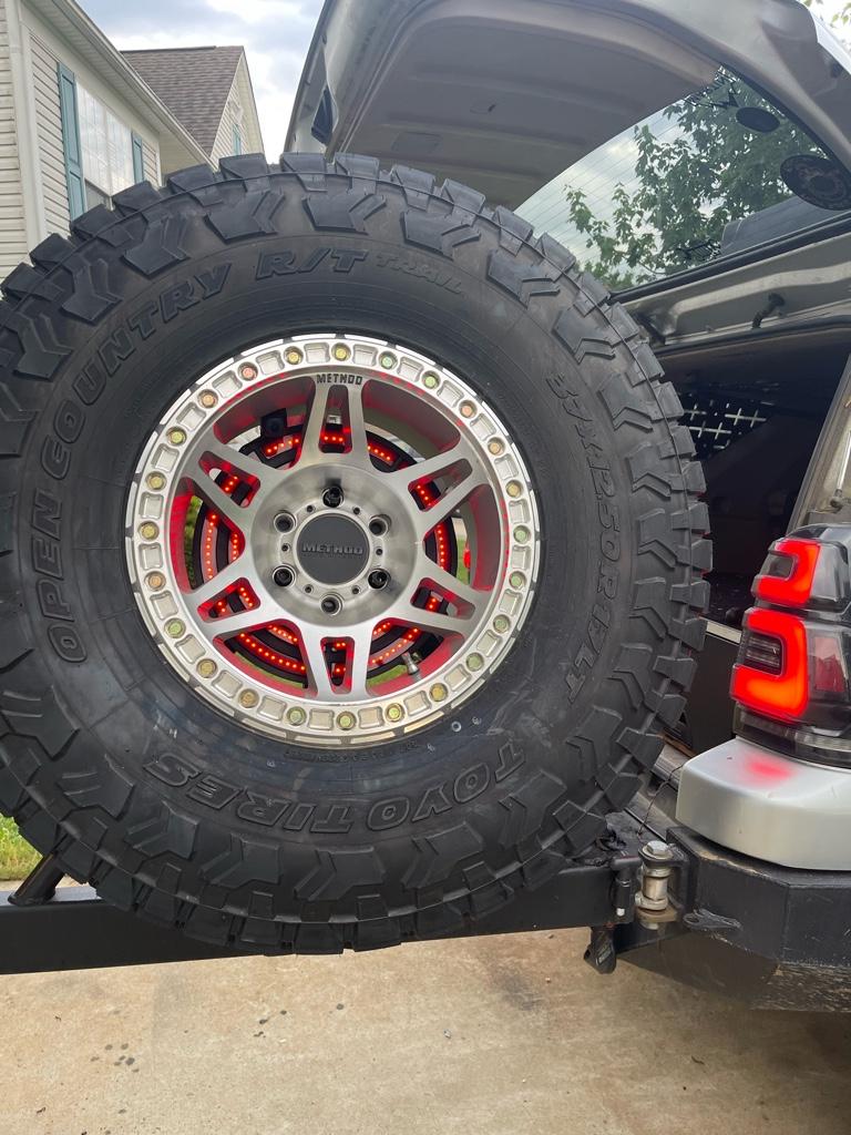

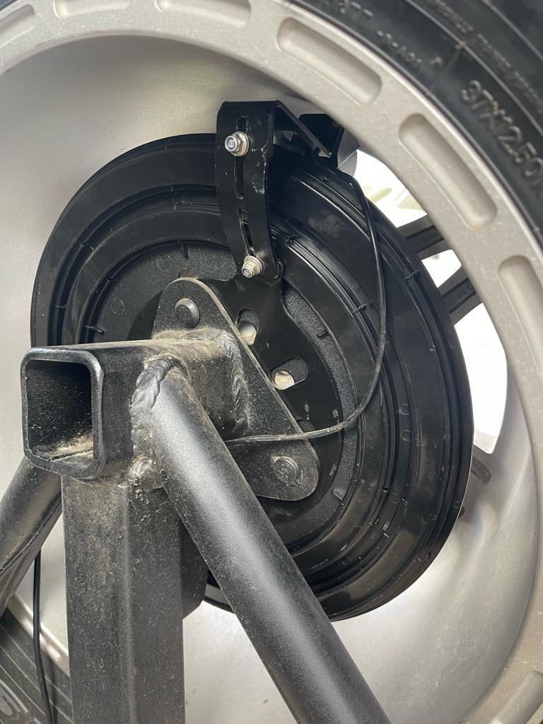

Also decided that my brake lights are a bit dim in the day light if I have my running lights on so I threw in a 14 in dual led spare tire brake light. This should get the message across nicely lol. Mounting was a bit tight with my rear view camera.. will probably fabricate a different way to mount it later, but works for now.

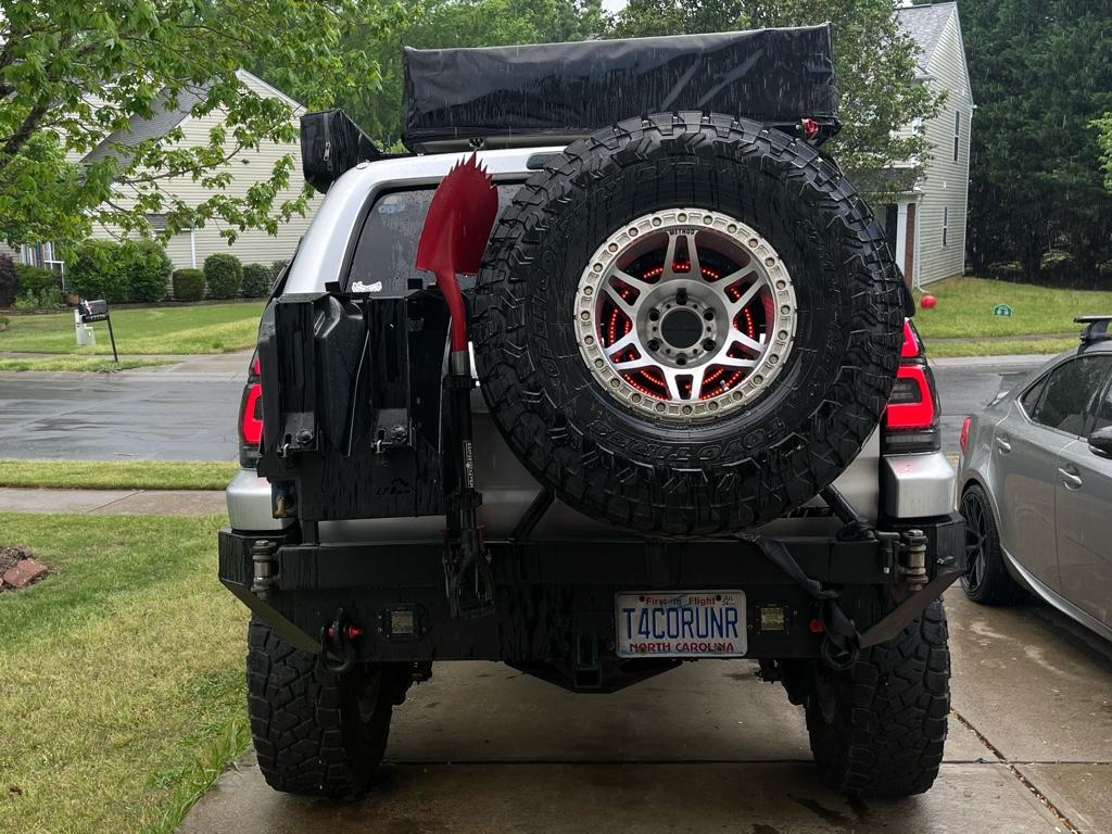

I went with the Ascend Fabrications rear DIY bumper kit... not the cheapest (though all the prices have gone up) but I was SUPER impressed with the quality of the kit... the hole thing came together on a small welding table in the garage and fit like a dream. Single swingout with a table for some expanded camping table-top space. Paint is drying, planning on doing a final fit/bumper cover trim this week.
