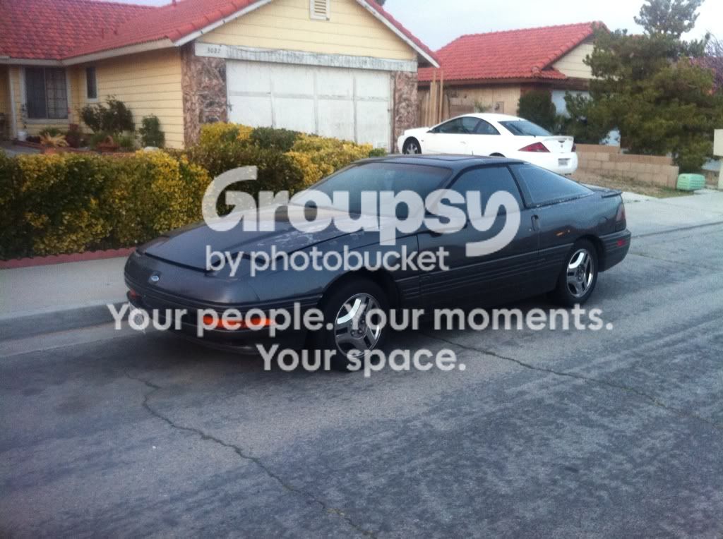

I painted a car with spray paint, half assed it really, but it came out pretty good. Some more effort and it could have looked really good.
The paint was SEM Trim Black. I bought it from a paint specialty store for around $15 a can. The paint job cost around $125 total. I didn't spend a lot of time on prep and I only did one thick coat. A good amount of effort and two or more coats could bring you up to $300ish.
081997E8-07AB-4DCA-9511-5D33CE27ED3E-10772-000007D62D77D53D_zps5e808b19.jpg~original
31FA9CE1-AFFD-422C-ADC7-74089624B919-10772-000007DAE497C0E3_zpsd3251a0f.jpg~original
How it used to look like
