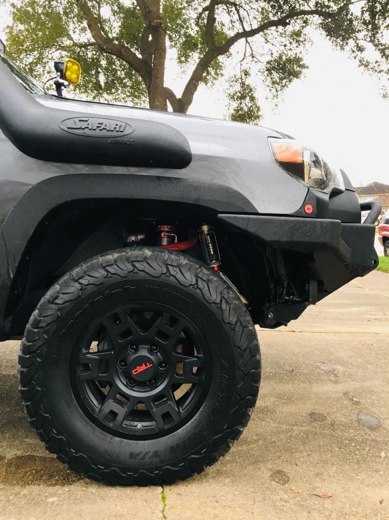

[MENTION=238374]jpaws[/MENTION] this thread will be the most helpful to you:
Calling All Kings: an informational survey
Post #7 is running SSO bumper / winch with 650# coils @ 3(D) / 3(P) for about 1.5"-2" lift.
Post #2 is running an alumninum bumper / winch at a similar weight with 600# @ 8(D) / 8(P) threads showing and considering 650# for less preload.
Post #32 is mine running the aluminum bumper / winch with 550# @ 12(D) / 10(P) threads showing. I will be changing to either 600# or likely 650# springs to reduce the preload, but it hasn't been a huge impact thus far. I'm not sure why Filthymotorsports suggested stock 550# springs with the list i provided of extra weight. I'm also not sure why i didn't push back because it just didn't seem right.
1) based on that i would say you chose appropriately and even have some extra capacity if other weight is added (2nd battery, compressor, etc)
2) hard to say best guess is 6(D) / 4(P). measure hub-fender before you change anything and then adjust as necessary before your alignment until achieve the same height
