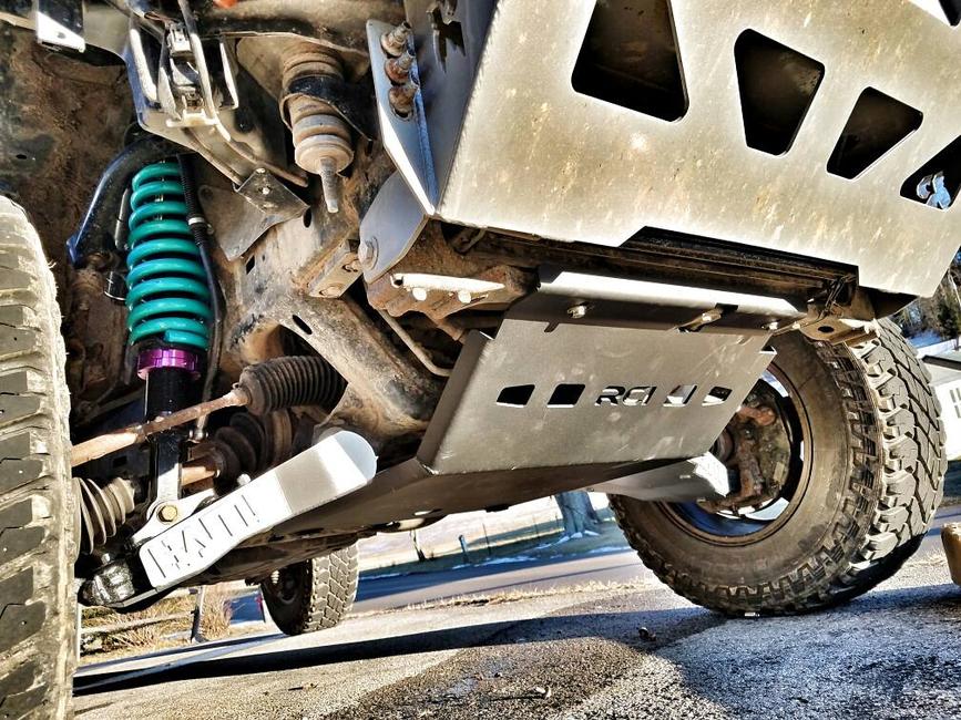

I'm running some heavy Dobinsons springs and love LOVE them. Fronts are remote Resi with their C59-350 springs and rears are C59-677v .. I couldn't be happier. Ive got a metal front bumper, sliders, RCI skids on the front and also diff, rear tire carrier , SnoMaster fridge, and rooftop tent. I've got a winch too just too lazy to install until it warms up lol
Here are some pics
