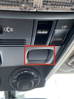

Does anyone sell a push button switch for the slot by the terrain selector?
I checked the usual sites such as AOB, but nothing I could find.

i believe that's a proprietary size toyota switch. the only use is for the SOS button that some models have (limited and maybe others?)
chances are you'll have to retrofit a switch in there
You should be able to remove that blank, install your switch in it, and snap it back in. If you damage it, you should be able to order another. Finding a ready made one to fit that spot is going to be difficult.
Thanks. I’ll go to the junk yard to see if I can find a safety connect SOS switch or any square switch that will fit. If not then I’ll retrofit (jury rigged/jerry built) something. I do like ready-made.
There is not much room behind that blank. I tried to put a locker switch there.
Passenger Eject sticker, or a turbo boost sticker? anything better than a blank.
my 2020 has SOS switch there.

I standard "small" pushbutton made for our trucks will fit there, rotated 90 degrees to horizontal. You just have to make a mounting point for it from behind.
I removed the blank and built up a mounting pad out of several 1/16" plastic sheets that are screwed into the same mounting hole as the blank was:
CruiserHeads will do a custom button image, rotated horizontal and centered if you contact them.
