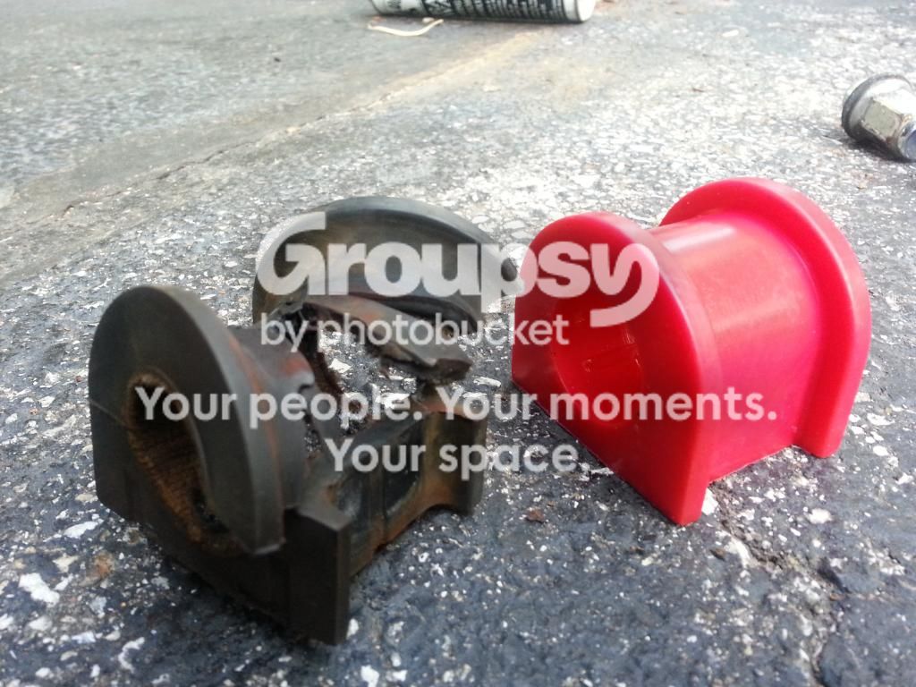

I had a squeak that was really annoying. Ended up being a bad sway bar bushing. Easy enough to check. Just go under and see if they look bad like this haha.
Rocky5000100,
I replaced the swaybar bushings a few months ago, and yes, they were about like yours!
I figured the whooshing sound was probably from the shock and was just a little confused when it developed into a squeak. Thanks guys!
