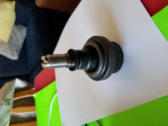

Just received the Moog ball joints that are greasable. I see that the Moog K500017 lower ball joint has a different boot on it. It seems to have a slim boot instead of the balloon type OEM one. It covers the area but I was just wondering if anyone used this replacement and if so, did they just put it on or did they add the larger boot over it. I have attached the photo of the ball joint.

It's funny you say that. I am waiting for the front and rear sway bar bushings I ordered. I am just worried right now that if I pull out the ball joint, will the replacement be ok even though the rubber boot is smaller.
I did some research and found out that the boot on the Moog was a newer boot and was to be used the same way as the original one with the bigger boot. I will try it.
