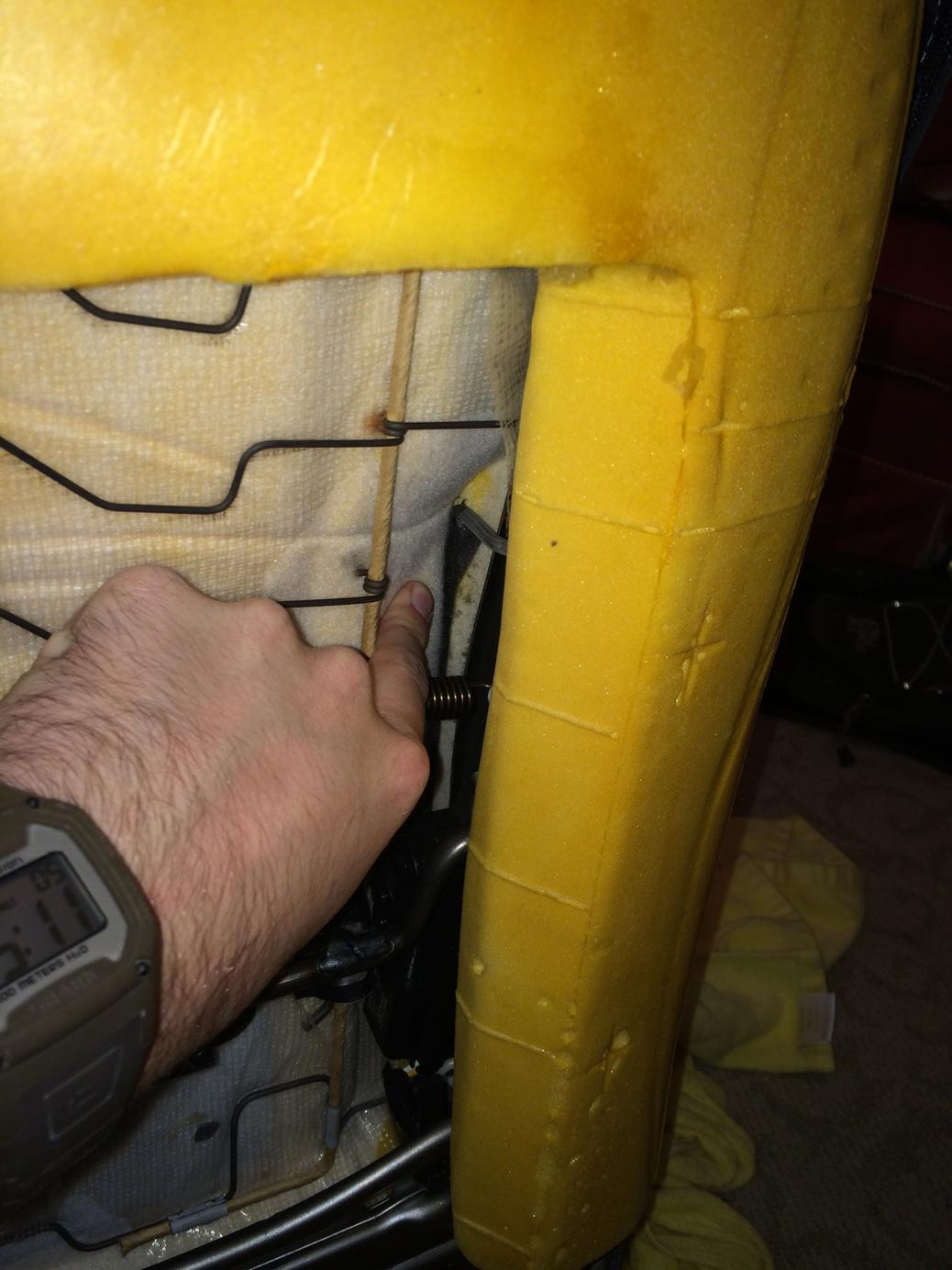

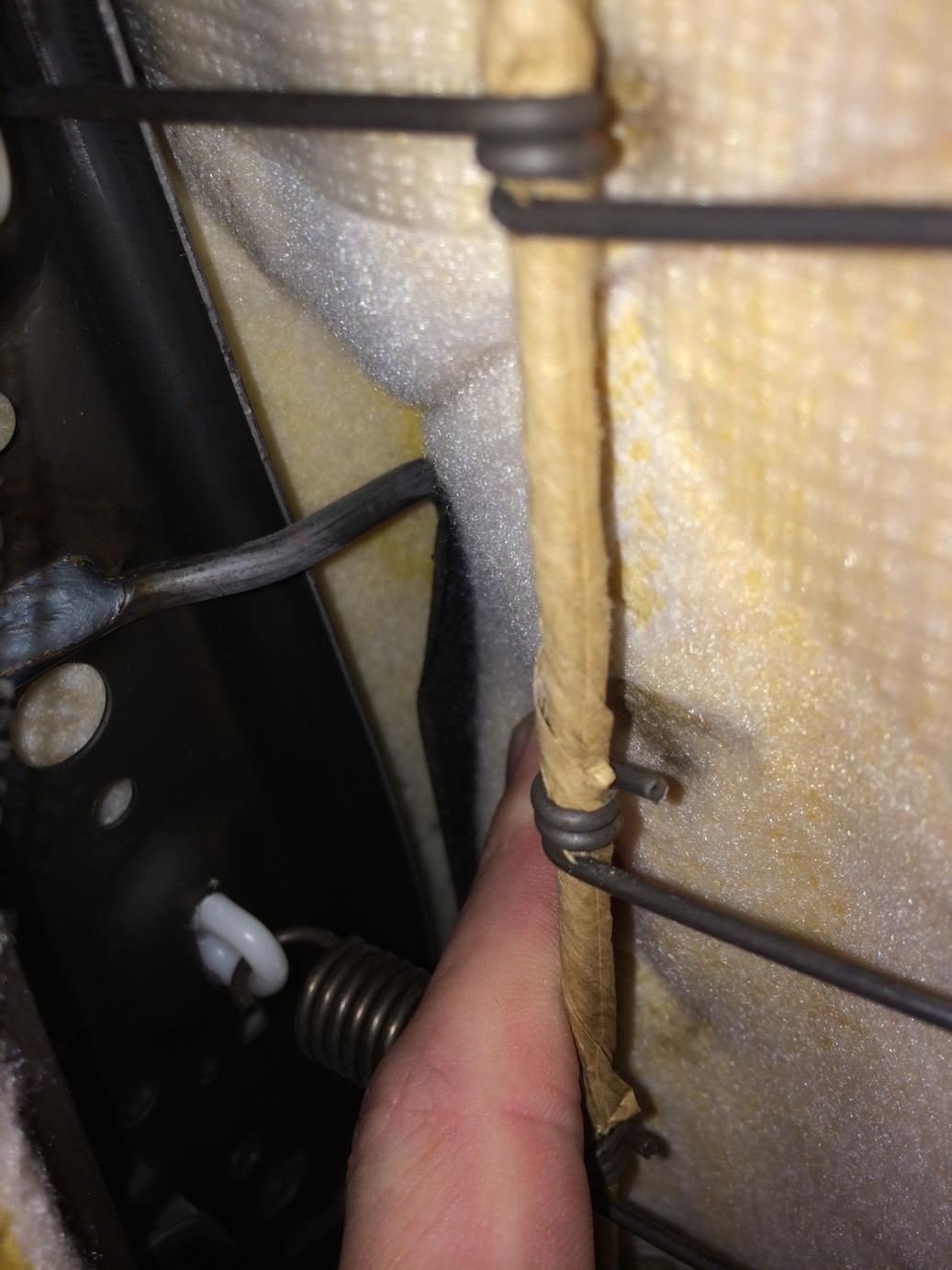

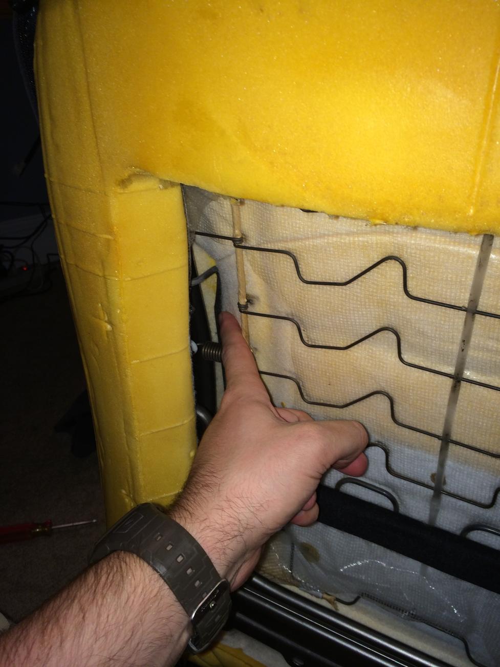

I installed seat heaters in 04 sport last weekend so I decided to tackle the squeaky problem and so far so good. I ended up going to the craft store and got a sheet of felt with adhesive backing and using it to wrap around the supports on the left and right side in the pics below. These supports were already wrapped with something. Looked like black tape. This was the only place that the squeaking was coming from for me but it might not be the same for you guys. Any way I hope this helps someone else.
