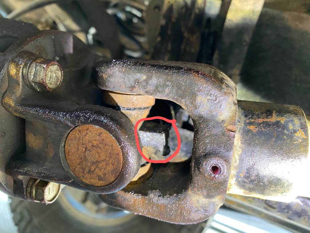

I've greased my double cardan joint a few times now. Zerks are right there in your face. My rear u-joint (OEM) I can't seem to slip the coupler onto due to the location of the zerk fitting. I can post pictures later.
As you can see, the zerk is facing in. It cannot be rotated or seemingly removed as I've tried. IMG_5269~2.jpg

Looks like you have a zerk missing on driveshaft in the photo you just shared. :)
Sent from my SM-A536V using Tapatalk
I do indeed. I removed it, not really sure why. Maybe I was testing to see if it could be removed. I put it back in though, lol.
