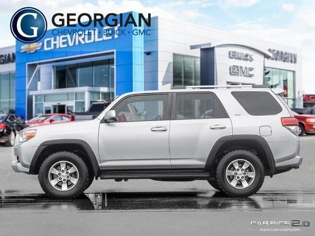

I just bought the 2011 SR5 Premium, I have already 285/70s from my old FJ, so it should fit? 285/70s on stock SR5 17s with no lift? My lift should be here in two weeks.
Thanks
