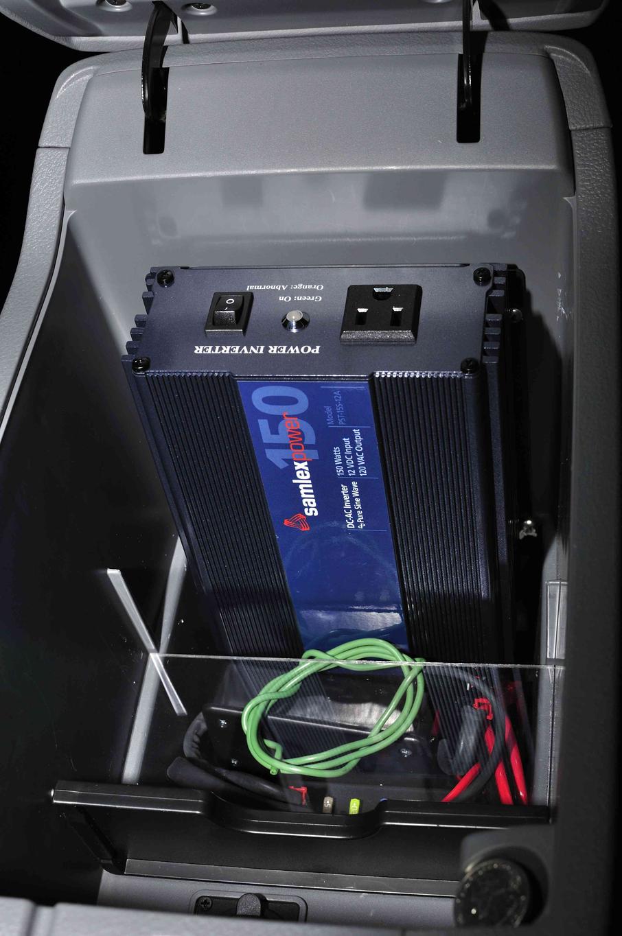

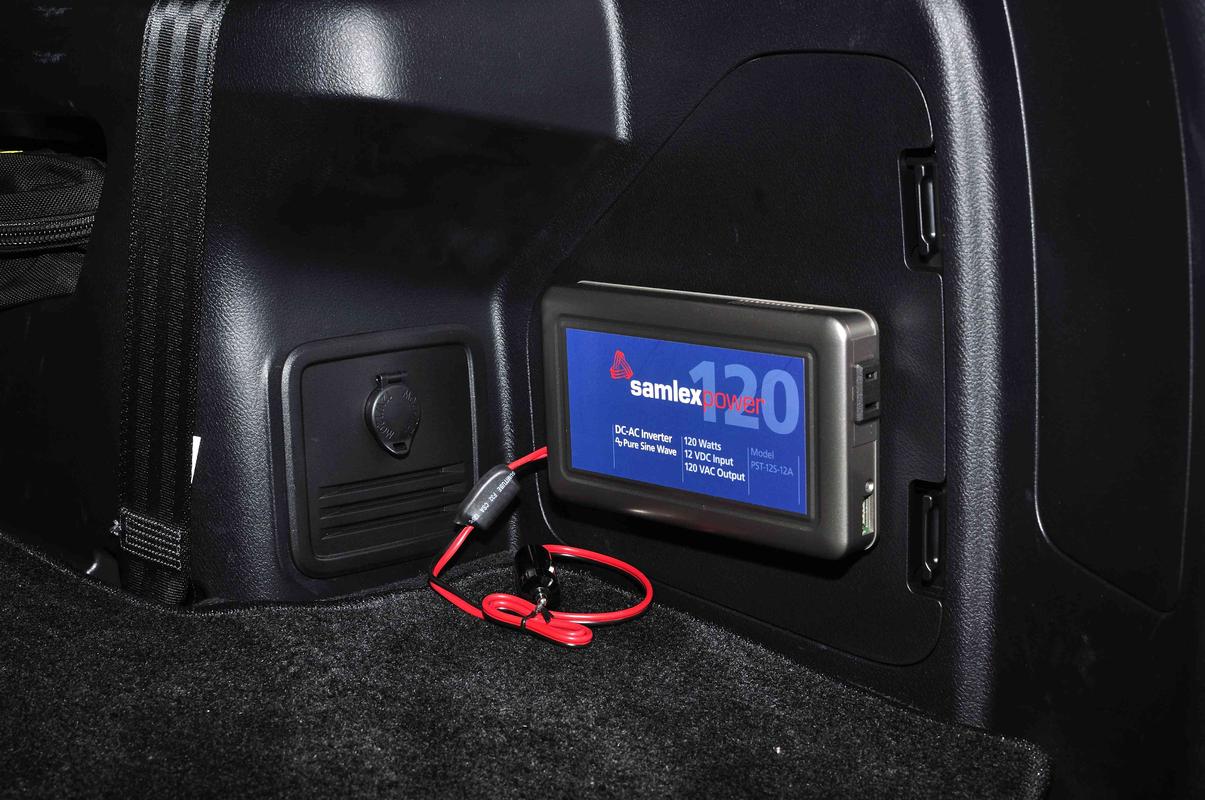

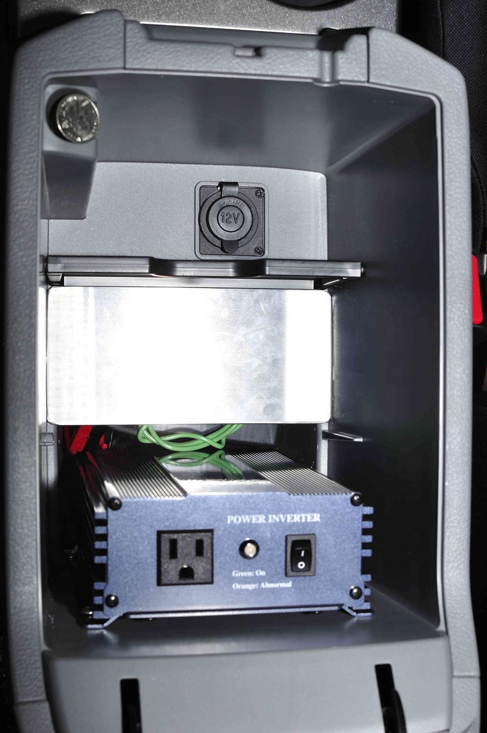

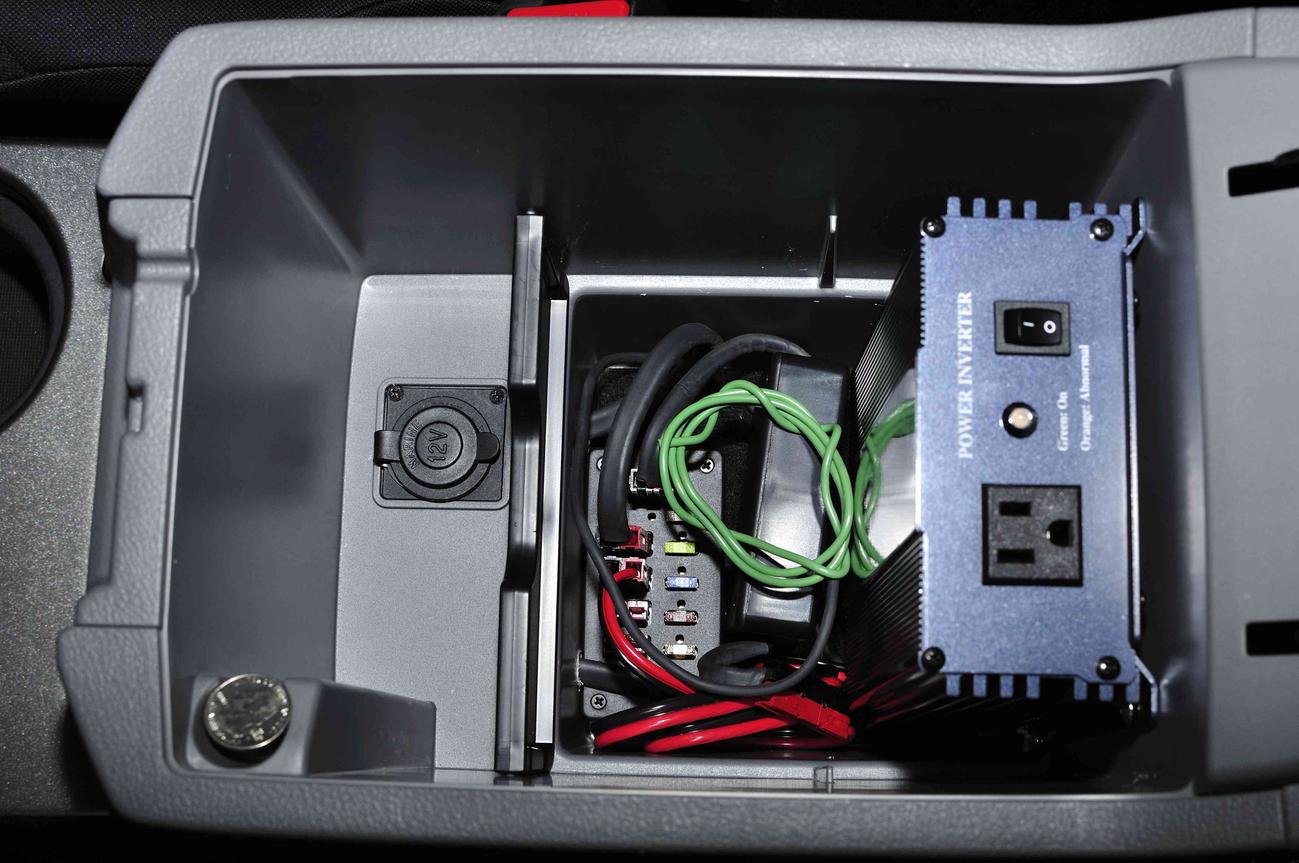

Anyway here is what i am working on for my console. I added two pure sine wave inverters and a extra 12VDC cig socket. I need the other divider to finish off the small shelf for the console. currently i have made up a lexan shelf and an aluminum shelf. Not sure which one I am going to use yet. The wiring is still a mess but should soon be cleaned up.
The power for all of this comes from the battery via a 12 gauge zip wire. I ran it to a voltage controlled switch then to a small fuse box. I plan to run my heated seats off of one of the circuits left.
