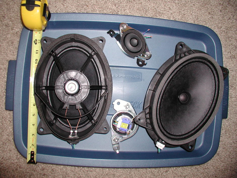

All the speakers looked the same - simple single cone, low profile speakers with almost nonexistent magnets (I will try to upload a couple of pics of the speakers). The front dash speakers did have capacitors to limit the low frequencies, but I don't think they were tied to any kind of paired crossover network with the larger speakers in the front doors. I agree, I think you would want to upgrade to a high-quality component set to get the most from your expenditure.
Interestingly, although I was very worried that the after-market magnets would drain all necessary power to the system, overall volume seemed about the same but overall quality was vastly improved. I half-expected to have to go in right away and finish the job right by adding or replacing other pieces, but I don't think it's needed at this point (hence, my overall very satisfied post).
Pics when I get a chance...
As promised...
