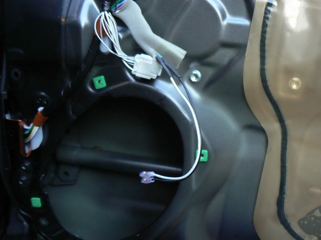

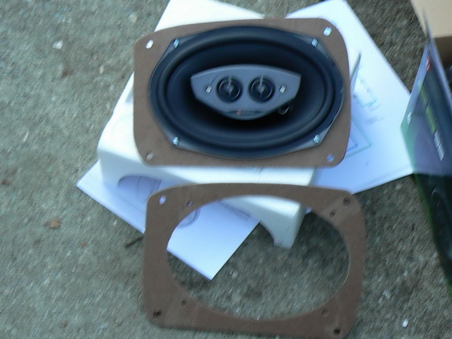

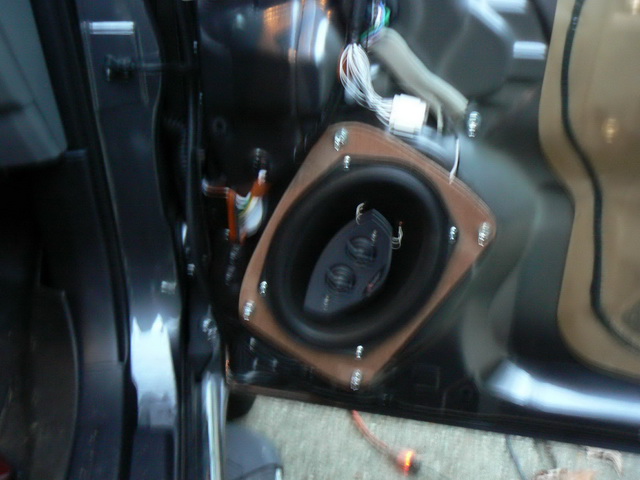

I installed Boston Acoustics SR95 6x9's last weekend. I made some brackets out of 1/4" MDF. I had to trim a very small piece of sheet metal to clear one of the bolts, but other than that they fit perfectly. I too was amazed how cheap the stock speakers were. I have BA replacements for all the other ones ready to install, will get to those shortly. Here are a few pics, sorry about the quality, it was getting dark.

I know the front door speakers require a custom bracket, but can you please tell me if the dash/rear door/lift gate all require custom brackets also?
mine 2012 has speakers in rear doors.
They all do.
