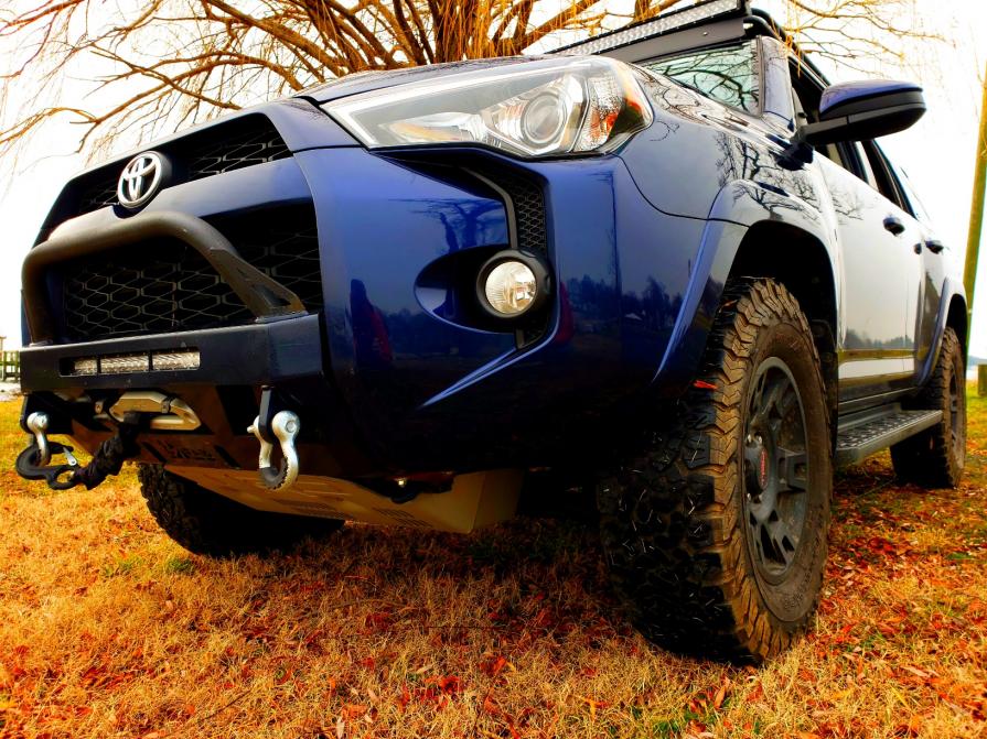

I did a direct swap before I even took delivery of mine. No issues
The bolt pattern is the exact same, and the center bore is the exact same. It is a direct swap, and you can use the OEM lug nuts as well.
