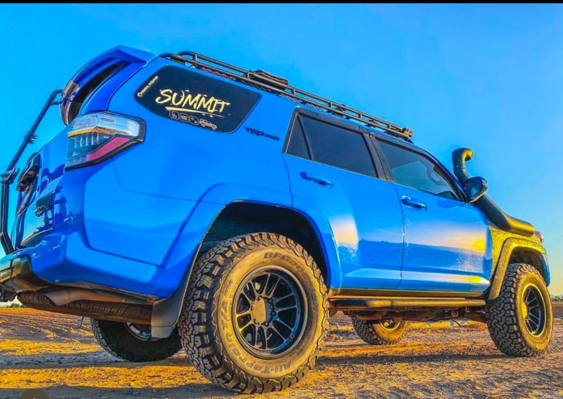

I have a set of raptors coming in and need to buy the lugs but can’t find a good set of black ones. Also confused about ET lugs, do I need them? If so, any recommendations on black ones?
Also any particular valve step I should get? I don’t air down much but I’ve seen some cool sets, if anything I want to make sure they are black and not rubber!
Last, are there locking lugs? I’m on the factory set now so it would be nice to have a lock on the wheels again. Thanks!

I wouldn't get black as it's just paint and it will eventually scratch and rust. ET lugs will not work with those wheels. You need "tuner" lugs which are the thinner lugs that use a key. I would just pick up a set from Discount Tire.
As for valve stems you will need to just use the OEM TPMS as they have the sensors in them.

You can't use OEM lugs on those wheels. They need to be the skinny conical tuner lugs. I have the exact same wheels. Black chrome would last, but you would need to find high quality black chrome tuner style lugs
