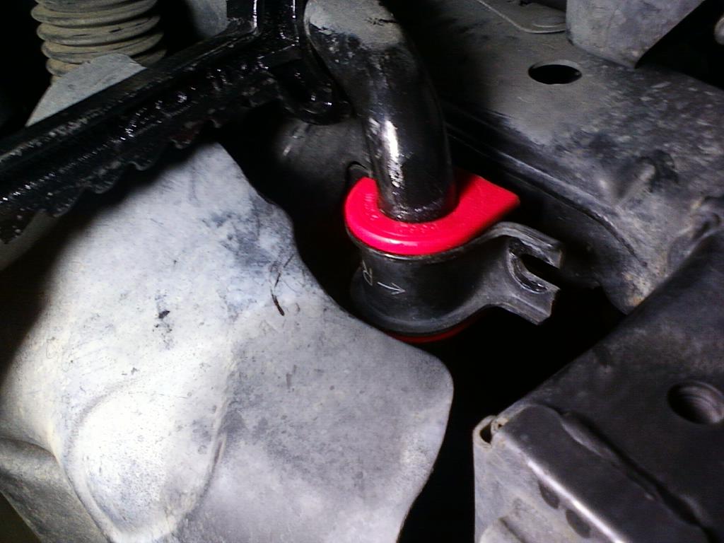

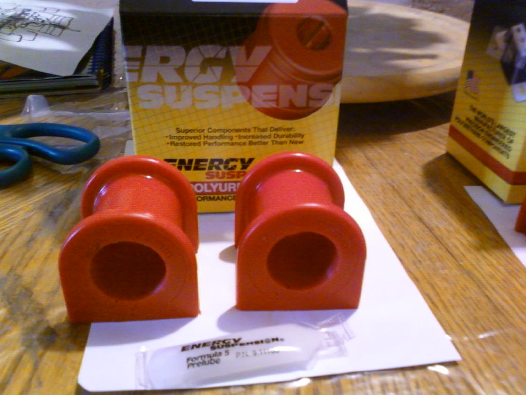

i did the front bushings not too long ago. here are the ones i bought. i will say this, if you do get the front ones, it will be so much easier to remove the sway bar if you take a 10mm + 12mm socket and remove that front skid plate. it will give you a direct shot at the bolts on the sway bar. that extra 5 minutes will save you 30 minutes and some busted fingers.

Are these split so you can just pop them right over the bar? Also, it appears these are the non-greaseable bushings, any reason you chose one over the other?
yes, they are split. they slip on pretty easy. i got those becuase i was not able to find the greasers. the ones i put on the back swaybar are however greasers.
