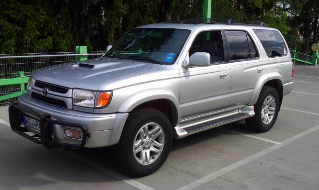

as I said in "Welcome" section, I'm from Poland, so T4R 3rd Gen. is quite rare view on our streets. Why I choose her? Mostly, because of this forum :wave: I knew that it will be very hard to get decent 4Runner here, so I have decided to search in US military bases in Germany. And that was a great idea, because I found her:
She is 2001 SR5 Sport with around 148 thousand miles on the clock. Bought in Europe by the first owner (also military) then sold to the second owner and finally when he had to move back to States, bought by me.
Now, I had some second thoughts because in Poland you need to adapt US Specs car to the polish regulations to be able to register the car. But with some help from my friend who is a mechanic I finally managed all the changes and she get polish plates.
So, she is almost pure stock because of this "bumper" but for the moment I will leave it on the car. In the future I'm planning to change front bumper so it will be gone.
Plans, plans... well here is not so easy to get some aftermarket parts for T4R 3rd Gen. So I will have to use some of my US friends in Europe and order wanted parts over the APO. It will be much cheaper and easier for me.
So what I want to change? For sure lift - about 2-2,5 inch, then front bumper, wheels, tires and winch. those are the "big" things.
Smaller thing would be: radio - get rid of stock 2DIN and change it for 1DIN and small shelf under, colour of the internal lights and put some soundproof mats.

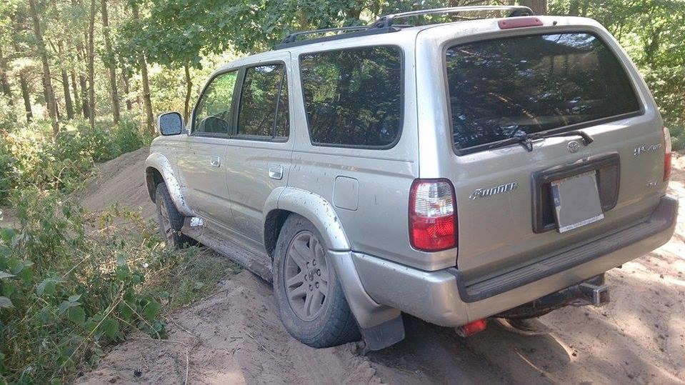

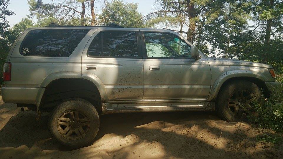

I had some free time so I went onto military training grounds. I stuck two times, but I managed to get out with help of wooden logs. :pray:
Some action photos:
