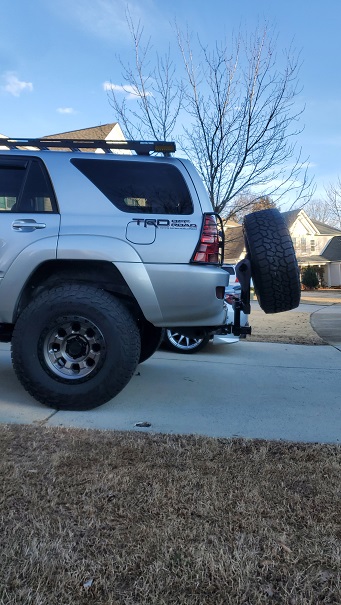

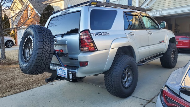

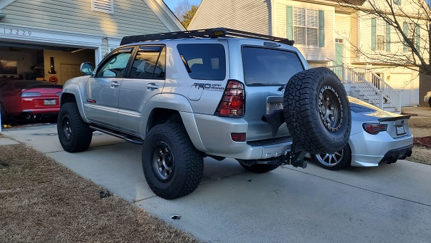

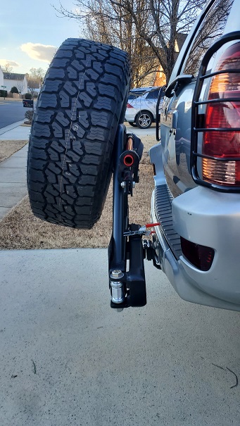

Very pleased with how everything came out in the end with the swing out. The heim pivot worked like a dream, I wish I had done this from the first time around, but live and learn I guess. There is practically no sag at all with the latch released and it pivots smooth as butter without needing lubrication.
I am still going to do a small drop of a bike-chain type dry lube just to help out a bit but overall it is working great. Plus now the entire pivot assembly is sitting on 3/16" angles instead of a 1/4" flat plate that wanted to deform under weight with it swung out.
I took the time to hand the hi-lift jack a bit higher so that it wasn't in the way of the latch as well. And finally, I placed a secondary locking drop-pin just to ensure the assembly doesn't swing out while driving in the very unlikely situation of the latch failing in the closed position.
Since I cut it all up again and had to paint it I decided to use the same bed liner paint that i used on the sliders and I couldn't be happier. Looks much nicer now. The license plate covers the not-so-pretty modification to receive the heim pivot so overall I stoked with how it came out.
A question came up about departure angle, and yes, obviously you can't have your cake and eat it too if you're looking for a bolt-on swing out carrier and not a full bumper. I could gain a bit more clearance if I chop off 4-5 inches of the receiver tube on the swing out, but I want it for the ability to hook up a small trailer while still having the swing out on. Sooner or later I'll be going with the coastal offroad swing out bumper so that won't be an issue for long :)
