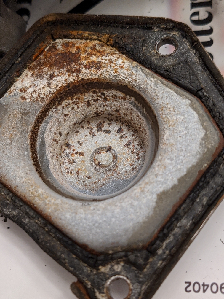

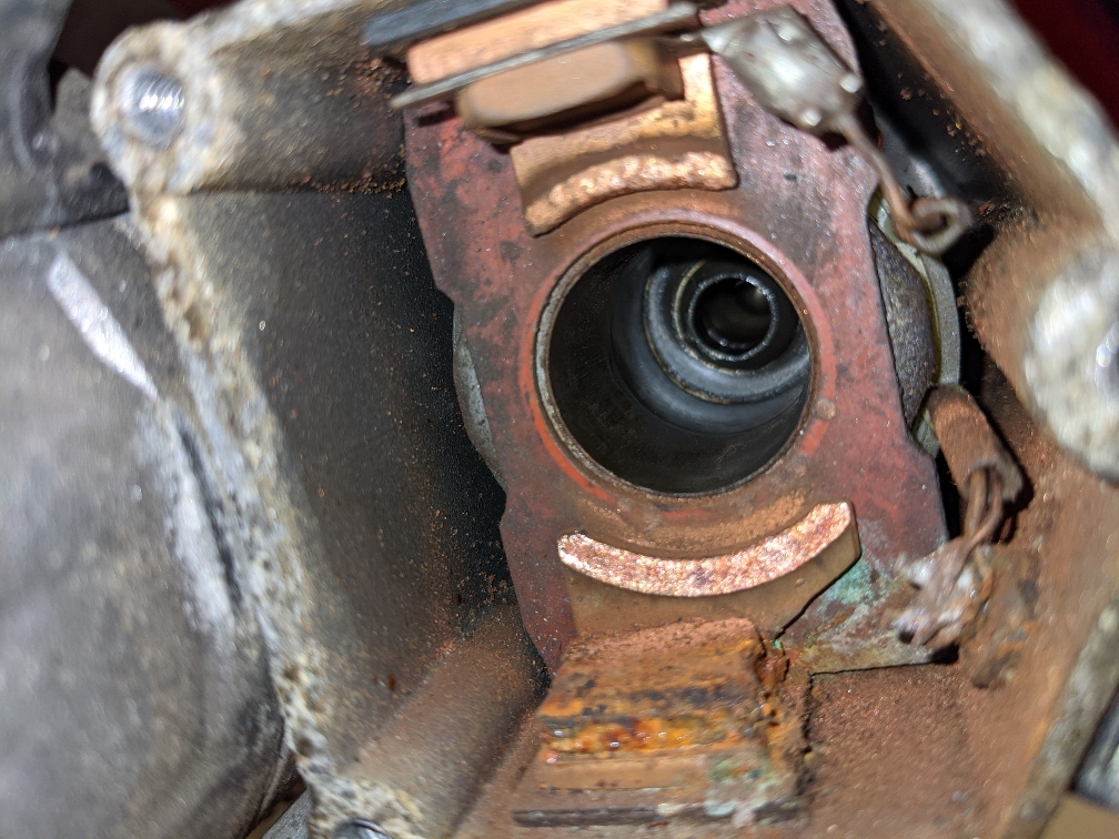

Starter contacts, plunger and a new relay didn't fix my problem. I performed a bench test and my starter wouldn't turn over. I just got sparks. Once I decided to replace it, I ended up cracking my starter open and it's filled with oil / gunk from what I imagine is leaking previously from the valve cover gasket. Picking up a used unit I found locally on Car-Part.com--Used Auto Parts Market

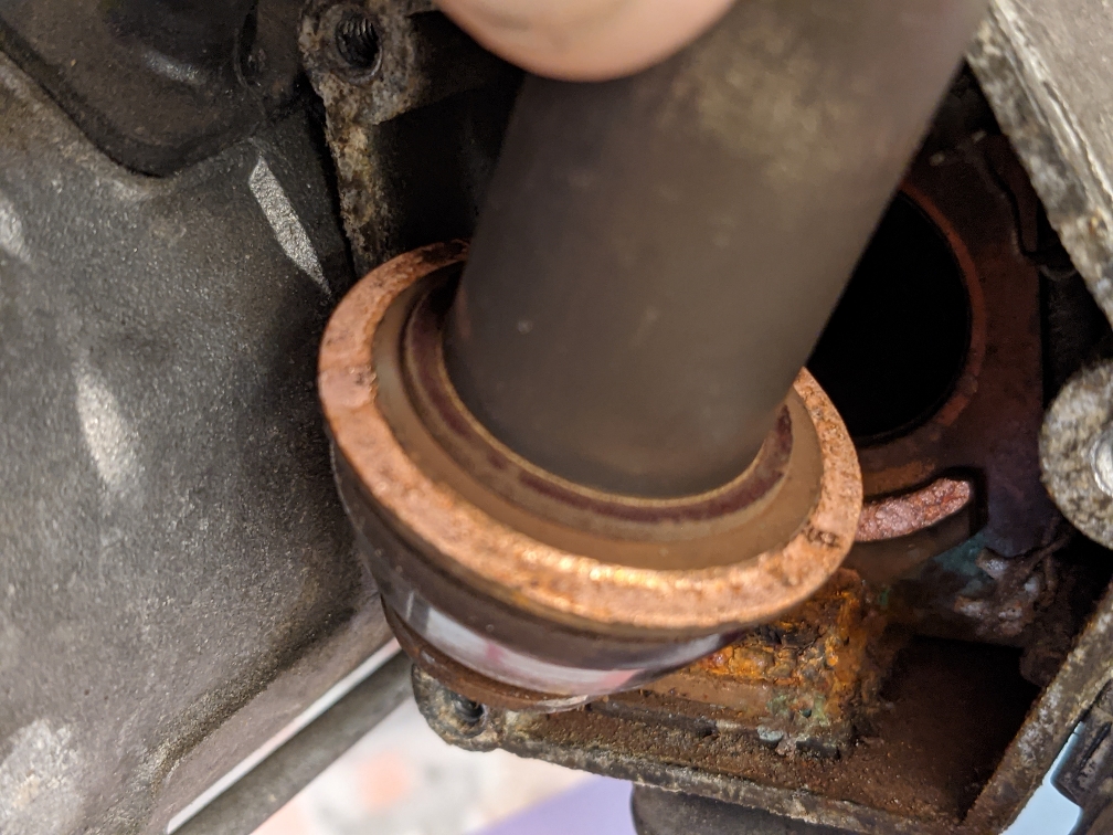

Well my contacts were worn but weren't that bad, the plunger was worse, but even worse was the failed gasket on the port door.
I ended up replacing the entire starter with the correct DB Electrical 1.8kw starter off Amazon
