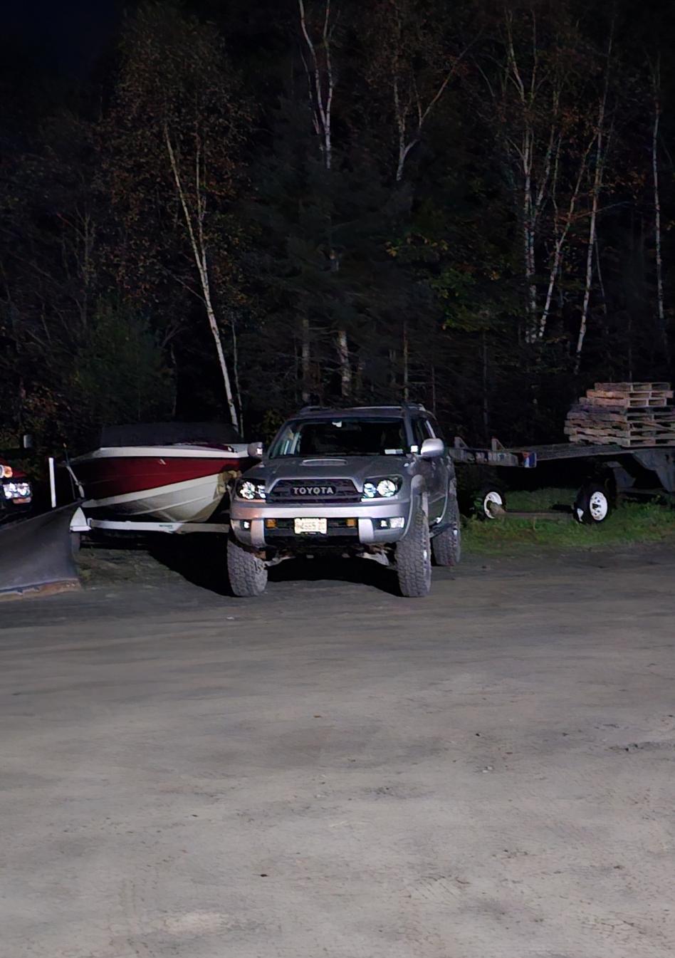

Well after 13 years of flawless reliability, the starter died today while out running errands. 170k.
What are some things that might as well get replaced at the same time as changing out the starter since it's pretty well buried in the engine?
