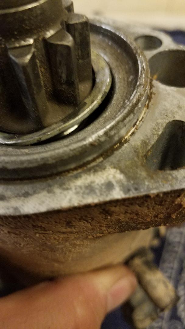

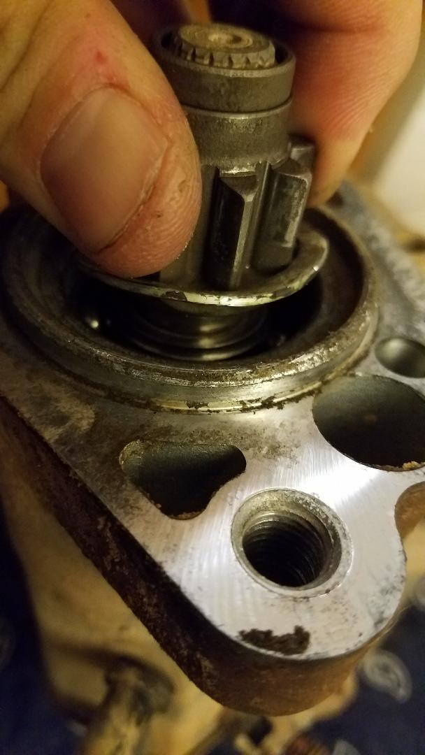

Hello. I will get right to it. I pulled out my starter with the intention of replacing the contacts and plunger thingy. After removal, the piece that goes into the flywheel/trans(?) is loose, has bent washer(?) and visible bearings inside housing. Let me know if more photos are necessary.
I have basic, basic repair knowledge and would like to know if the parts I purchased should be returned and go to AutoZone and purchase a brand new starter.
She just rolled 230k miles on Tuesday and starter went kaput today, Saturday. I figured this was my first option, repair. Hopefully I am not f***ed with buying a new one.

Good idea! Getting mine out was a great accomplishment, has reservations doing the job. Upon inspection the spindle deal had loose/bent washer holding bearings in. Tension was still there but looks like damage to that other than just replacing contacts and plunger thingy. Thanks for reply.
Bought a new starter, old one with 230k miles was shot
Got a good look how starters work and what is involved. Returning contacts and plunger, and bought a new one. My 4Runner is my daily so the need to get running was needed quickly. Thank you for the replies. Peace, ✌
