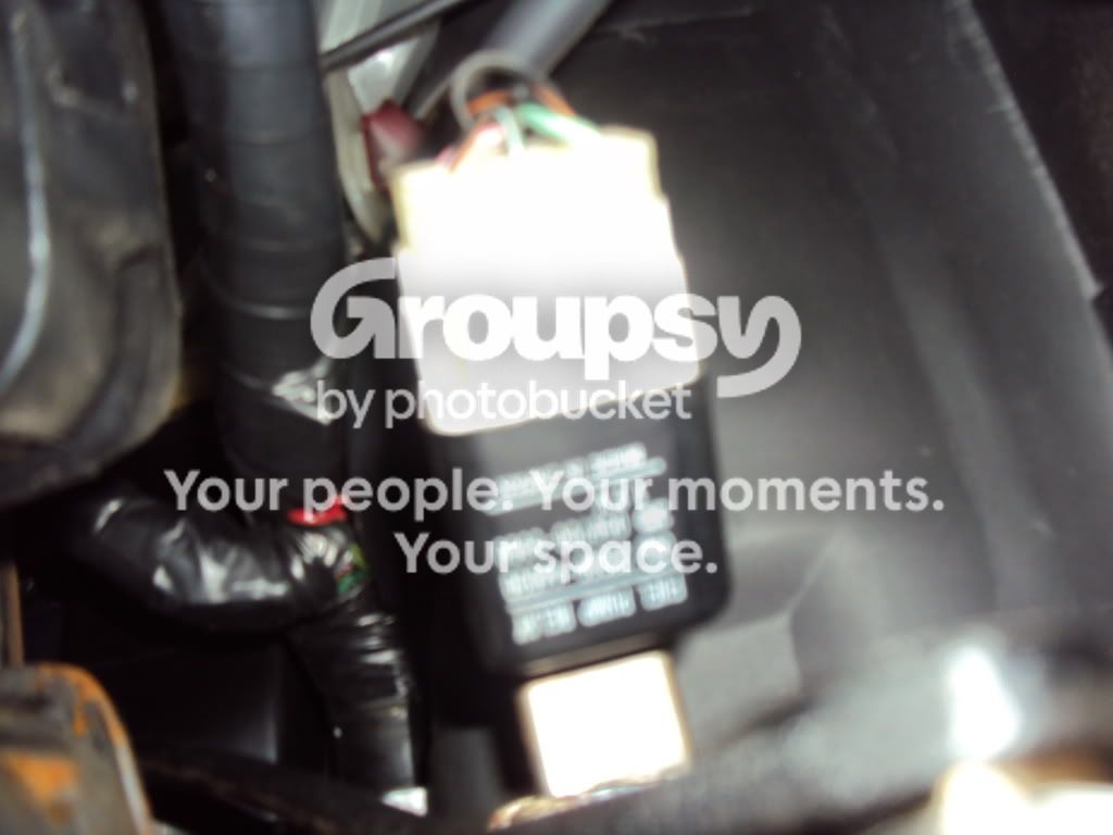

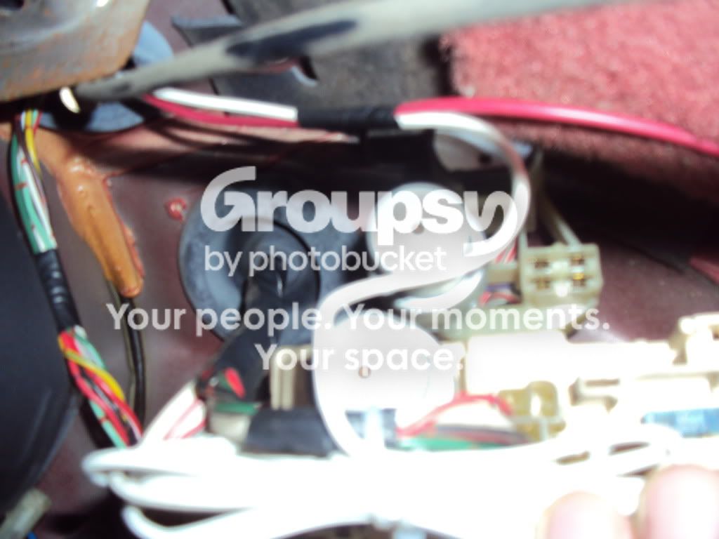

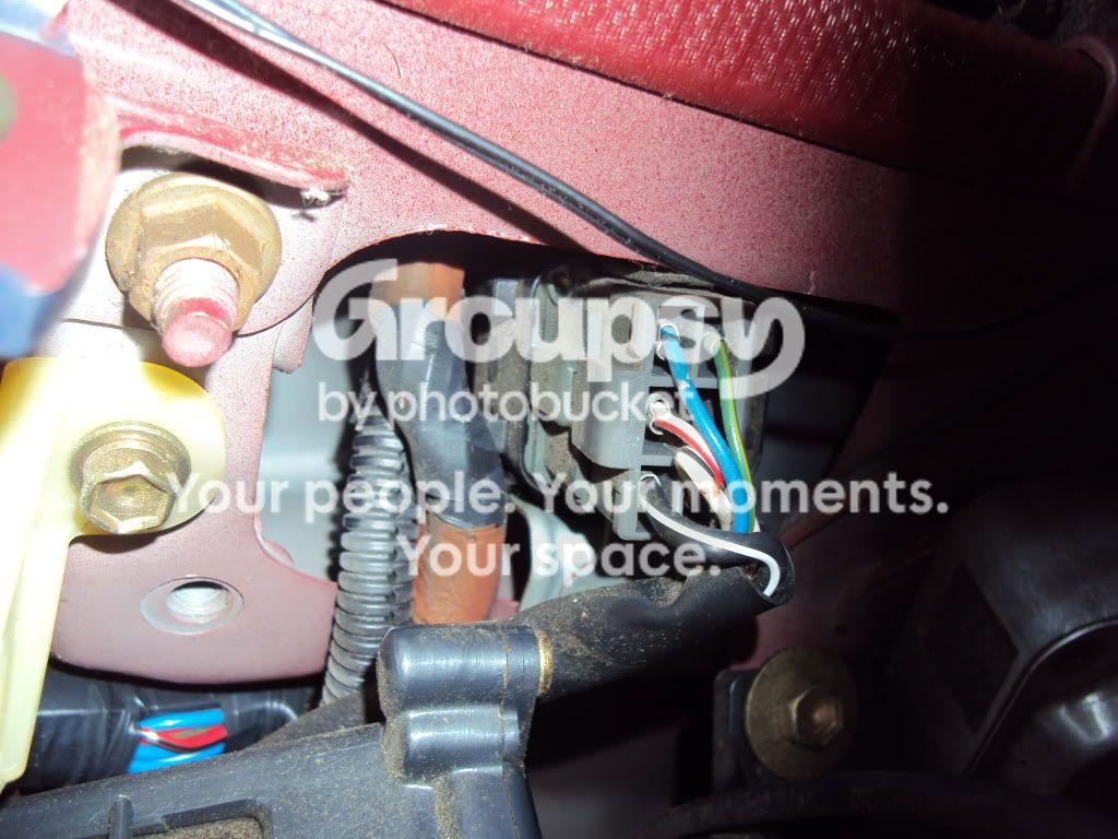

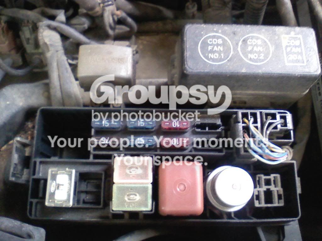

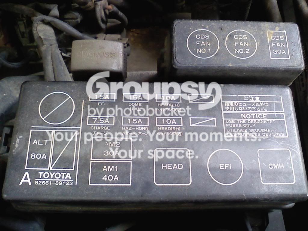

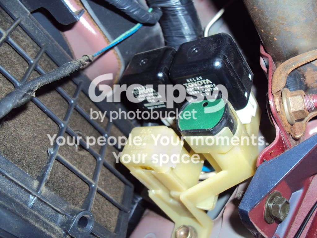

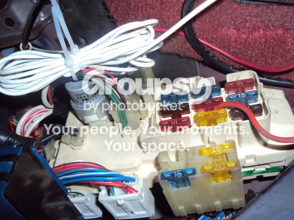

Ran home on my lunch break to snap a few pictures of the different fuse locations, none of which contain the starter relay. . .
Drivers kick panel
DSC01101.jpg~original
DSC01106.jpg~original
Under the dash/above the steering column (fuel pump relay)
DSC01107.jpg~original
Pass. side behind the glove box
DSC01102.jpg~original
This is a "main circuit relay" below the fuses on the pass side
DSC01104.jpg~original
i keep pressing the relay issue because for weeks it would give me a click and after a few tries would crank right up. It now rarely turns over and i just hear the click. I have had starters die on me in the past with other cars but they usually die die. Not blink in and out for weeks like this one has been.

Nope, never did find that da** relay:shrug:
